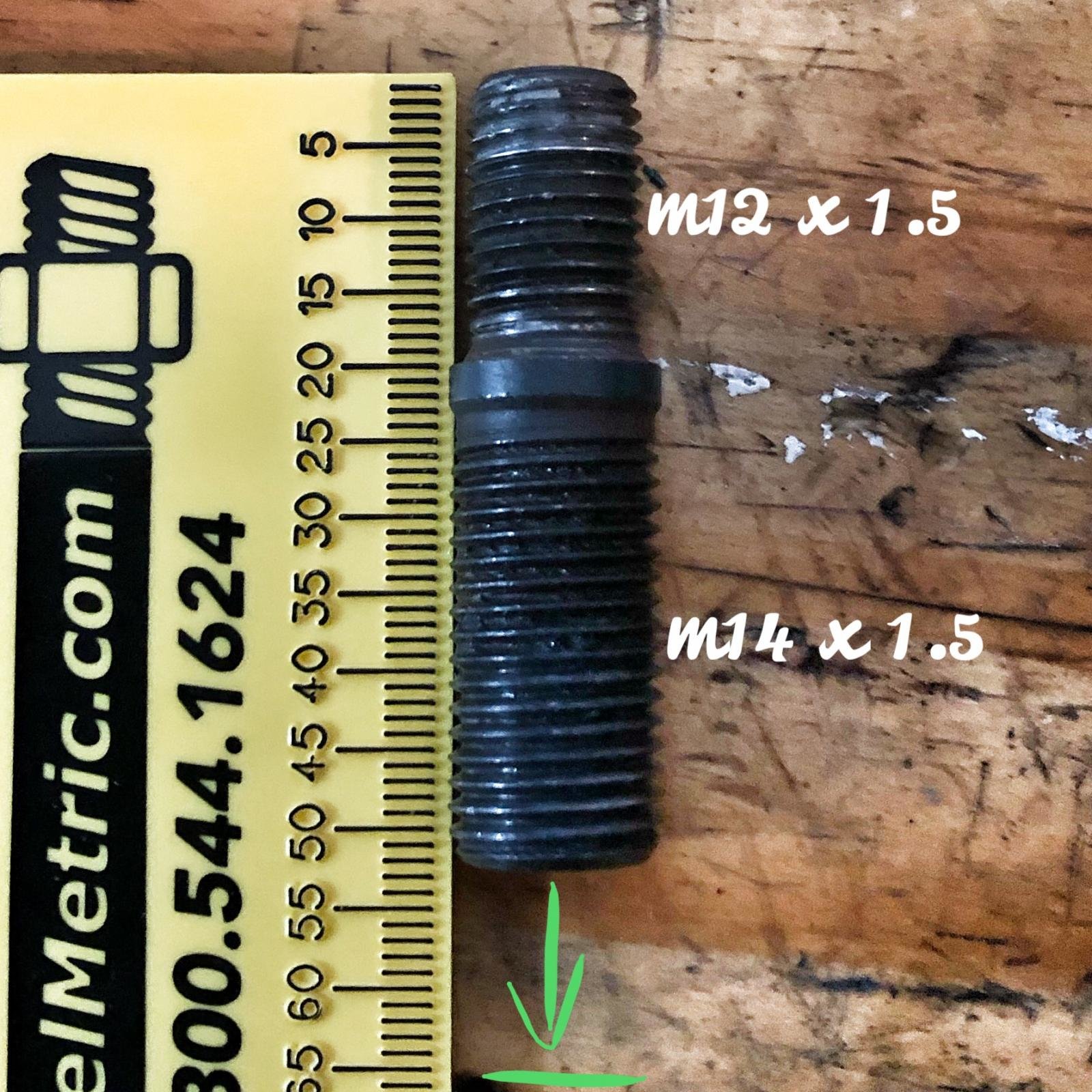

    Also, from my limited research:
    22+ Tundra Hub Bore is 95mm vs GX at 106 mm
    Lug nuts are M14x1.5 vs M12x1.5
    The GX is hub centric, so I would ASSUME if you didn’t want to run spacers you could get the wheels center bore milled to 106mm and they should be fine. But I’m NOT a wheel and tire fitment expert. Lol

    A dude on FB said stud size is wrong too but I haven't had a chance to confirm. Still driving.

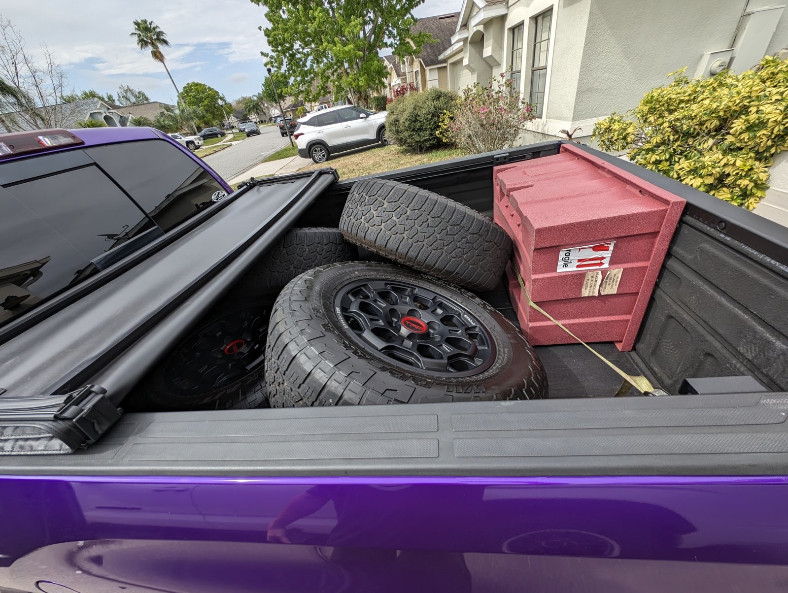

    Just got a second set of TRD Pro wheels. ‍♂️

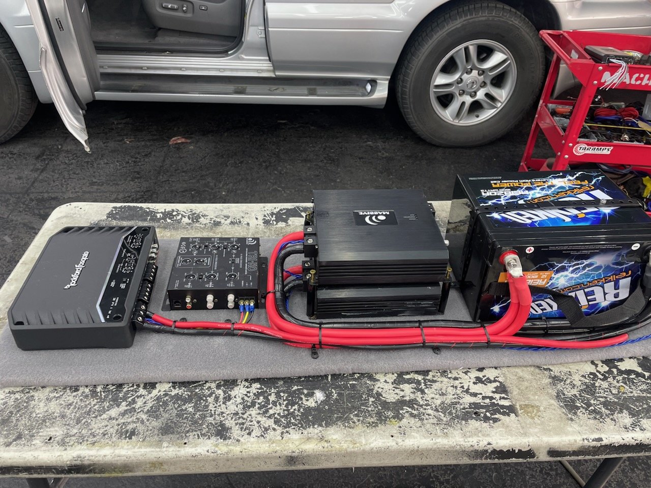

    There's 3 amps there. I believe a 4th will be added after talking to my installer/best friend.

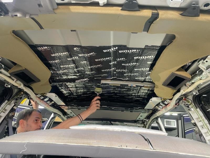

    Sound deadener finally going in. My installer was surprised with how little sound deadening came in this thing stock. 2 layers going up top;

    What will that be making when complete?? One can only imagine just by looking at the size of the cables!!:) WOW!!!

    What do you mean by making? Those are just the short runs from the lithium battery to the amps. The main cabling from the battery and alternator are even bigger.

    Amps/ watts

    I'm not sure. The stacked amps are 3k rms each for the subs. Not sure the specs of the Rockford on the left. And I believe ultimately there will be a 4th for the rear.
