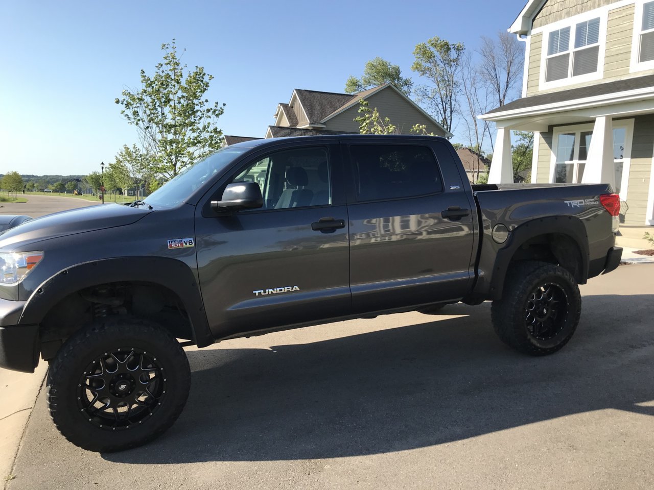

    2012 Tundra TRD
    6 inch suspension lift, rhino lined underbody and fender flares. Charcoal grey paint.
    Hello all, long time lurker but I could use some help from people more technical then myself. I bought my truck with a pro comp 6” suspension lift already installed. During my last service at the dealership they said one of my rear shocks was leaking. So I am planning on replacing all the shocks as I have recently hit 100k miles and feel like that would be a good idea. I roll on 325/60r/20s and have coilover shocks on the front. I have been talking to the gents at 4wheelparts but they are kind of honed in on the fact that I’m not very knowledgable and I feel like possibly taking advantage of that... I guess I am looking for advice on what shocks would be best for my truck? It’s mostly just a daily driver but I do like to head off-road when I get the urge to sling some mud. Any help/suggestions/ advice would be greatly appreciated. I’m looking for best ride/performance for what I use it for and something reliable, not just the cheapest. Appreciate any thoughts.
