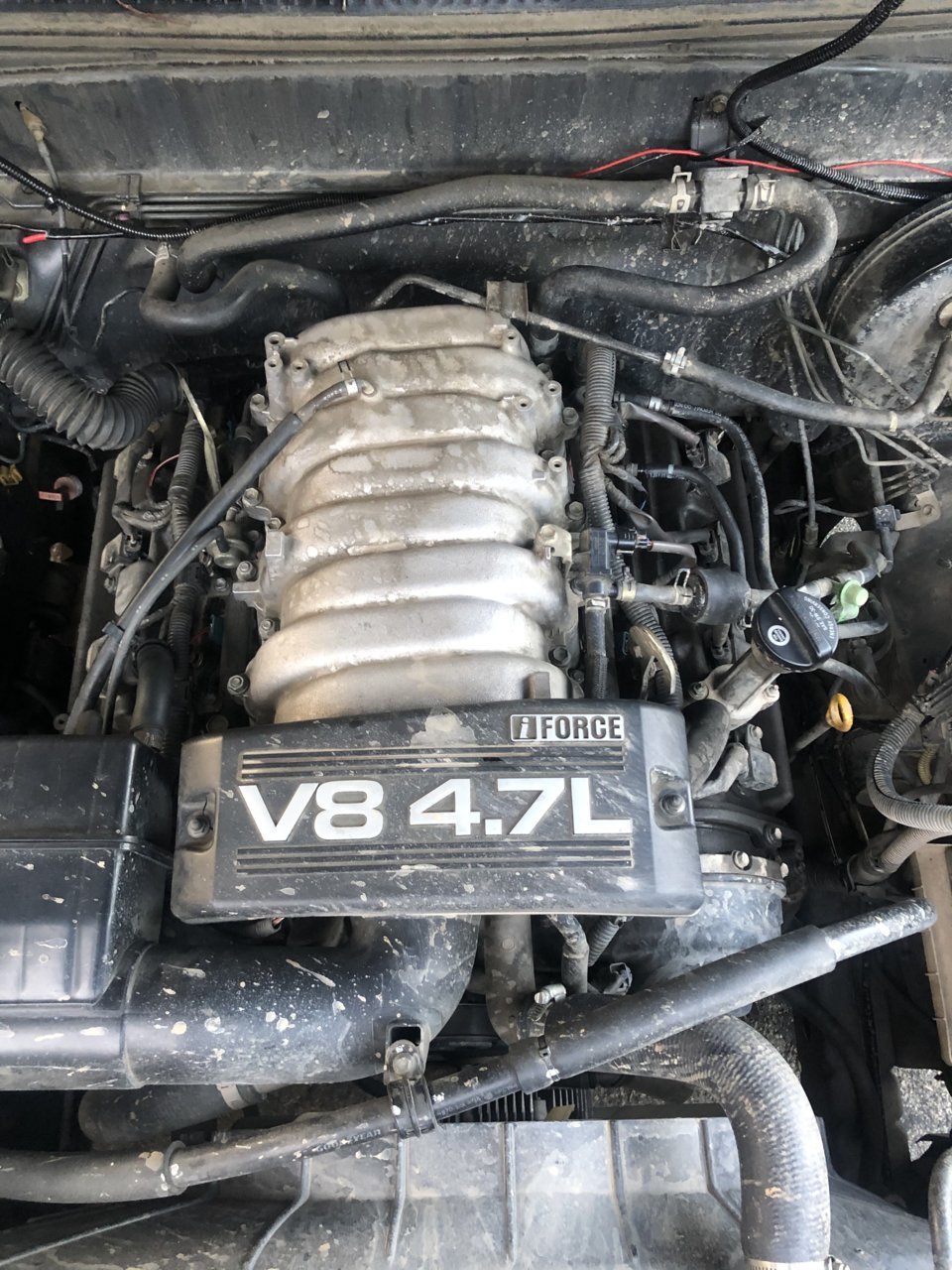

    Oh, I see now. You're only doing one fuel rail at a time? My 5VZ-FE had both fuel rails exposed once I had the plenum (Intake manifold) off. I did both sides at once. I'll go get my phone, and upload pictures.
  7. Mar 19, 2021 at 11:19 PM
    #37
    Voss
    Voss [OP] Dust in the wind
    Feb 28, 2019
    #26833
    1,544
    Valod
    2003 AC TRD 4x4
    If I knew what a plenum was... yeah man Post it cause I feel people need more info on fuel injectors. I changed my entire suspension via YouTube and you all and yet fuel injectors are still a mystery

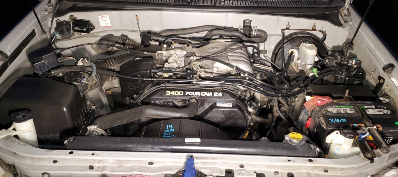

    See above.
    Are you pulling a FGV, and skimming?
    My engine, and your engine are completely different. Here are pictures.
    Unashamed post of hood lights.
    Old "red" injectors still installed.
    New "pink" injectors installed in the back ground.
    At the end of the fuel rail there's a metal "crossover" pipe that connects both fuel rails. I was able to take the bolts out of the fuel rail, and lift it up as a single piece. That's how I changed all 6 of mine at once. It's that tube on the left hand side of 2nd picture up from this line.

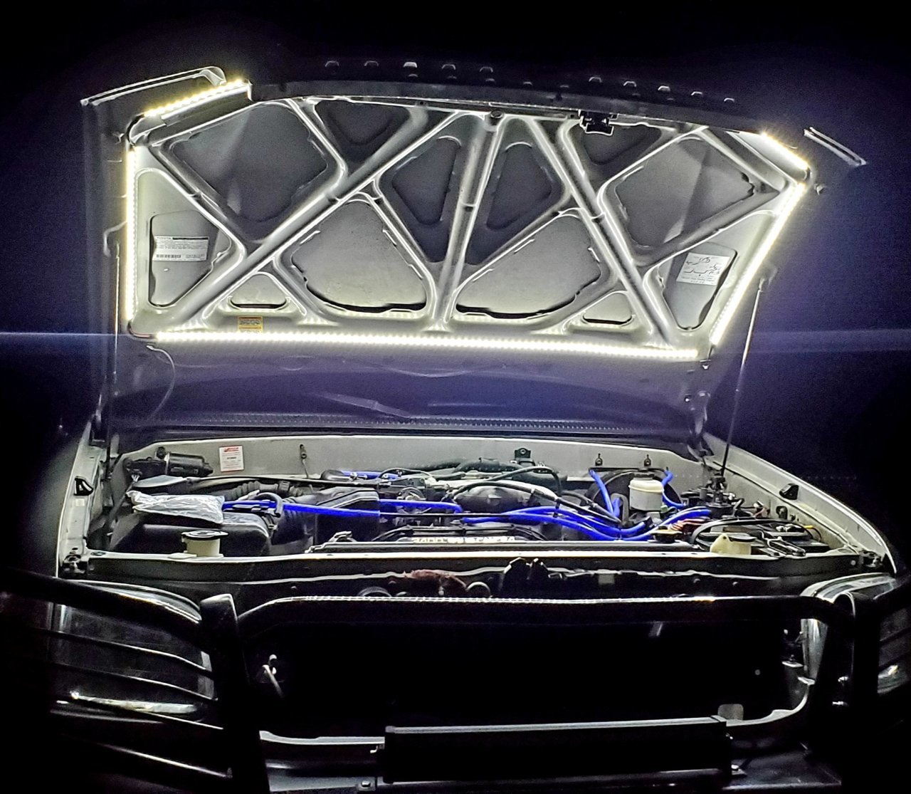

    The injectors job is what made me realize I needed hood lights because look at that. That's midnight in the woods with coyotes howling all over. Lol

    I don’t know what KVG and skimmer are but I sure in hell want to know how your engine looks so cool!! Thought I had it made with my 2 lights but holly molly is your engine lit!

    Dude our engines look nothing alike

  11. Mar 19, 2021 at 11:57 PM
    #41
    Tundra2
    Tundra2 Zoinked
    Feb 10, 2019
    #25875
    12,419
    Noah
    Western Kentucky
    Yes. I said that more than once. The tequila must be in your frontal lobe right now.
    Here's my post on the hood lights.

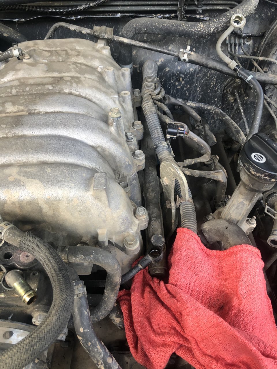

  22. Mar 20, 2021 at 4:35 PM
    #52
    Voss
    Feb 28, 2019
    #26833
    1,544
    Valod
    2003 AC TRD 4x4

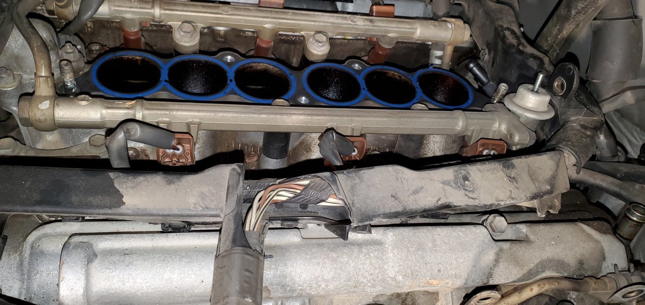

    Finished with chores around the house and finally started on the driver side. Not playing around this time, I took off everything I thought would be in my way and preemptively hammer the engine hook back a bit.
  23. Mar 20, 2021 at 5:01 PM
    #53
    Voss
    Feb 28, 2019
    #26833
    1,544
    Valod
    2003 AC TRD 4x4
    Well there you go. That was simple enough.

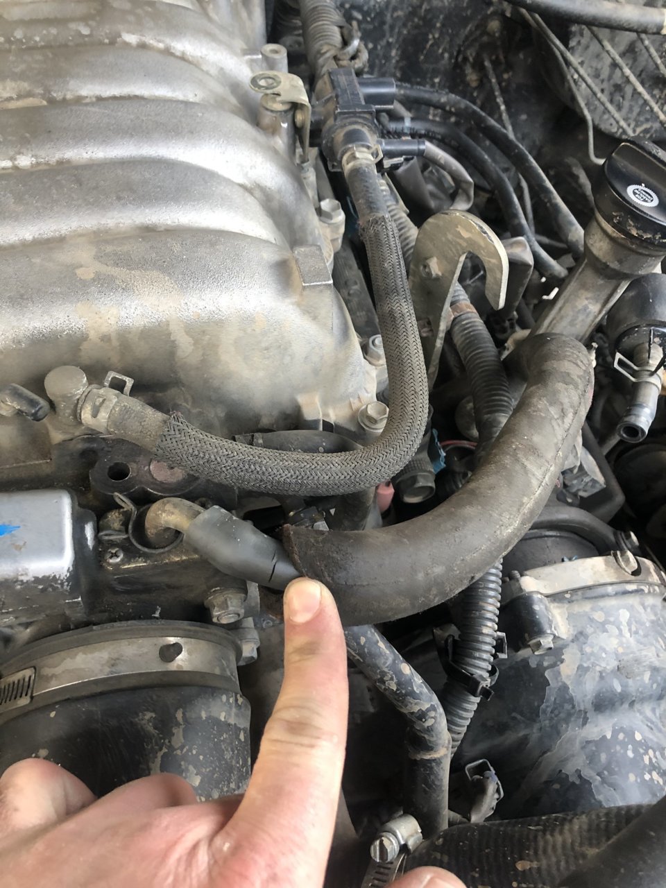

  25. Mar 20, 2021 at 6:36 PM
    #55
    Voss
    Feb 28, 2019
    #26833
    1,544
    Valod
    2003 AC TRD 4x4

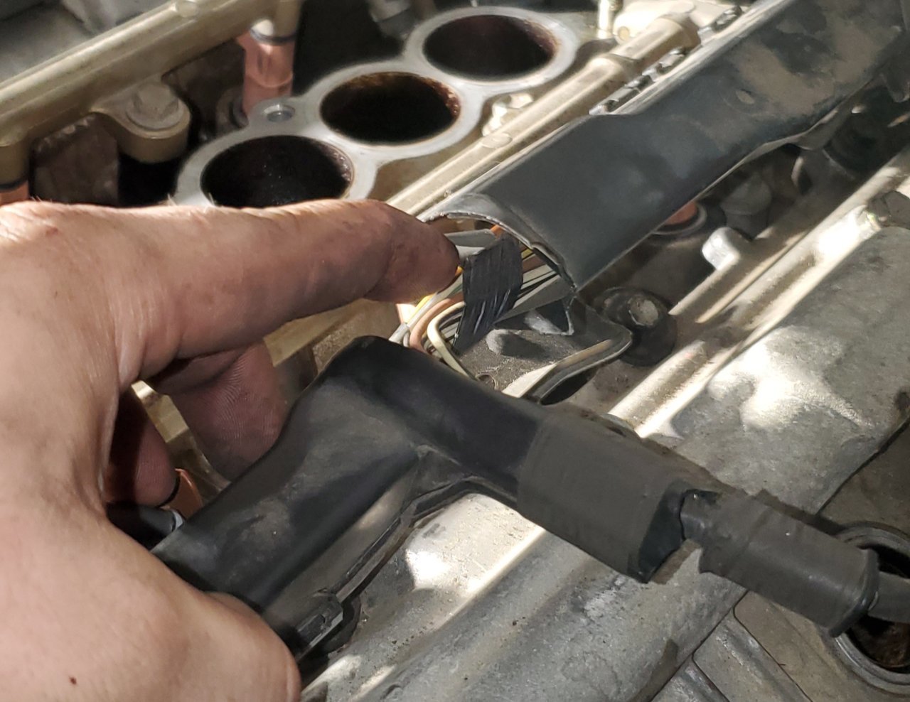

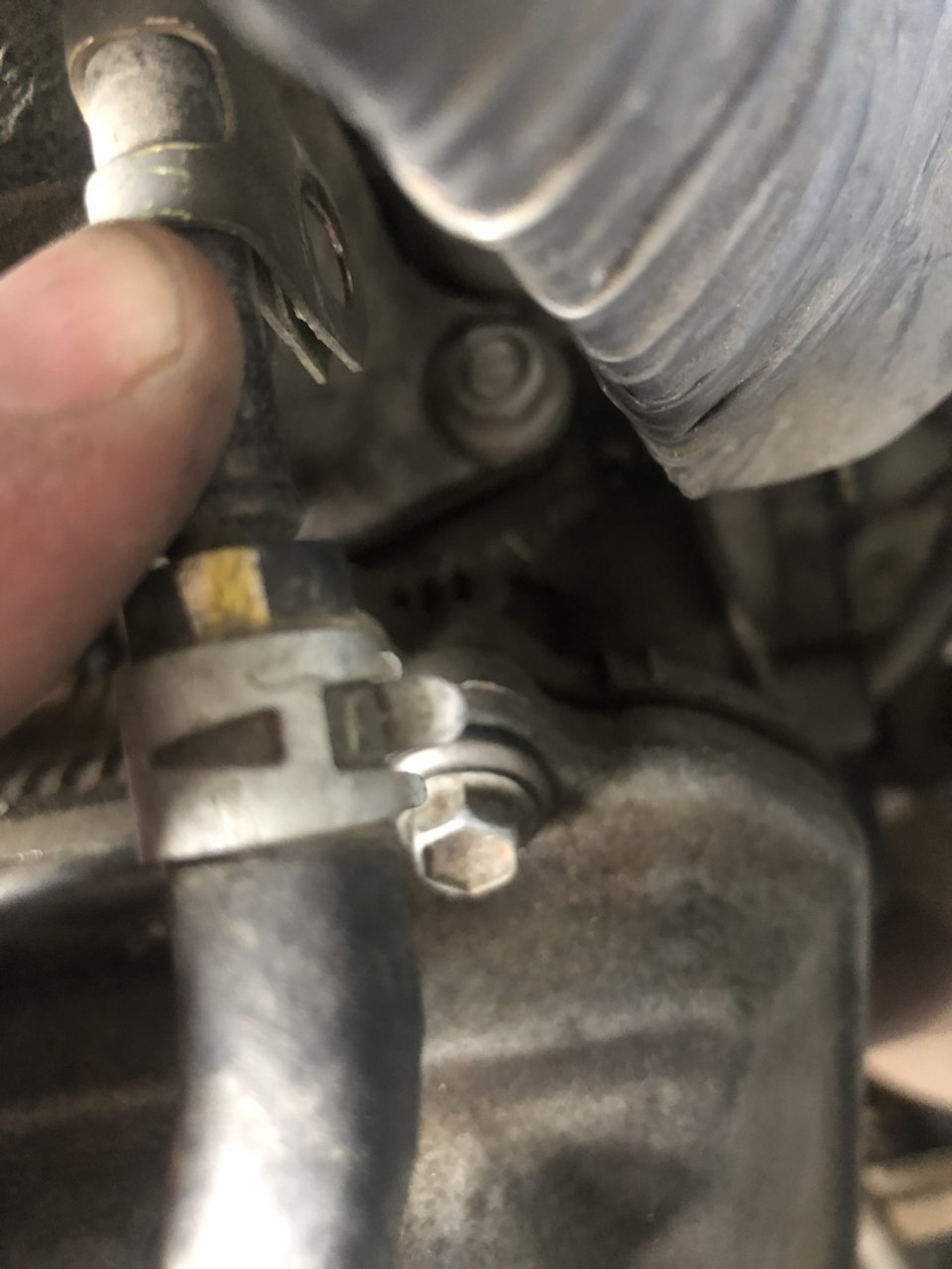

    This hose seems like it needs to be replaced. Anyone know what this hose is for so I know what to ask for?
    I think I should replace the wiring that goes from ignition coils to the fuel injectors... the outer plastic covers fell apart. Not the wire cover but the cover that goes over the wires as a whole.

    My plastic wire loom "box" fell apart too. I spoke with @empty_lord who said it was fine.
    The picture above with my hand in it shows my wiring loom "box."
    Voss[QUOTED][OP] likes this.

  28. Mar 20, 2021 at 7:51 PM
    #58
    NWPirate
    Dec 24, 2019
    #40251
    11,877
    Zach
    WA
    That's the 'ol pcv to throttle body hose.
    It sends all that delicious oil vapor straight to your intake.
