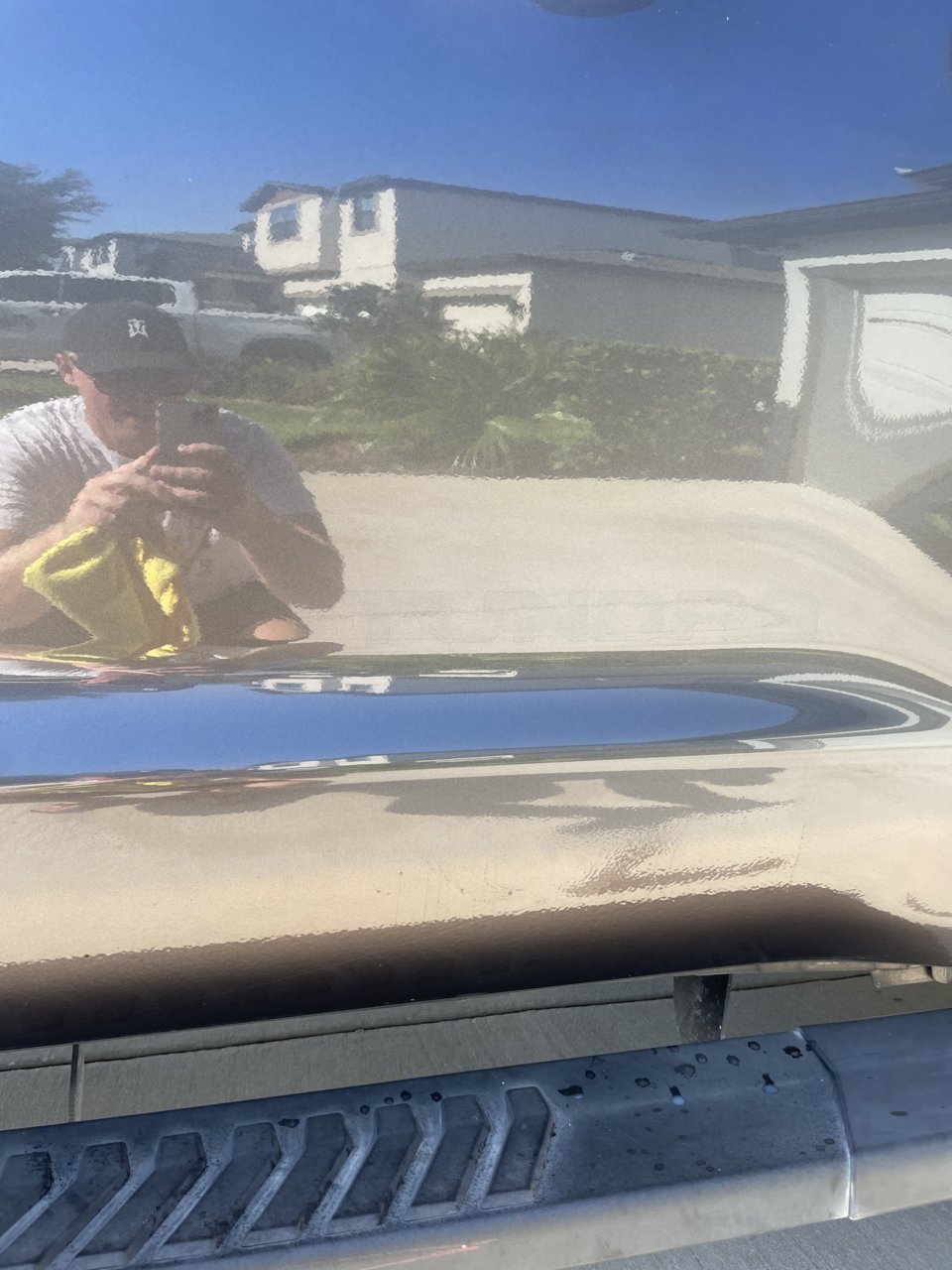

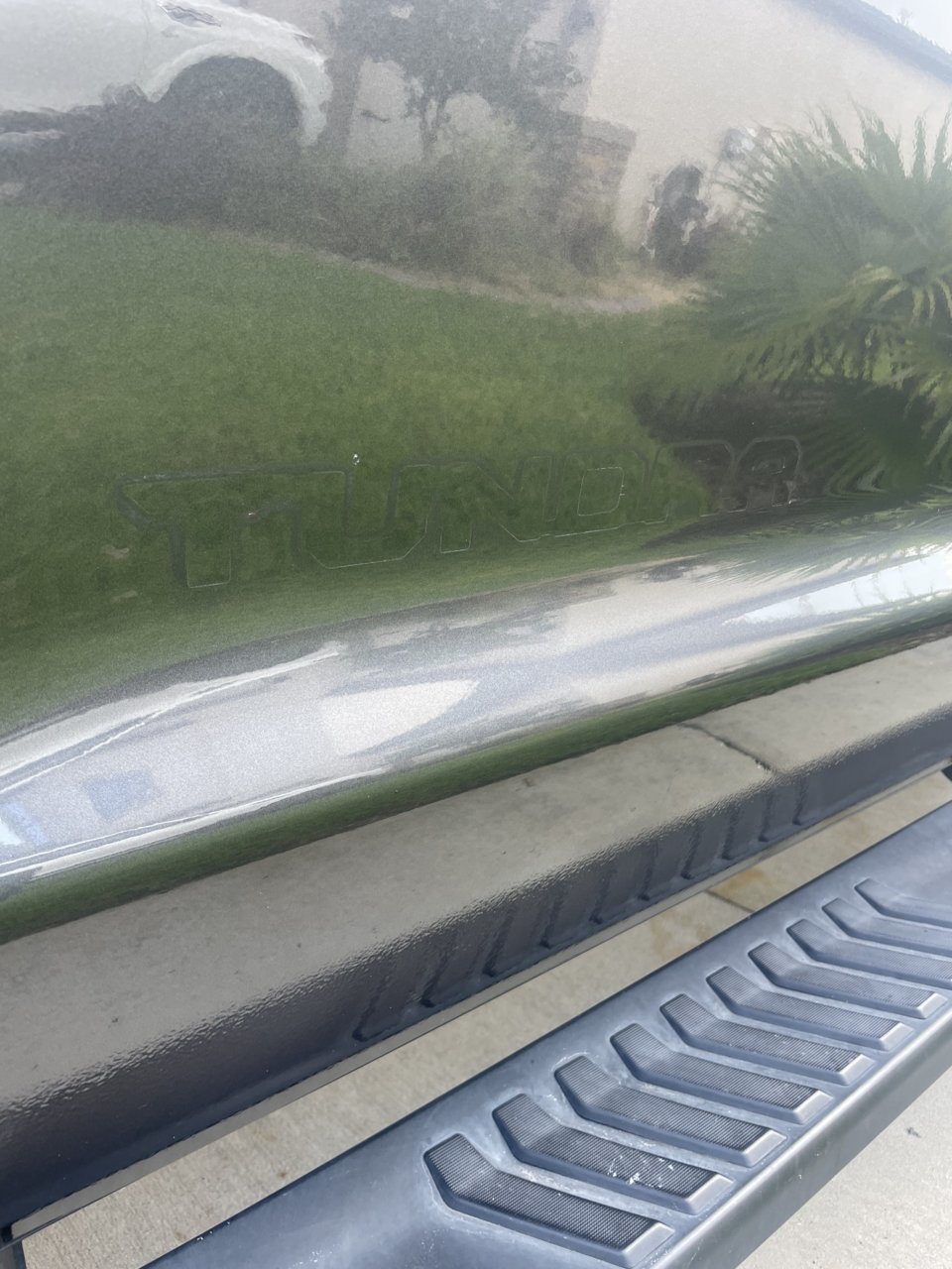

    NDirish44
    NDirish44 [OP] New Member
    Jan 26, 2022
    #73730
    58
    I did use a 3M eraser wheel to get most off but that is what I was left behind with. I went ahead this morning and used a claybar and polish. Looks wayyy better but there is still some showing. Not sure what my next step would be be. Nothing feels raised anymore. 55FBC9D6-838B-428F-8102-EFF62E4F4D6A.jpg

  24. Aug 28, 2023 at 7:59 AM
    #24
    NDirish44
    Jan 26, 2022
    #73730
    58
    I am in the Tampa area. Ended up doing some additional passes with the claybar and the ghosting is very minimal at this point. Once this storm passes going to try some cutting polish like some others recommended. It’s hard to notice unless you’re looking for it.

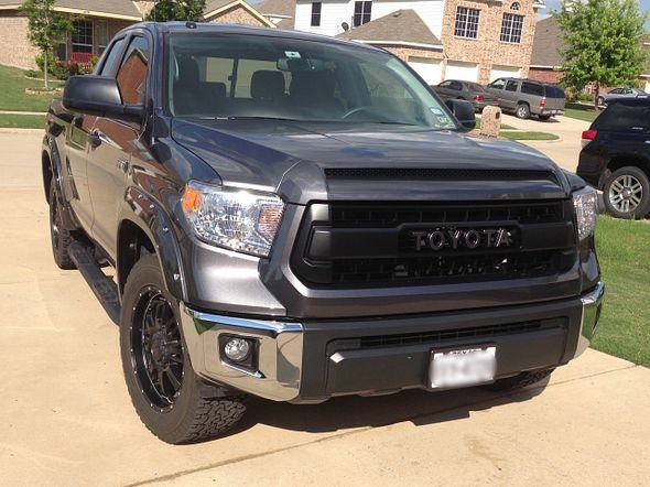

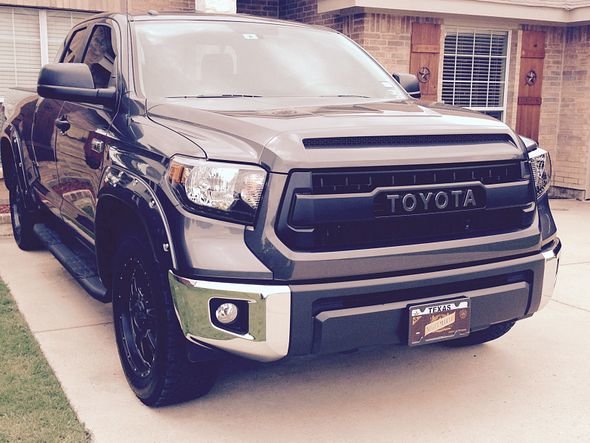

    1lowlife
    May 4, 2016
    #3296
    11,116
    DADA
    THE GREAT STATE OF TEXAS
    2014 MGM DC SR5
    Yes, you will see it EVERYTIME you look at it, but Joe Blow will never know it's there.
    Hopefully the sun will even stuff out.
    When I first did my TRD Pro grille, I was like WTF.
    But after a few months in the sun, air, and weather it all blended in.
