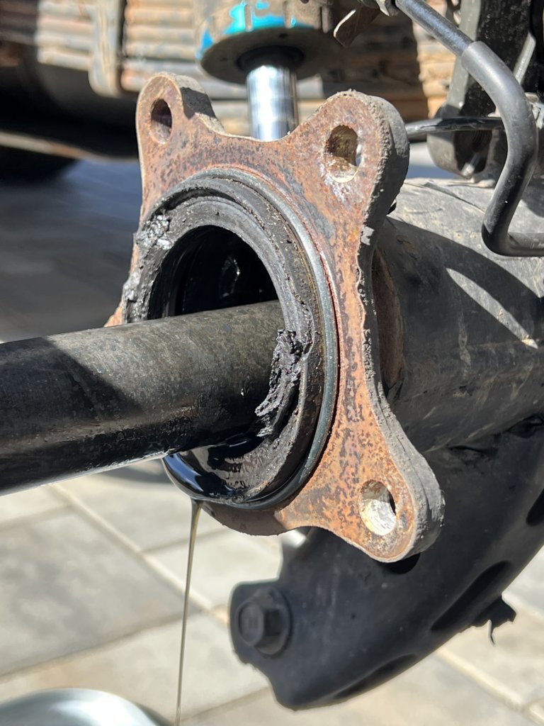

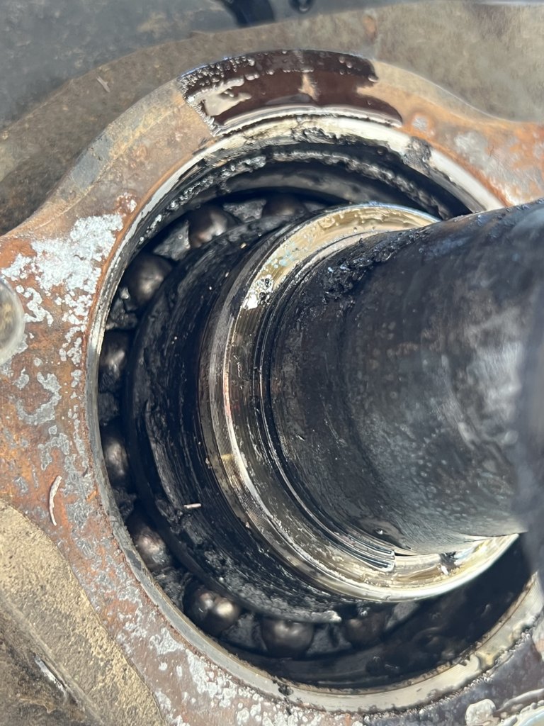

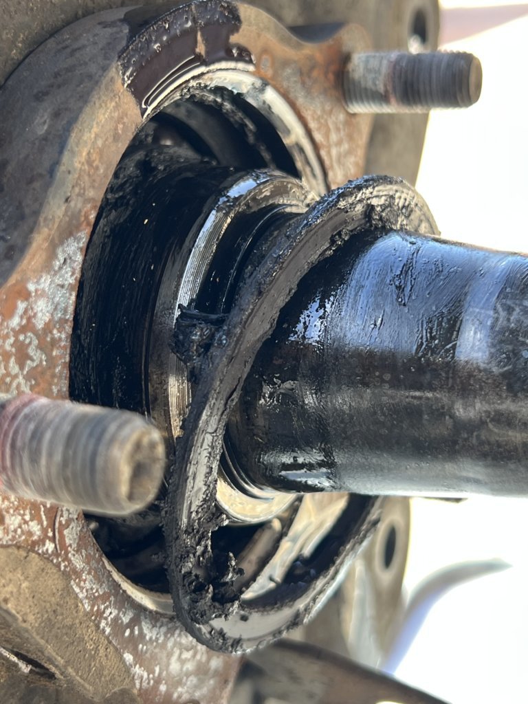

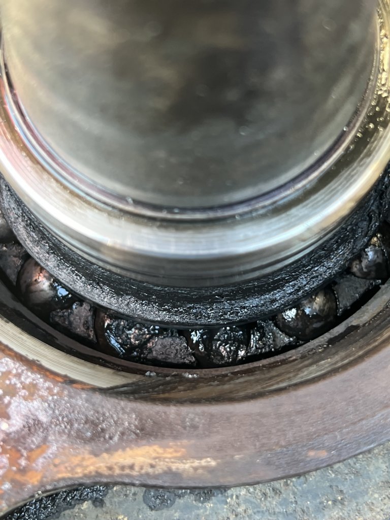

    IMG_7634.jpg IMG_7633.jpg IMG_7632.jpg Lifted the truck engaged locker. Turns out I had to clean the positive connection on the battery and compressor works fine now. Locker works and both tires rotate the same. Still makes that noise when it catches whatever is wrong. Dropped the truck and went in reverse and forward on the driveway into the street. Feels fine. Still makes the noise engaged or not. Next is to pull out the axle. So axel is out what do you think. Anyone?
