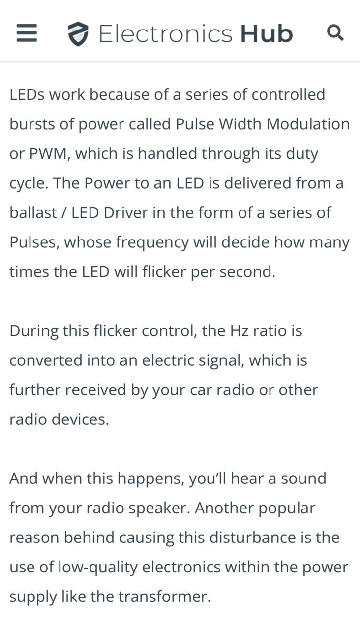

    I need some help,I recently installed a aftermarket head unit(kenwood dmr1007xr)and when I press the break my fm radio gets static(only when I break)does anyone have any suggestions of what the problem would be.thanks

    LED brake lights?

    Yes I have the winjet led version

    Boom. Swap em
    Back for stock bulbs and see if it goes away.

    My 20” LED light bar makes my radio reception much worse when it’s on. Only on some of the weaker stations though.

    Thank you KNABORES for the advice.after unpluging my led tail lights the radio doesnt get static

    glad you found the source. Not all LED lights will create the interference as bad as others. It’s the power supply, not the diode itself.
