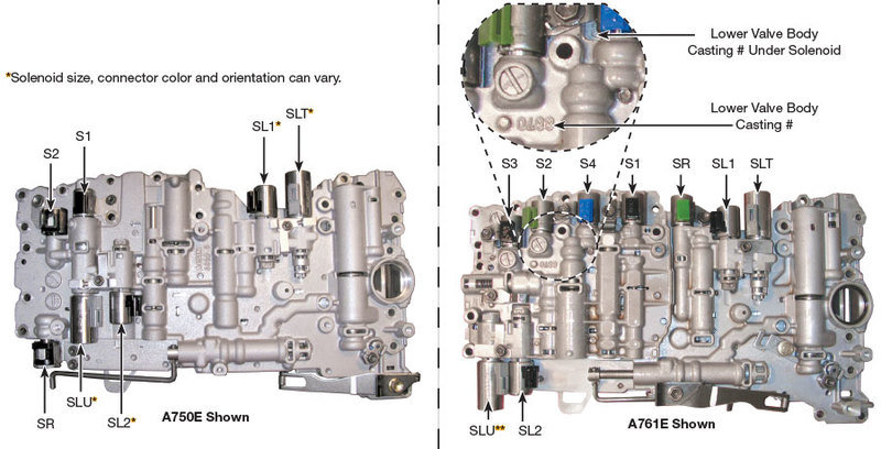

    What’s up guys? Been a long couple of days, went and jacked up the corner of a buddies cabin that was sinking, did some yard work, got real drunk, and finally got a code reader on the truck. Not as capable of a scanner as I would have liked but it did pull a couple codes. Let me take care of these crybaby haters real quick and I’ll get back to talking about trucks…
    ok ladies. This is a forum who’s purpose is the discussion of Toyota tundras. How they are awesome, how they aren’t, how to fix them, how to not break them etc etc etc… of course I expected a little ball busting when I did what I did, and I got some. But the guys just busting my balls were also the guys who were the most helpful. What I didn’t expect was a bunch of petty, get their oil changed and tires rotated at a shop no callus having lames acting like they never forgot to put the drain plug back before adding new oil, got the battery terminals mixed up, got a nail in their friends old lady’s Jeep’s tire dicking around on a construction site or anything other bonehead moves that are bound to happen when a man does what you have obviously never done, which is to sack up and try to do something you’ve never done before because it needed to be done. That is a good mark of a man. An even better one is decided by what you do right after you screwed up whatever it is you screwed up. And even better, how you handle the response you receive from the guy you just talked shit to. Did I say I hope some guy got his converter stolen? Hell yeah. It was the funniest thing I could think of to say back to whatever not helpful dumbassery he said to me. Don’t dish out what you can’t eat yourself.
    anyway, truck is throwing a p2714, solinoid D stuck off. I downloaded the service manual for the A750f, and between that and the tundra service manual I have some serious studying to do. I’m starting to think my tranny is smoked but I still will try to get some Toyota fluid and run a bunch through my tranny, do a filter change, and possibly replace that Solenoid if the flush don’t do it. I took a closed look at the old fluid. It’s dark but it don’t smell burnt and there aren’t any metal shavings in. Sucks the land cruiser tranny won’t work, that would have been super easy and cheap, and I could have trader work for it since I’m broke right now. What if I swapped the transfer case as well? An awd Frankentundrastien might be pretty sweet…

    @OopsWrongFluid You’re on the right track. Probably time to drop the pan, see what’s in the bottom and on the magnets. Then pull solenoid valve D and look for any metal filings. Hopefully just some sludge stirred up and the pump didn’t start piling up and send metal to the valve body.

    It's cheap to drop the pan and pull the solenoid to look for grit or something else that could hang it up.

    So it took some doing but after pulling the pan and solenoid with a knowledgeable buddy my tranny is smoked. Can anyone recommend a reputable company to get a remanufactured transmission?
