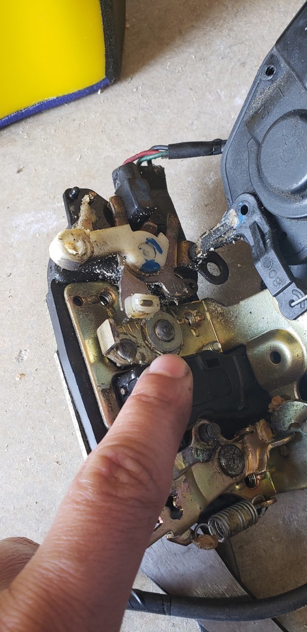

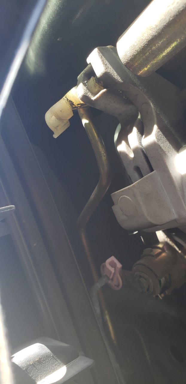

    In my case the actuator wasn't the problem, but the linkage. I'm betting either linkage popped off or was not installed exactly right. Its pretty damn fiddly.
    Try and grab the linkage and pull it by hand to see if you can open the door. At least you didn't put the panel back on so you have some access.
    This pink link is the lock, you may be able to mes with that to get open. The other is the handle. They're both a lot of fun.
    For my problem there was an arm here that I had to bend to get it to engage
