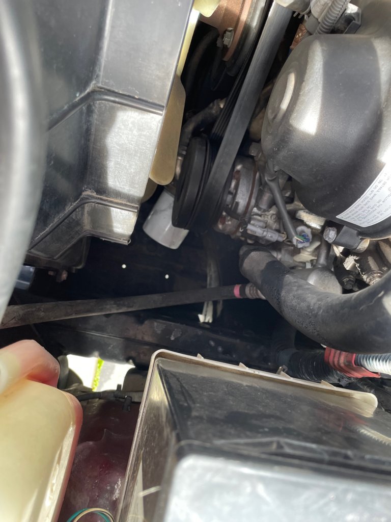

    Hi everyone. First off, I want to thank you for making/contributing to this wealth of knowledge. I'm so happy to have found this place thanks to my co-worker.
    I've been looking to buy my first truck since I was 16. That was a 1985 Toyota pickup with a manual transmission clocking at 350k miles thanks to my Dad making a deal for $500. My Mom didn't love that and talked us into using my college fund to make a down payment on a (much more practical I was assured) 2010 Corolla. I couldn't have known how much that would change my life...
    Anyway, I'm ready for another truck. It would not only serve me as a daily driver for field work, but would also be nice for camping with my wife and nephews. Also doing home repairs, you know, truck stuff! I'm lucky enough to have mechanically competent friends and family to help me through the purchase of what I've decided will be a Tundra, with a budget of about $10k. Well, I'm probably already over budget because I've found one on FB that looks decent.
    It's an '06 Limited DC 4x4 4.7 V8 with 270k miles. The listing has been up for a month and the owner is now asking $11k. I gave it a test drive, and spoke to the owner who apparently needs to get rid of it due to it not fitting in his parking space at home o_O. He's an old timer who used to rebuild vehicles back in the day. He's only had it for a few months and hasn't put many miles on it. Most importantly he told me that a previous owner took the Tundra to a Toyota dealership who then replaced the engine (charging only about $2k for labor) at around 200k miles. This was on one of the receipts which he happily showed me.
    Transfer case was also replaced with a used one due to a past owner having issues getting from 4wd to 2wd.
    Soon after the test drive, I paid for a pre-purchase inspection (details below photos) which the owner was happy to bring the truck to. I also got the Carfax. Very few reports of oil changes o_O so maybe that's why the engine needed replacement, I don't know. Of course the owners may have been doing it themselves.
    I gave the dealership a call about the engine replacement and they did confirm that it was in for repair at the time it showed on the receipt, and while they did mention work was done to the engine, I wasn't able to get many details. So here's my question. How would you confirm if the engine was in fact replaced? The VIN is still the original. I popped the hood which I'll include photos of here. I appreciate any help I can get as this engine being replaced is really the only way I'm willing to shell out this kind of money. Also I'd love to hear what you'd pay for this despite a lack of photos.
    PPI Details:
    tpms light with following codes: C2122, C2123, C2124.
    Front daytime lights out, left front turn signal lens cracked.
    Brake fluid may never have been serviced.
    Cooling system -19 degree protection, mechanic recommended service.
    Drive Belt cracked.
    Battery at 66% Health, 72% state of charge. Idle no load 14.03V, Idle load 13.7V Diode Ripple 0.12 V.
    MAF Filter needs replacement

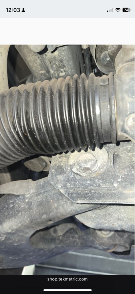

    Steering rack seeping with drips on passenger side, pressure hose seeping. Recommend replacing as pm.

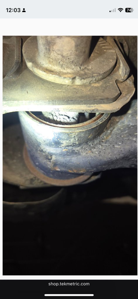

    Front lower control arm bushings heavily cracked/broken, uppers cracking. Sway bar end link bushings cracking and ball joints seeping.
    Engine mounts slightly cracked, recommend monitor.
    Trans fluid: atf varnished, services at 237k 3-4 shift felt hesitant on test drive. recommend monitor, may need trans repair in future o_O
    Rear diff fluid heavily varnished, recommend leak repair and drain and fill of fluid
    No history of spark plugs (but they'd be replaced with the engine riiiiiiight??)
    Drips present at left rear axle seal and transfer case.
    No history of induction cleaning, due every 30k on port injection, recommend service.
    Okay, that's all. Not sure how much of that needs to be addressed before I daily drive it. I've sort of made the mistake of falling in love with a truck I haven't bought yet. I need help. If I do buy this, I'll be sure to replace the LBJs with OEM immediately;)

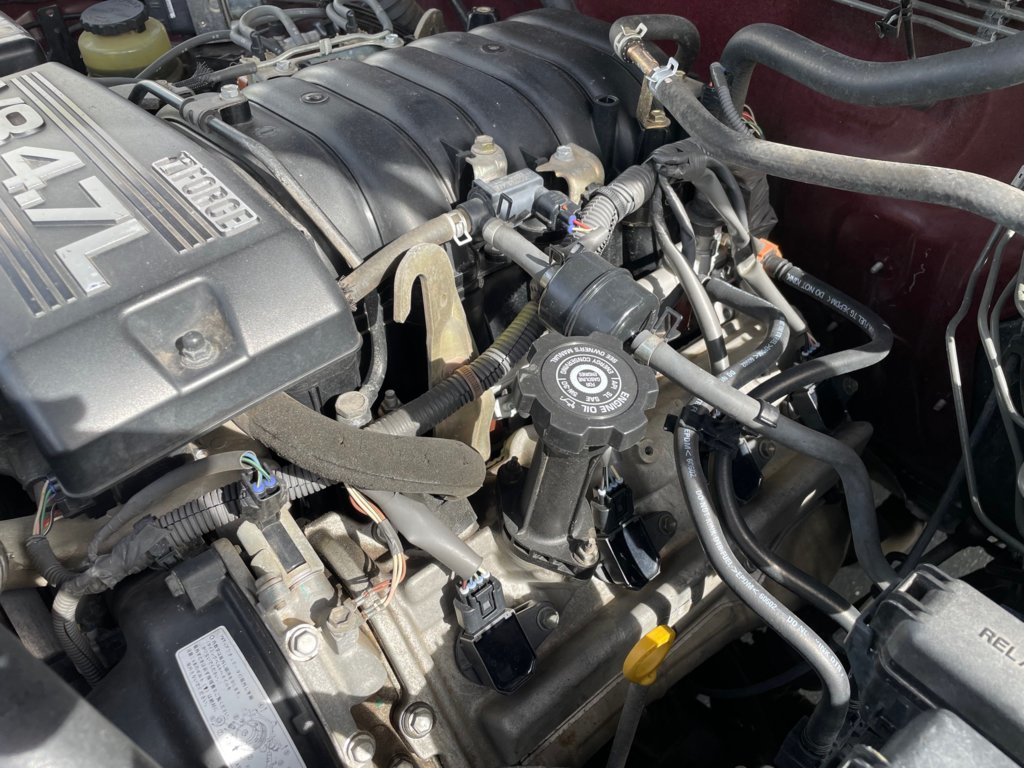

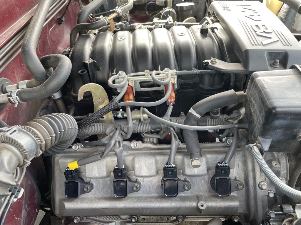

    Werent a jy engine, i dont see a lick of paint pen.

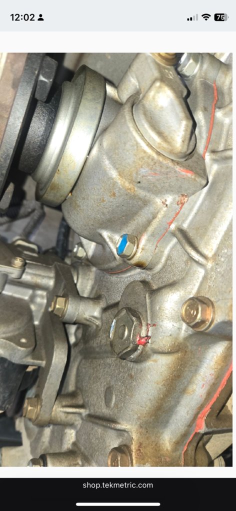

    very nice. Only tattletale that the engine might be different is i think i see 3 different ages of vacuum lines.

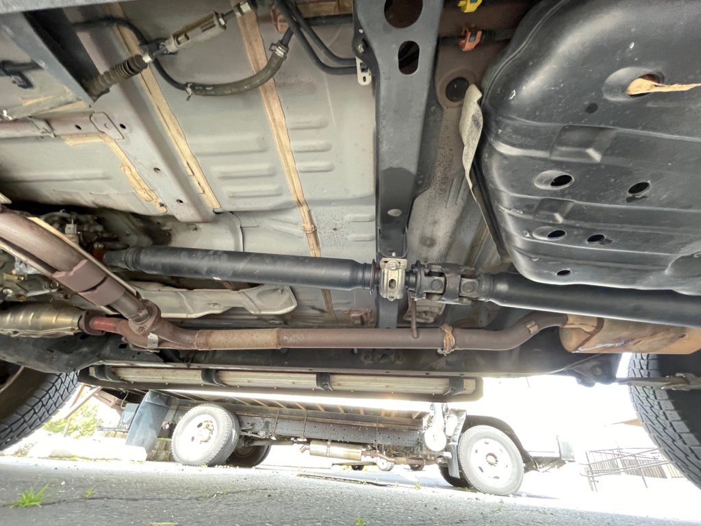

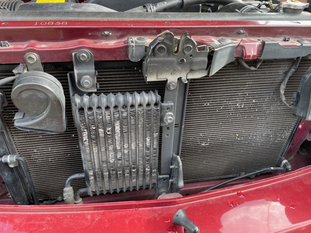

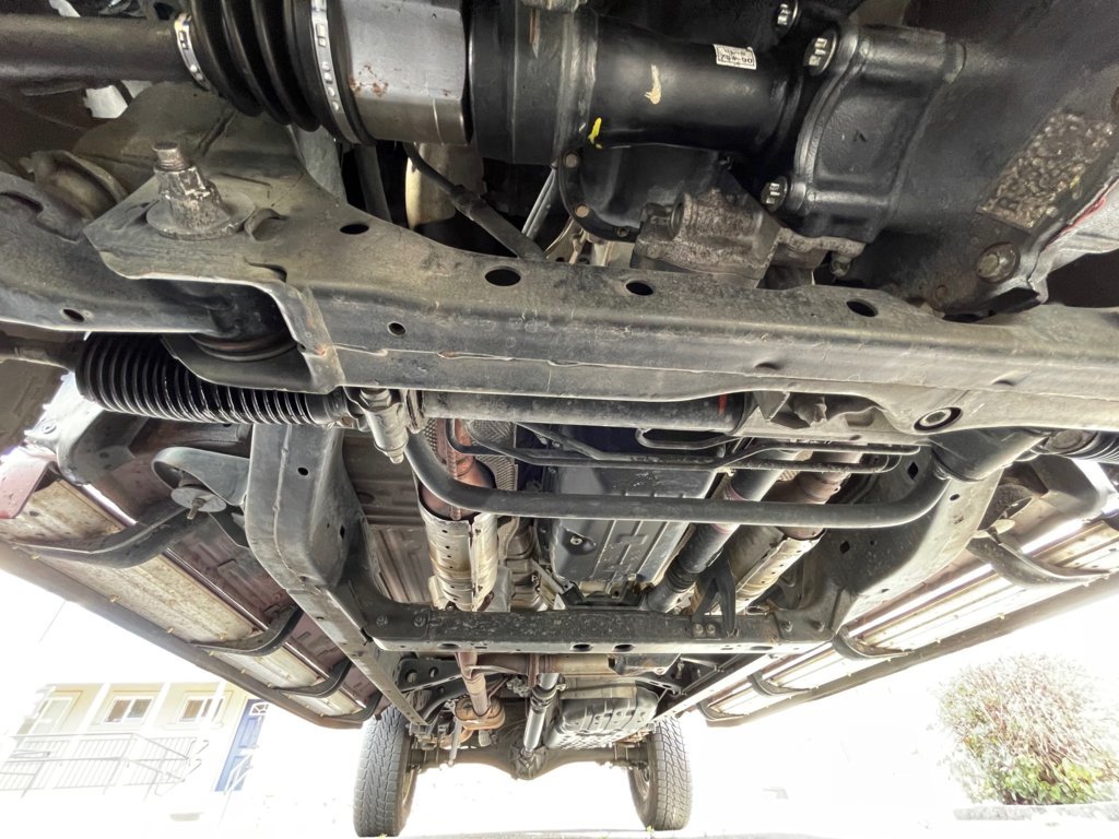

    Wow, you guys are the best! Thank you for the replies. I'll share everything I have here because again, I've made the mistake of falling in love with this one and I do need a firm talking to here :) I want every reason not to buy it. That being said the old dude seems like he may be flexible on price and I do plan on doing what I can to maintain/repair what I can (along with some help from friends/family).
    I've given another look at the legendary "so-you-wanna-buy" thread and see that I definitely need to give an inspection of the timing belt as the PPI did not inspect that. Please see the photos and Carfax below. I took the photos wen I test drove it. Let me know if you feel better or worse about this one after looking. I did make an account at Toyota.com and there's not much on there but it does corroborate that it was at the dealership at time of the engine swap, but it doesn't say explicitly that an engine swap was done. I gave the dealership another call about the engine and they're going to call me back with details, hopefully I can confirm the replacement. Carfax has way more info than the Toyota website and so I included that PDF at the bottom.
    I hear you guys saying it's got a lot of problems. Only reason I'm considering it is the engine replacement.

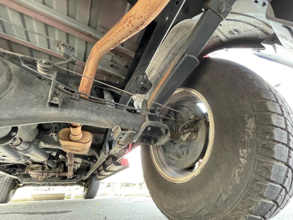

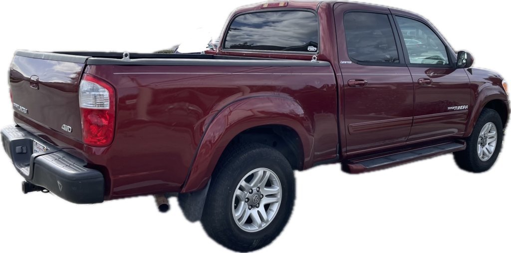

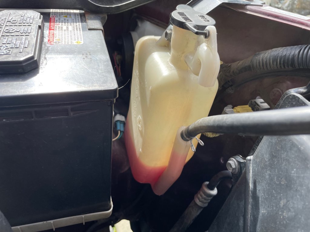

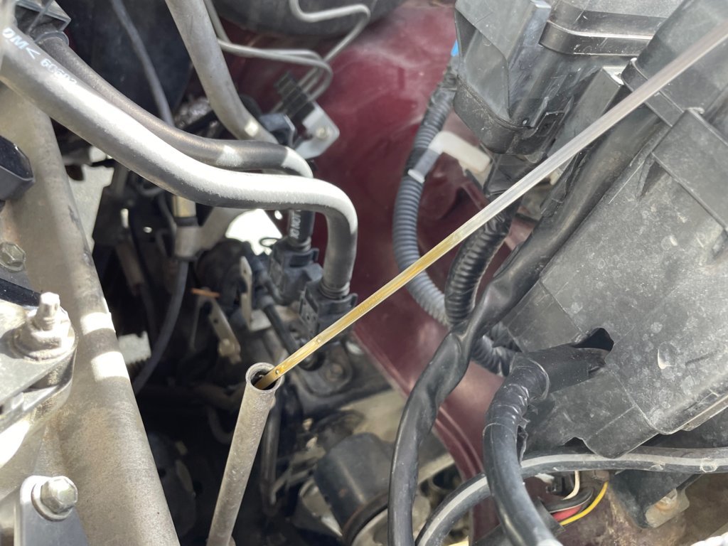

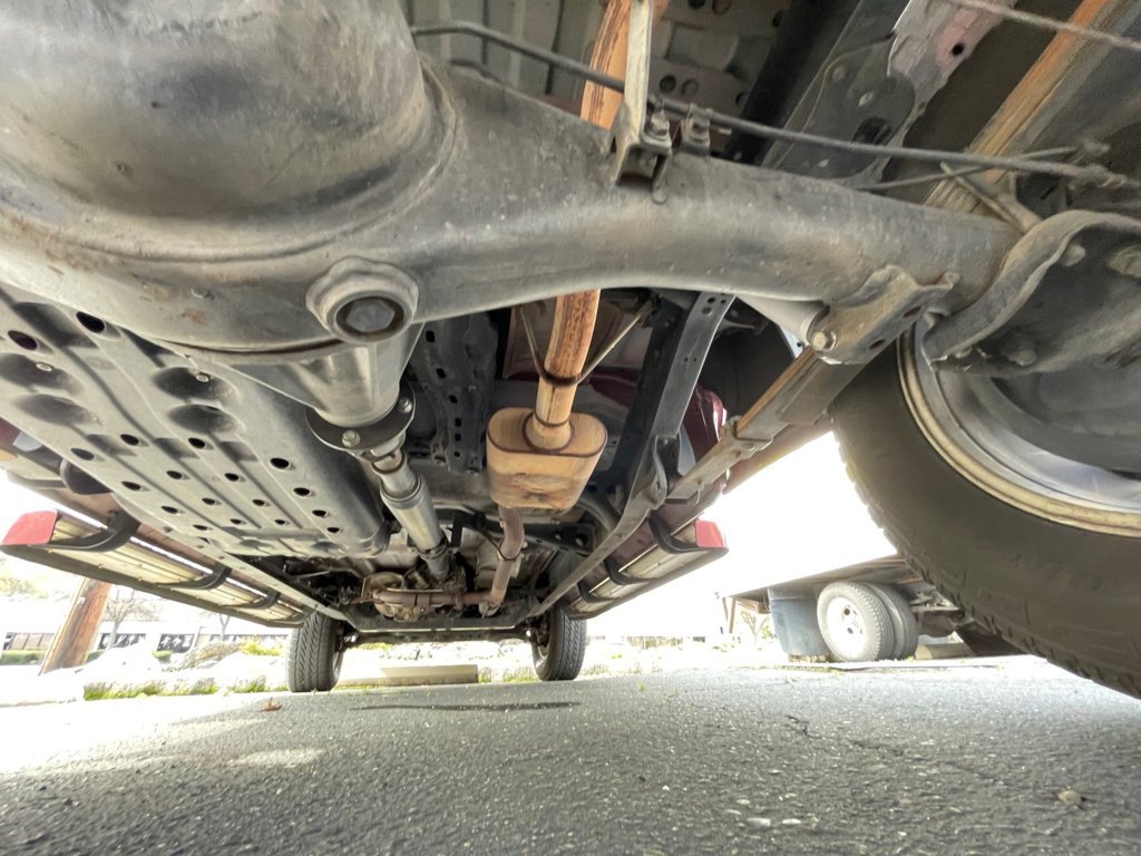

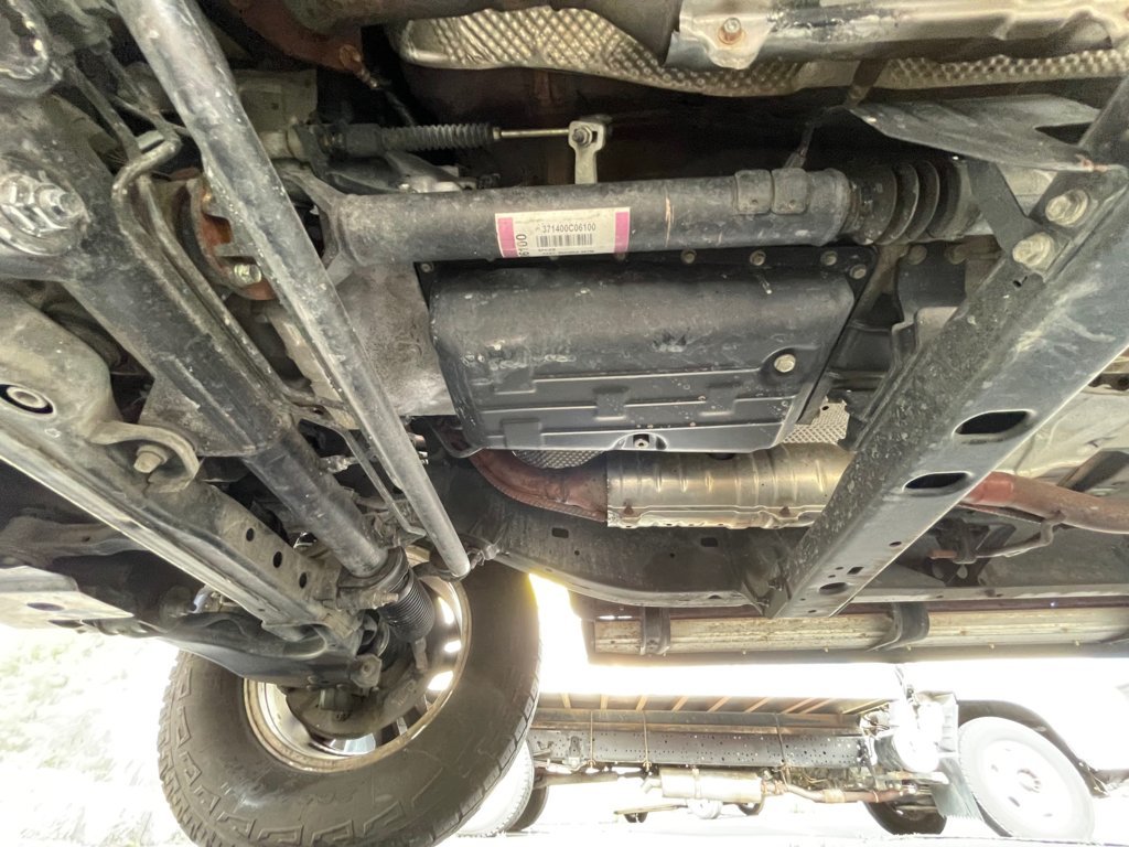

    IMG_2631.jpg IMG_2642.jpg IMG_2646.jpg IMG_2647.jpg IMG_2652.jpg IMG_2654.jpg IMG_2655.jpg IMG_2659.jpg IMG_2660.jpg IMG_2663.jpg IMG_2666.jpg IMG_2669.jpg IMG_2670.jpg IMG_2672.jpg IMG_2686.jpg IMG_2687.jpg IMG_2828.jpg

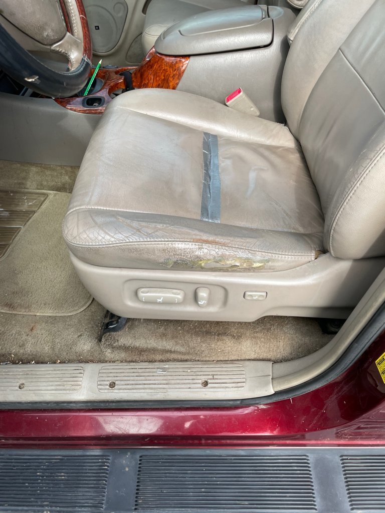

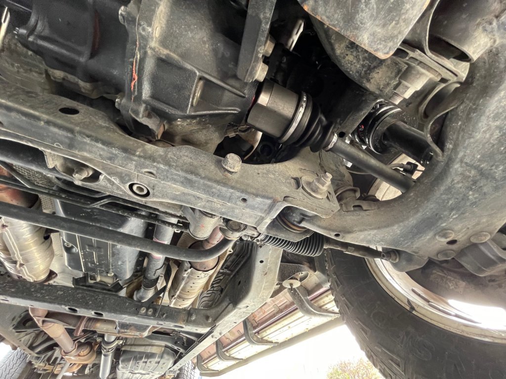

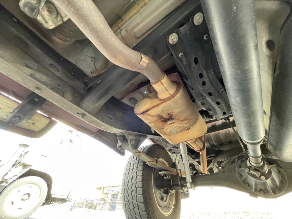

    Man. That undercarriage looks great. Not so much the inside of the cab though. Did you take these pictures yourself?
    I might have to eat my words on saying "pass".
    I'm guessing the mechanic who diagnosed/inspected it probably counted on capitalizing from doing all the work he recommended.
    It's tough to say without seeing it in person or driving it.

    Like others have said- definitely check the timing belt, and get a quote for the leaky rear axle.
    That said, that truck is completely rust free, has a ton of new parts, and a handful of the recommended items on the inspection list are unnecessary. It looks a lot nicer than plenty of the trucks we see on this site. Here's the thing: no matter how nice it is, all of these trucks are 20 years old, and are gonna require a higher level of attention than a new vehicle. There's going to be some issue, at some point, period. However that doesn't mean that you won't be able to enjoy a safe, capable, reliable truck that will still last a long time, even at that mileage. You just need to pay attention to things a bit more.
    I don't know enough about the Double Cab market to confidently throw a value out there- hopefully someone who does can chime in.

    I hear what you're saying. I was told the engine was replaced due to a manufacturing defect. That being said I gave the dealership another call this morning and am expecting a call back with more details about it. It sounds like I should run. I was hoping it would be a bit of a project up front for something that would last another 10 years but it sounds like that is not gonna be the case. I'll keep looking as you've suggested, I know you've got my best interest in mind :(:thumbsup:. I did forget to share the PPI photos the mechanic took, so here they are:

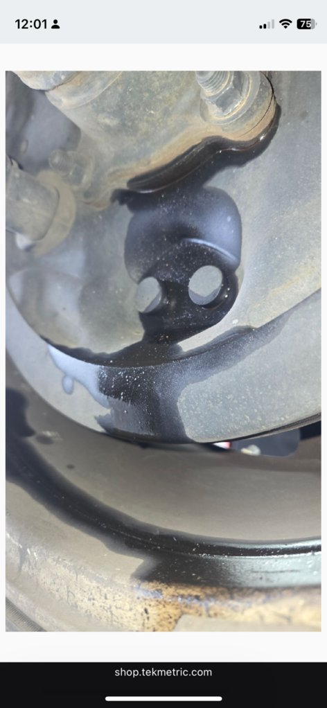

    IMG_2840.png IMG_2839.png IMG_2838.png IMG_2837.png IMG_2836.png IMG_2835.png IMG_2834.png IMG_2833.png IMG_2832.png

    And we're telling you the person who's saying that is full of shit, and clearly doesn't know the 2UZ-FE very well. They have zero reputation for "manufacturing defects". This isn't a Ford or Dodge. You shouldn't trust whoever told you that, and it sounds like some shit a salesperson would say to sell you something.
    The only person who could tell you "manufacturing defect" was the cause would be Toyota. Sometimes manufacturers will ask for engines back if something wildly unexpected happens. The 2UZ-FE has been used for years prior to the Tundra coming out, by the time they made it into our trucks, the engines were well-vetted.

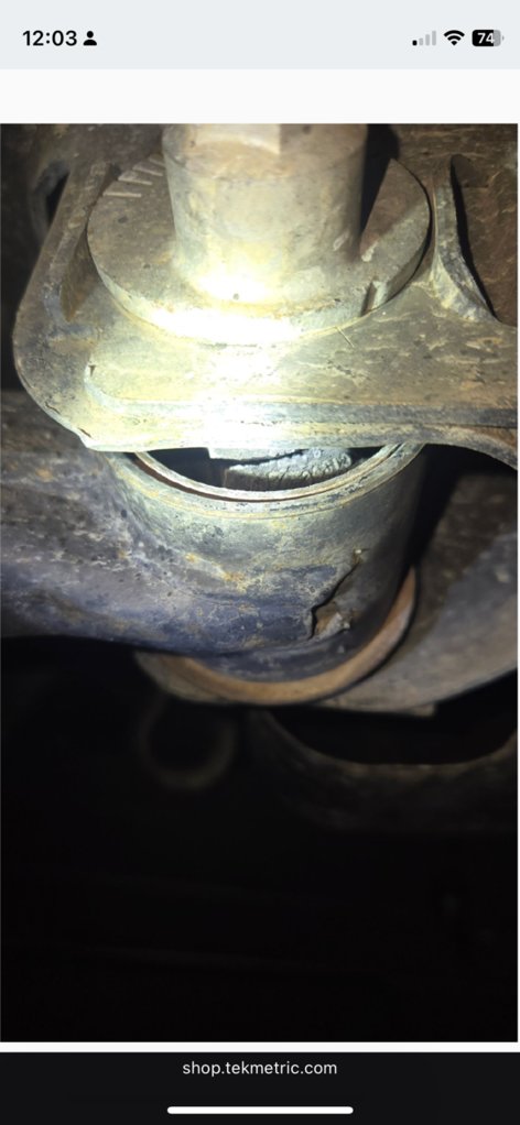

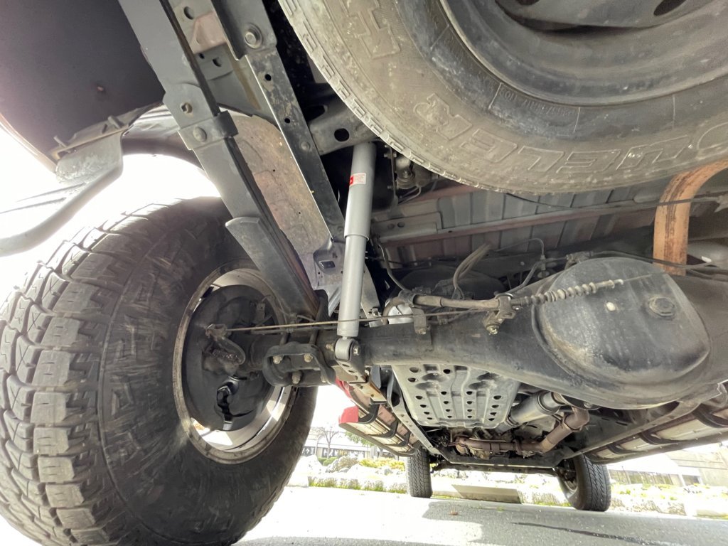

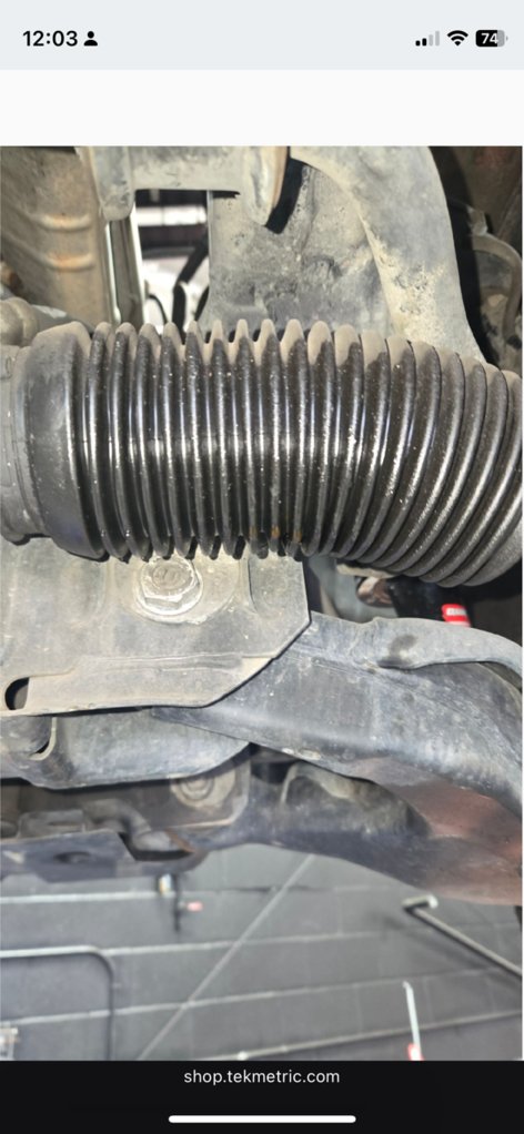

    You definitely have the axle shaft seal leak. At a minimum, you are going to have to pull the axle shaft and bleed the brakes once everything is back together. Your brake shoes are probably oil-soaked now.
    Control arm bushings are pretty involved and yours need replaced. You're going to have to do some considerable front disassembly between your sway bar bushings, ball joints and control arm bushings. Not to mention your steering rack.
    You're going to have to put some time and $$ into it for sure. As others have said, the engine situation is concerning too.
    $11,000 is too high. I think you are making the best decision passing on this one. Some good news... I am surprised every day at what appears as far as clean first gen tundras. Every time I think I've seen a unicorn, another one turns up. They are out there.
