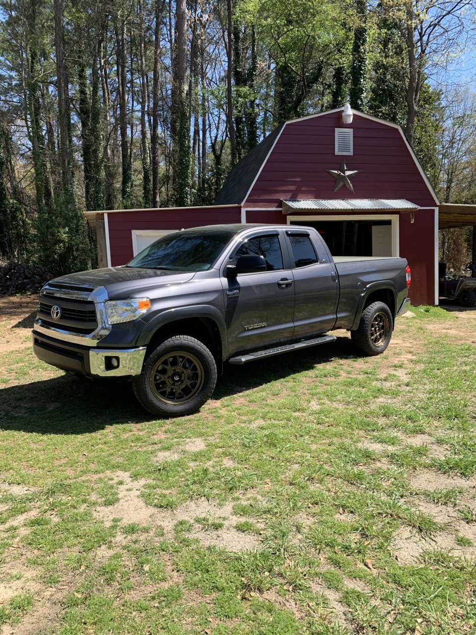

    I just did my 2015. Ordered it from boss4x4 5100’s and a diff drop. Super cheap and rides great. Ended up finding a busted shock in the back. My set up 5100 on the top setting and a toytec 1” block in the rear. Could t be happier. 6793D72B-FF15-4F5F-8E87-BE85F87A569D.jpg

    I’m curious as to why the shop told me I didn’t need the differential drop and the angle doesn’t look bad at all but I see a lot of members here installed the diff drop on leveling kits

    The kit I ordered came with it. It was a little bit of a pita to install no room for hands to put the nut one the bolt. But otherwise I did the whole install myself in about 2.5 hours. Just needed a spring compressor. I did the diff drop just to save the boots. I really don’t know it it helps but I had it. Can’t see it hurting other then my hand to install it.

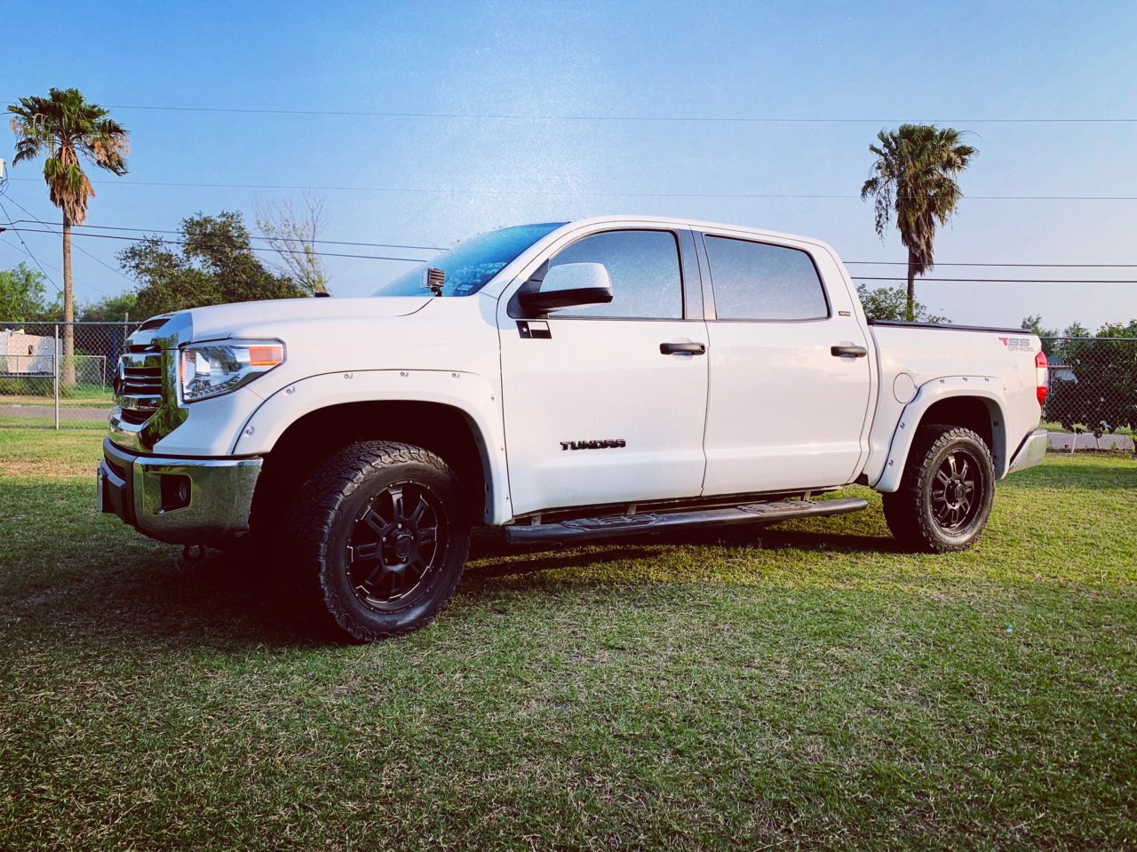

    I have the Bilsteins 5100 as well front setting only at 2.5”. Perfectly aligned with the back. Love the ride. Still doing research on getting taller wheels. Im currently running 285/55/20 but want 285/65/20. Does anyone know if UCA’s add a bit of a lift?
