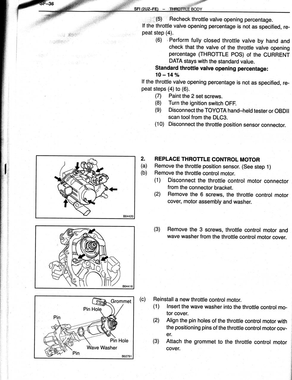

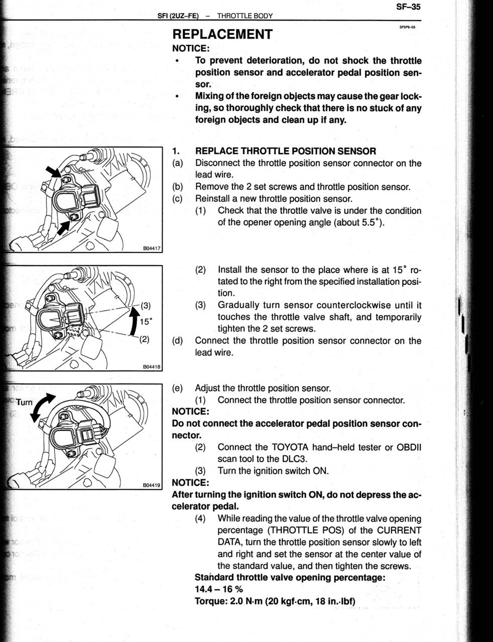

    Your Haynes Manual refers to the TPS(throttle position sensor) needing adjustment, which is correct. Taking the throttle body off does not require any adjustments on reinstalling.
    If you wish to calibrate the TPS, the pics below might help unless Haynes Manual explains it well enough. You are aware you'll need an OBDII capable scan tool to adjust the final throttle valve opening percentage.

    Holy Moly that’s a sweet looking scanner, makes my Techstream look like ekasketch !
    You can download 2001 Electrical Wiring Diagram from below link courtesy of @RainMan_PNW
    Ultimate Wiring Diagrams Collection | Toyota Tundra Forum (tundras.com)
    If it's just TPS or APS, the below may work ?
