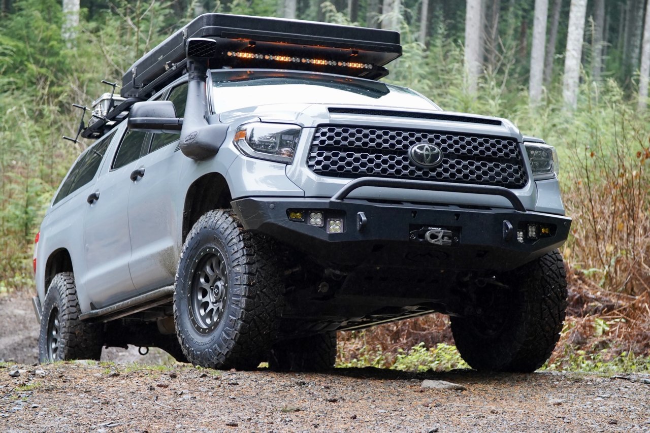

    2020 Platinum Tundra 4x4 crew max
    Heritage Grill, OME BP-51 suspension, Flowmaster outlaw, Nitto Ridge Grappler 34.6, 20x10 fuel assault, AFE intake.

    2018 Tundra Crew Max
    OME BP51 Front and Rear, Complete de badge, ARE Z Series camper shell, Decked system, TRD CAI, painted hood bulge and grill surround, WeatherTech mats
    None. Better than stock. 37s fit bcs of front bumper, Lift, aggressive BMC, removal of front sway bar.

    2015 Silver Tundra 1794 Edition
    What brand of rack/rtt is that? I’m looking to add an rtt to my rig and, like you, I’d like to put the rtt on the cab. I have a SnugTop Rebel and I know it’s not rated to support the weight of an rtt and 2 people.
    iKamper Skycamp 2.0 on Rhino Rack Pioneer Platform.
    ARE Z Series. If I had to do it again I’d opt for the ARE that’s got a better weight rating.

    1,022
    What tire size was this setup?
    May have been 285/70/18s or 295s.

    '19 Tundra TRD SPORT, ‘21 Trail Edition
    Trd pro suspension
    What offset wheels are you now on with the 37s? Thinking of running the bp51 too

    I’m on 37x12.5x18 stocker wheels with 1” spacers up front for uca clearance. No clearance issues with the BMC and aftermarket bumpers. Not too sure what the offset works out too... +25?? I’m on regular old OME kit. Same idea for height though.
    SCS Ray 10 in 18x9 with a 6" backspace and +25mm offset.
