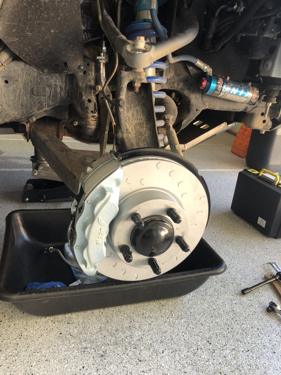

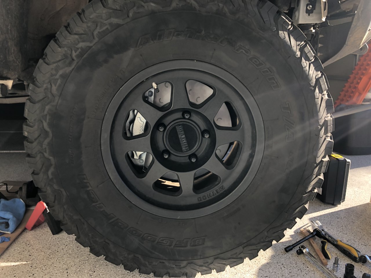

  5. Jun 12, 2022 at 8:25 AM
    #35
    Tiamat
    Tiamat New Member
    Nov 15, 2016
    #5213
    386
    2015 tundra crewmax xp
    I finally installed the stoptech hd tow axle kit on the truck. Stopping from 65mph will give you whiplash! Huge initial bite and stopping power. Hoping they dont warp like oem did.

  6. Jun 12, 2022 at 9:42 AM
    #36
    Leverguns
    Leverguns [OP] New Member
    May 17, 2022
    #78515
    24
    Tommy
    2019 Platinum Crewmax
    Bilstein Sway bar and heavy duty rear springs
    You just did the rear?
    Or the front?
    Or both?
    I appreciate the follow-up
  7. Jun 12, 2022 at 9:50 AM
    #37
    Tiamat
    Tiamat New Member
    Nov 15, 2016
    #5213
    386
    Did front and rear.

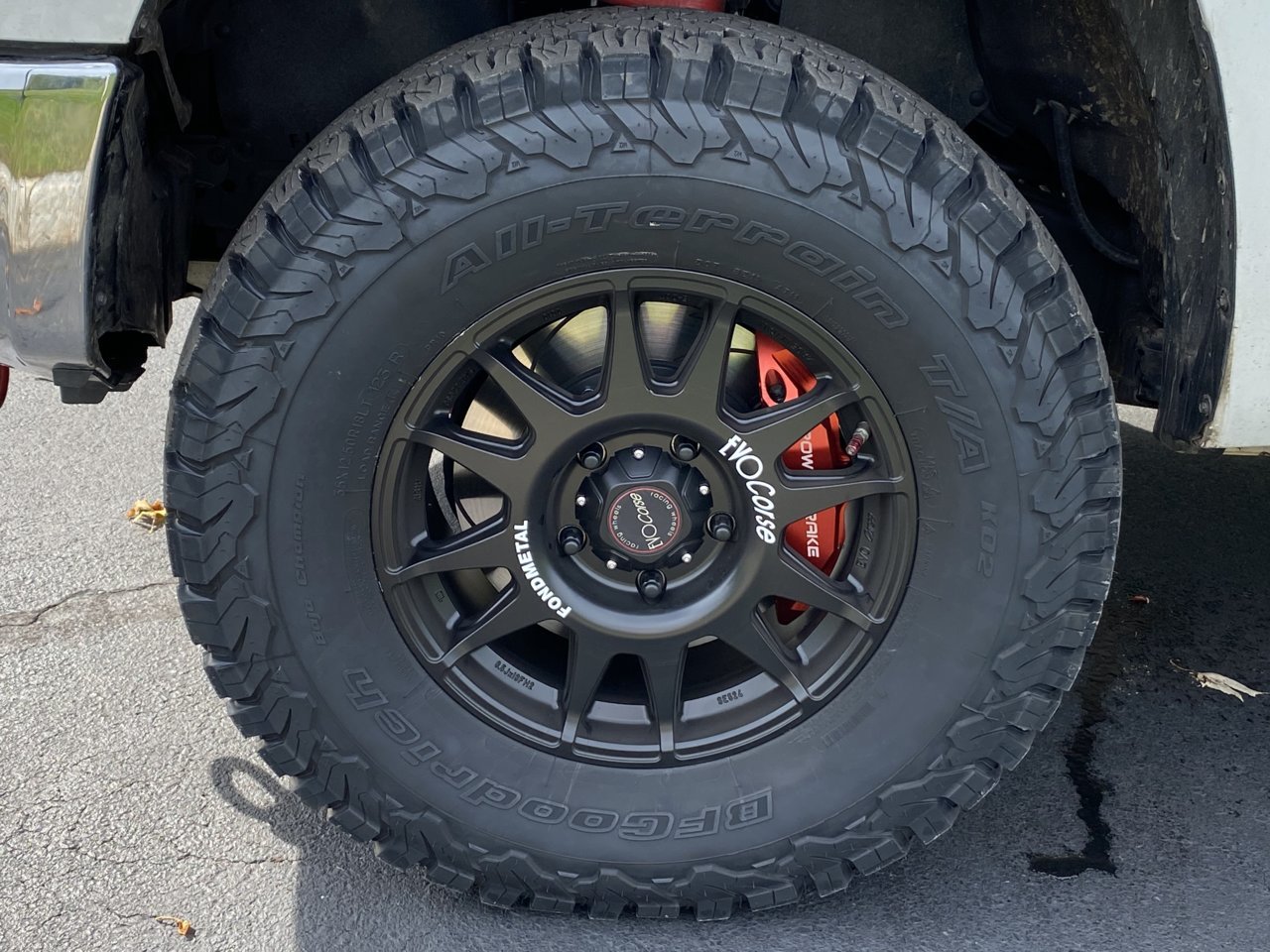

  15. Jun 13, 2022 at 8:37 AM
    #45
    Tiamat
    Tiamat New Member
    Nov 15, 2016
    #5213
    386
    1000% agree about the BBKs almost pulled the trigger on a trd used kit but they sold before i got it the offer
    For the price you are paying for these trucks the trd package should come with trd shocks big brake kit dual exhaust and front rear .
    swaybars.
    reywcms[QUOTED] likes this.
