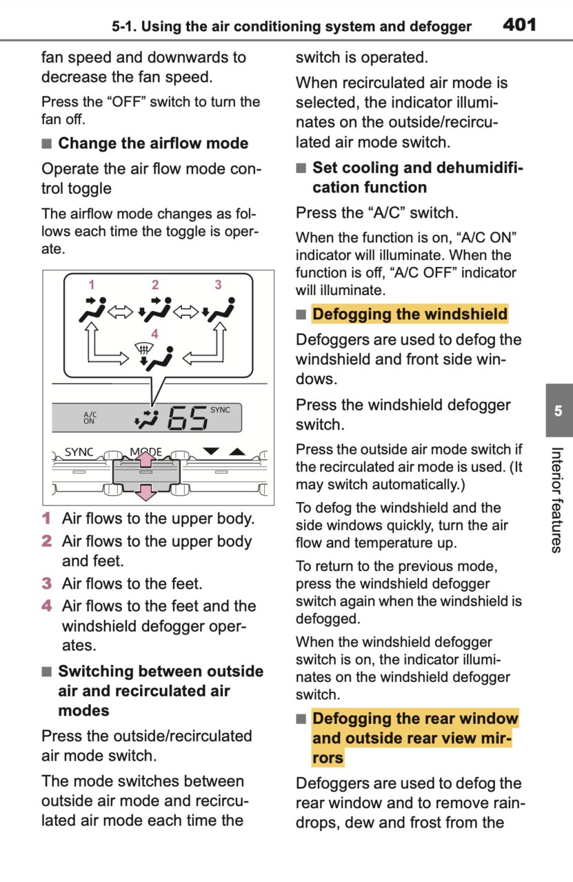

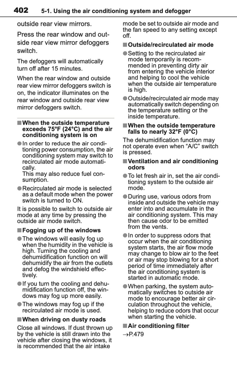

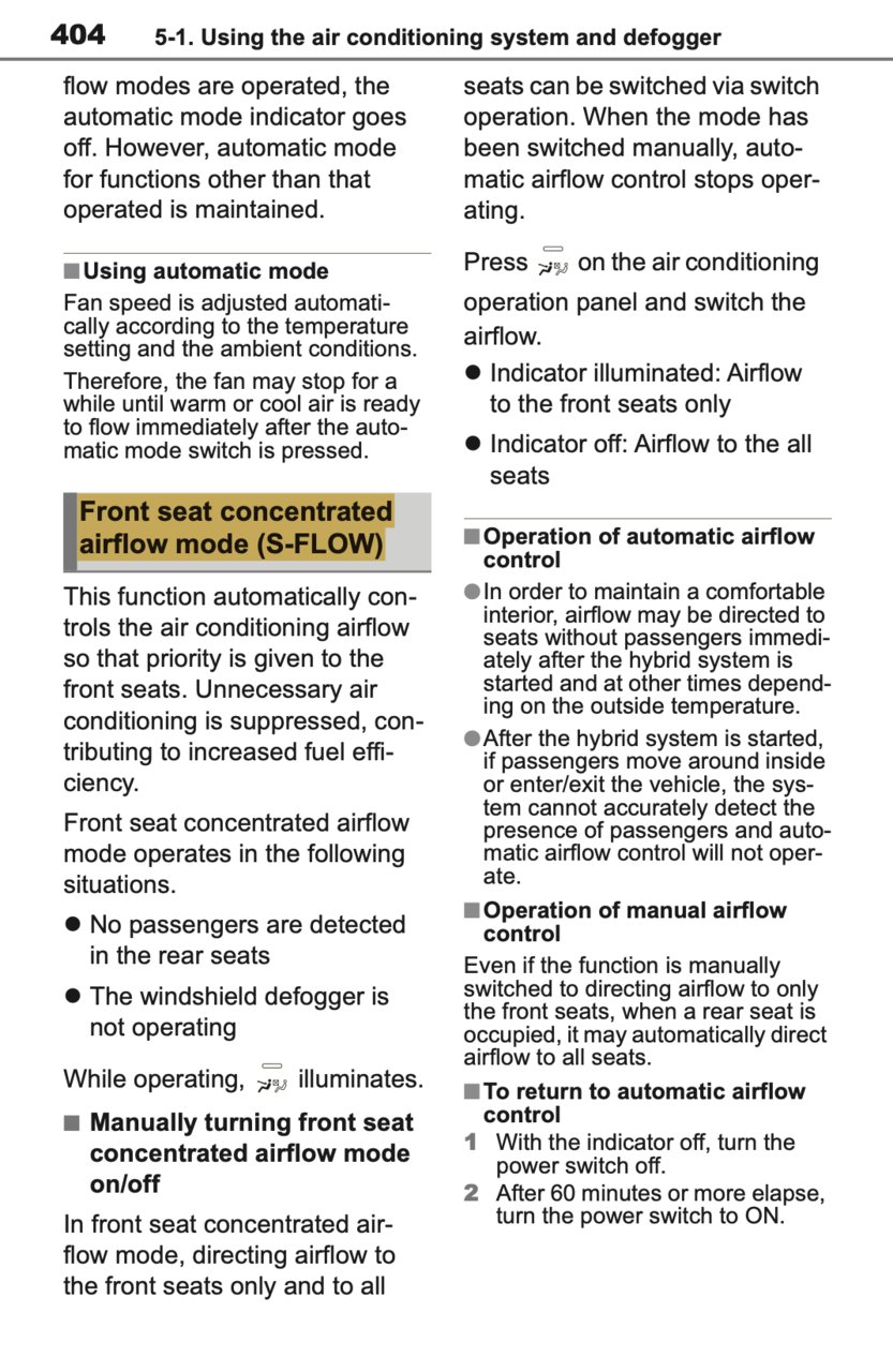

    A couple of things to try. Don't stay in ECO mode as it "improves fuel economy through moderate throttle characteristics and by con-trolling the operation of the air con- ditioning system (heating/cooling)." Make sure that the rear vents in the back are on. My wife noticed that ours were off.
    Screenshot 2022-12-19 at 5.07.34 PM.jpg Screenshot 2022-12-19 at 5.07.43 PM.jpg Screenshot 2022-12-19 at 5.51.43 PM.jpg
