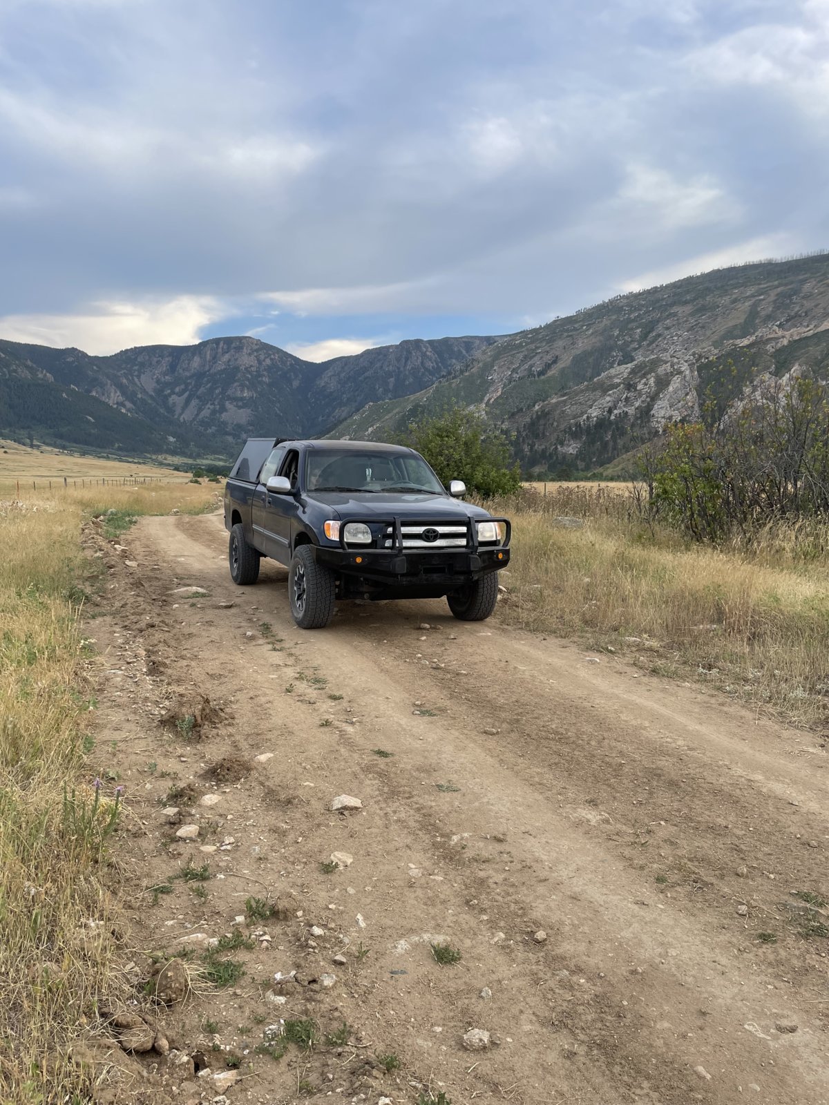

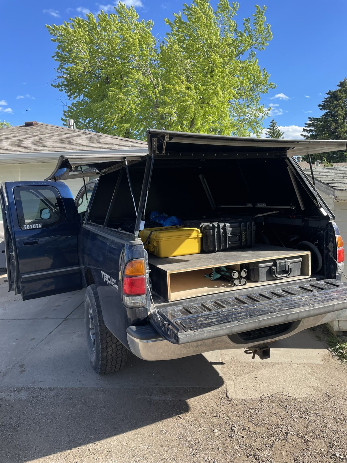

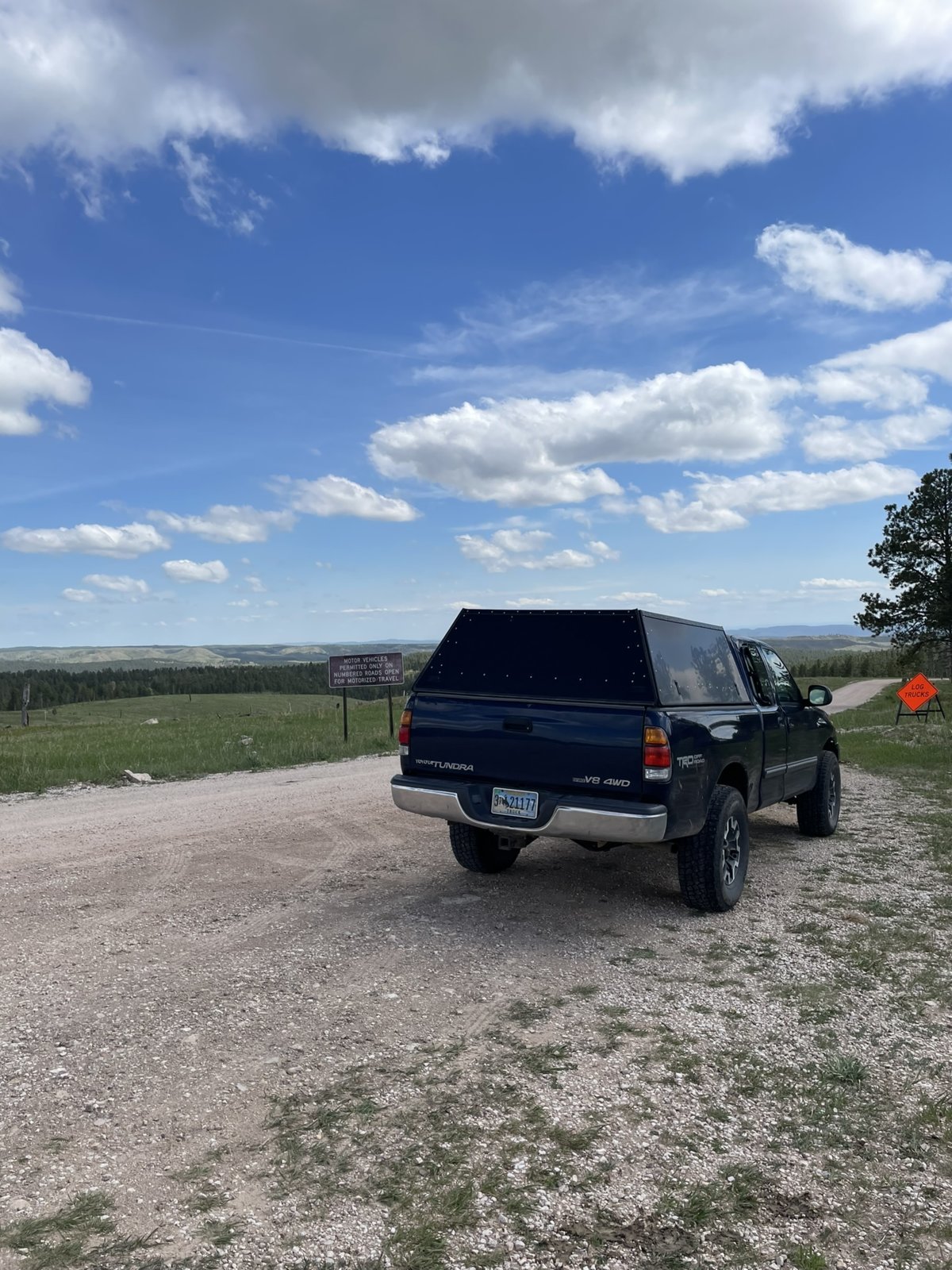

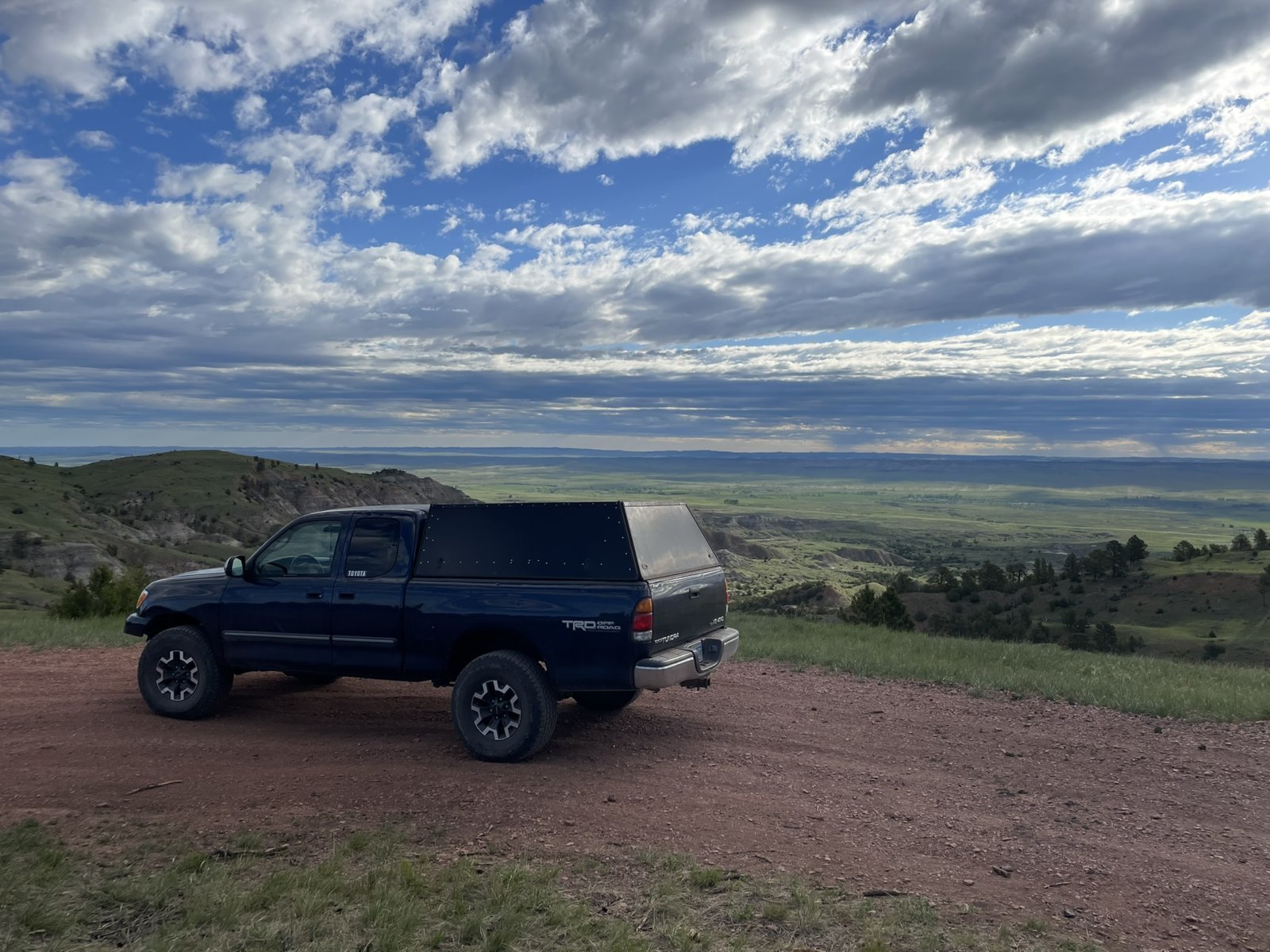

    Long time no post... heres a few updates:
    finished my topper, went with a GFC style build, both sides and back open up. I've really been enjoying the functionality.
    few odds and ends:
    • denso k20RU spark plugs
    • denso air filter
    • all 4 denso o2 sensors (no check engine light!)
    • toytec single AAL
    • Icon rear bump stops PN: 191205
    • new front brake pads
    mileage: 290,000
    I also built this 3/4" plywood platform
    took the truck on a 1,000 ish mile road trip recently and got 12.8 MPG in best case conditions:bananadance:

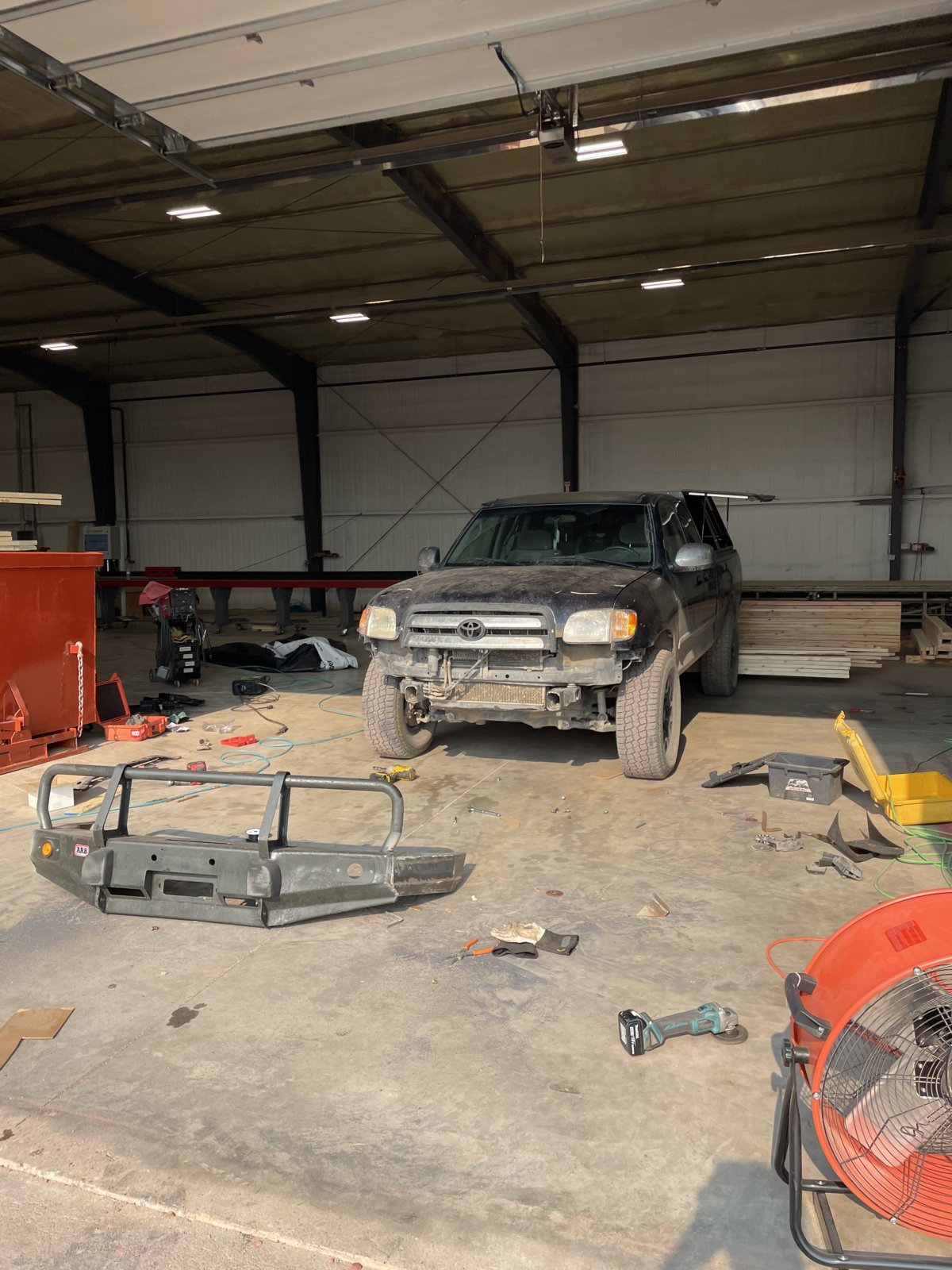

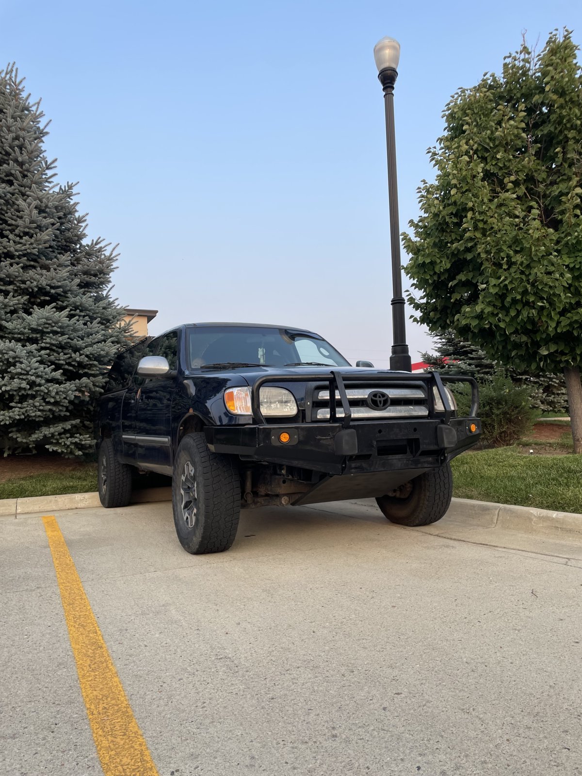

    A few weeks ago I came across a great deal on a beat up first gen Tacoma ARB, I decided I would chop it up and make it fit my truck: this took a crazy amount of work, both ends of the bumper got cut off and I had to rebuild the end caps. It’s probably 20 hours of fab work all said and done. If I did this again I’d spend more time trying to find a 2nd gen Tacoma ARB, like the basils garage truck has.
    I’m really pleased with the end product. It’s not perfect, but it fits and looks pretty good. The reason I did this and not a FGT specific bumper is that none of the available options look this good except maybe the BFF, but they’re very expensive and I believe there’s a long lead time. The iconic Australian style bumpers are by far my favoriteIMG_6866.jpg IMG_6902.jpg IMG_6877.jpg

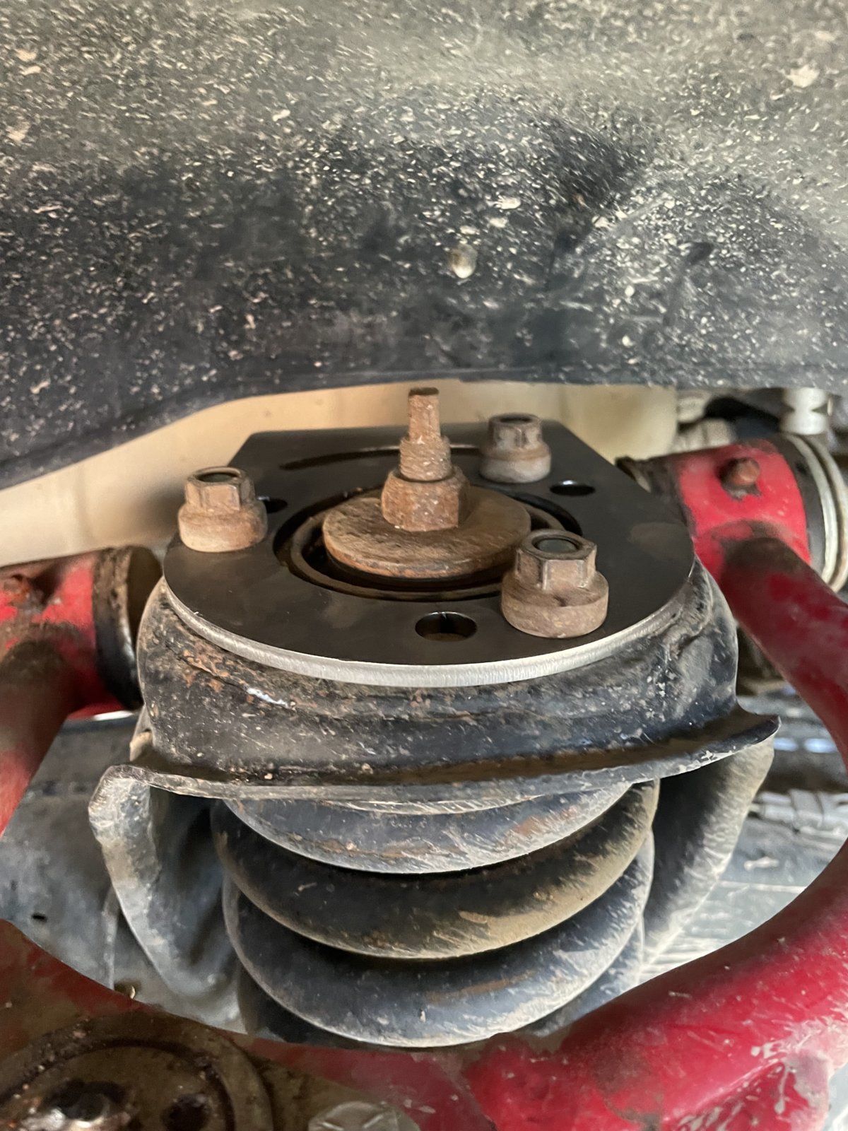

    I also built the skid plate which turned out nice. It’s 11 gauge steel (1/8”). I was curious on the strength but it seems fine since I can lift the truck on the skid plate:)

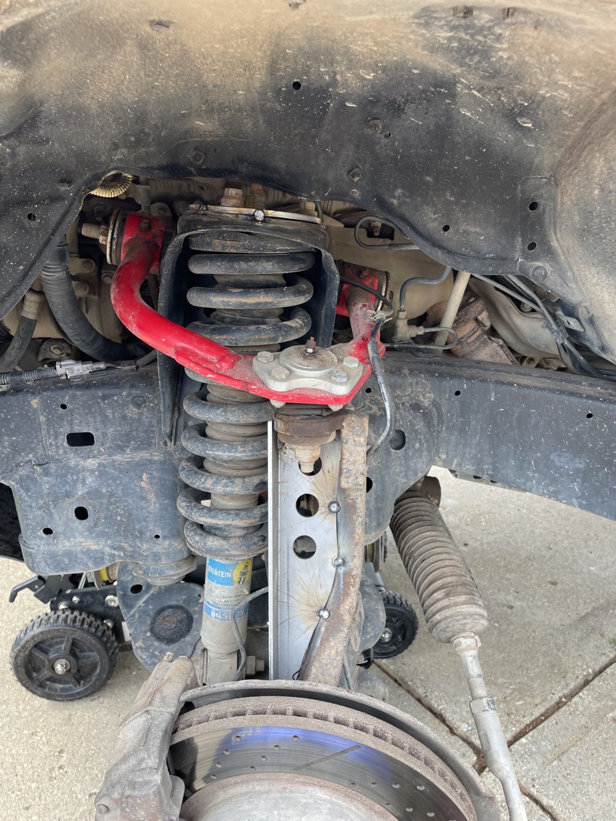

    I also welded in spindle gussets and Eimkeith STR plates. I saw a guys FGT sitting in the boonies with a broken spindle. That looks like a PAIN to fix. Further reading shows that the first gen tacomas break spindles pretty routinely (I think the guys on TW bash their trucks a lot harder than us.)

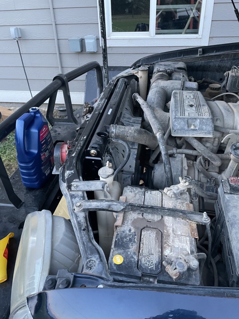

    me and my dad @Rigger got a new denso radiator swapped in.
