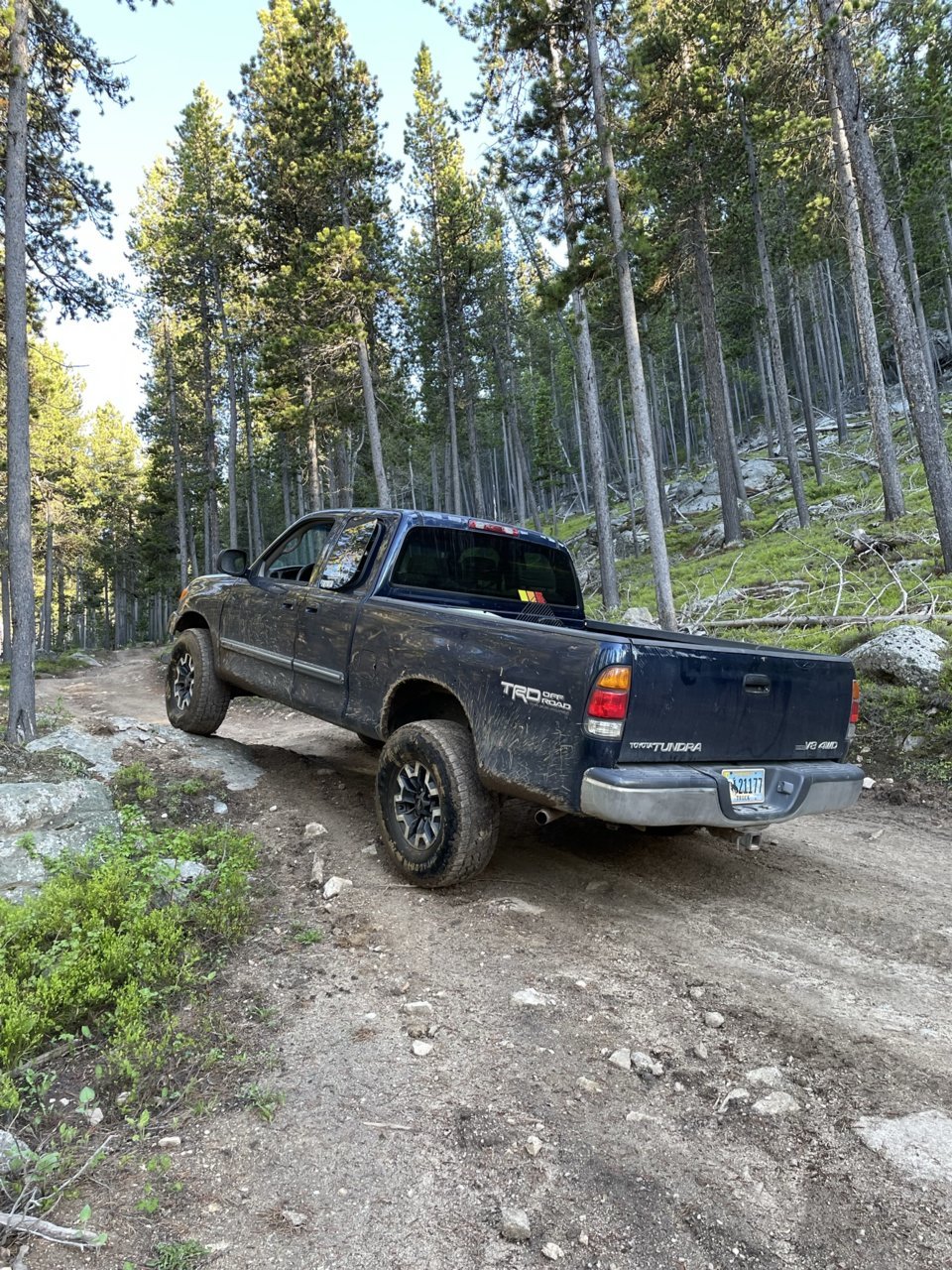

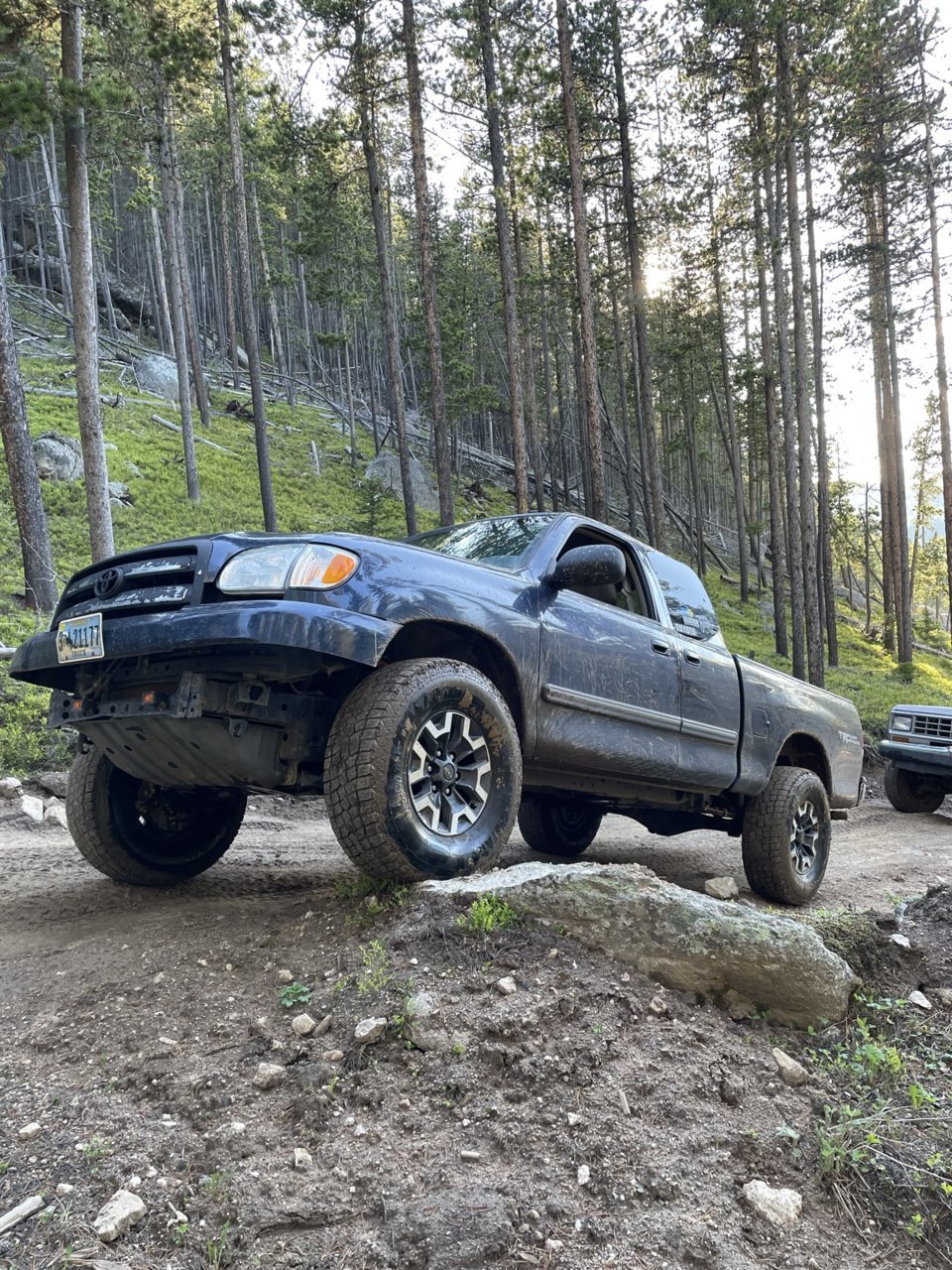

    A few pictures from some recent wheeling trips, still a little muddy and wet in the bighorns:

    This truck has such a cool back story and just continues to deliver smiles. Nice going!

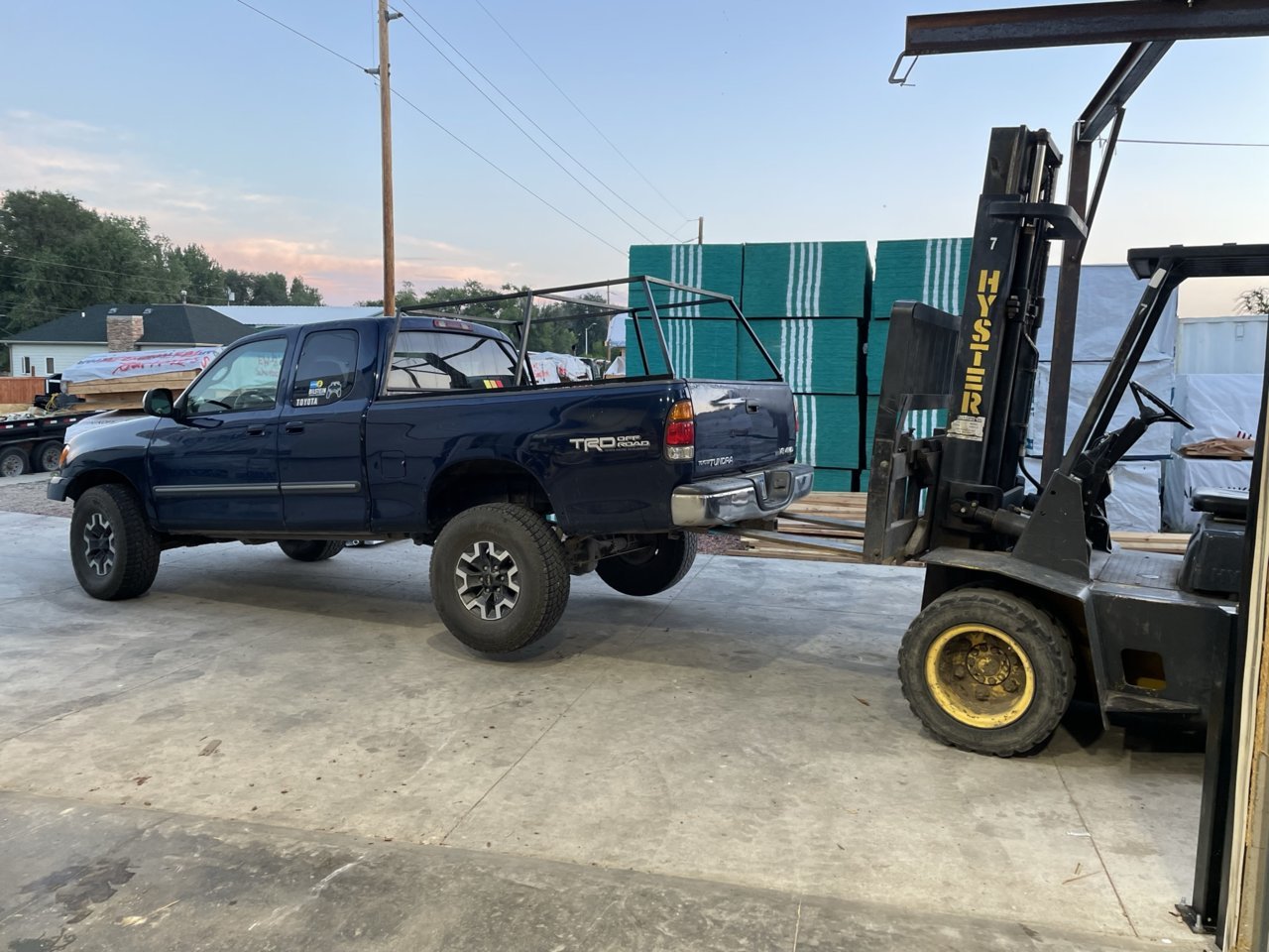

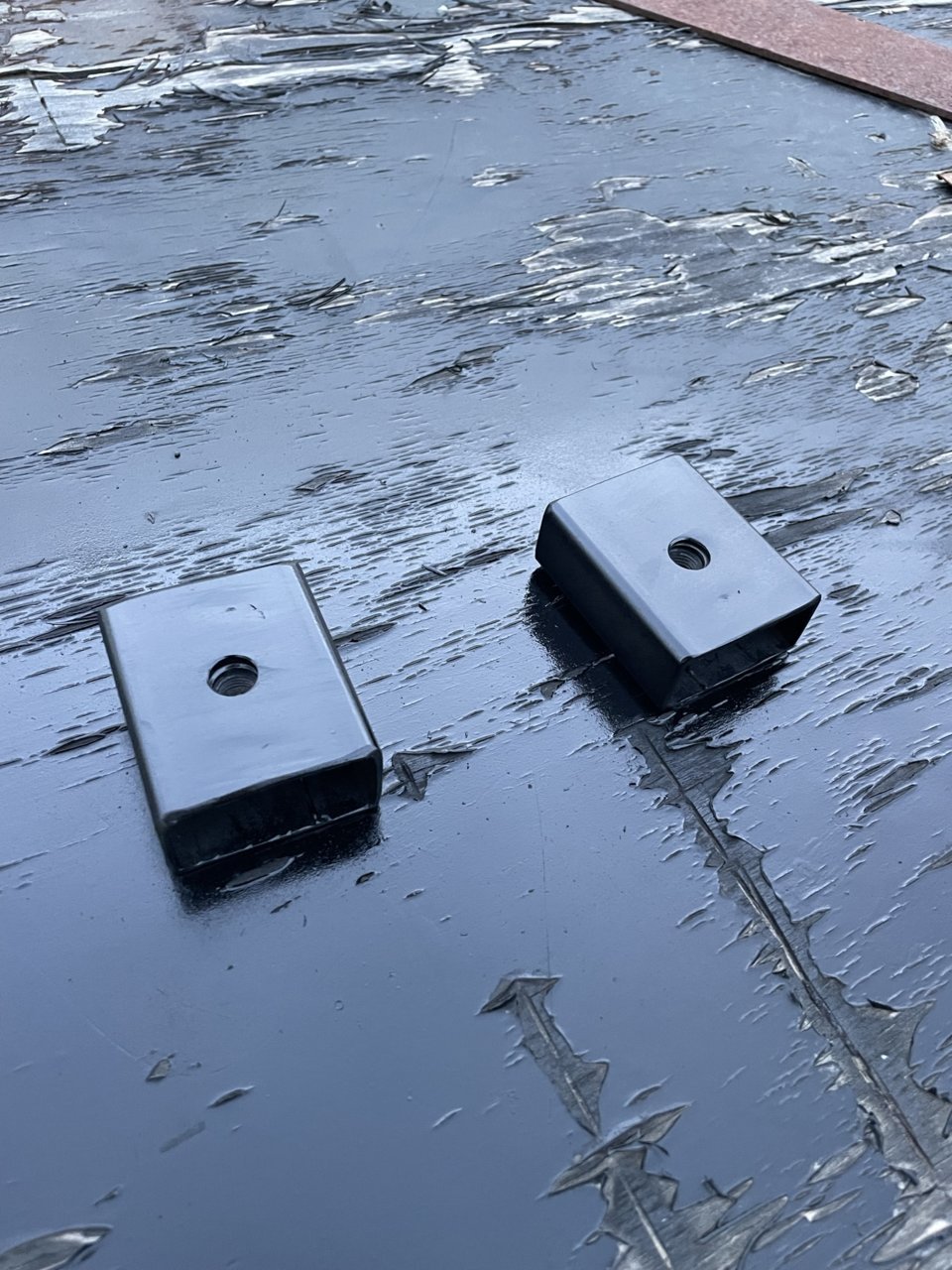

    Alright guys, here is an update to my thread that may contain some good conversation material.
    I built this rack for my truck, welded it up over 4th of July weekend. the rack needs some small changes, but my vision is a softopper style rack that I can also put cargo on top of. eventually it will get a composite roof with prinsu style extrusions for load securing as well as canvas roll-up sides.
    dont ask what im working on here...:annoyed:
    I installed these tailgate bushings from Ryan Miller on facebook. super high quality product. nylon bushings and TPU bumpers. made my tailgate feel a whole lot better.

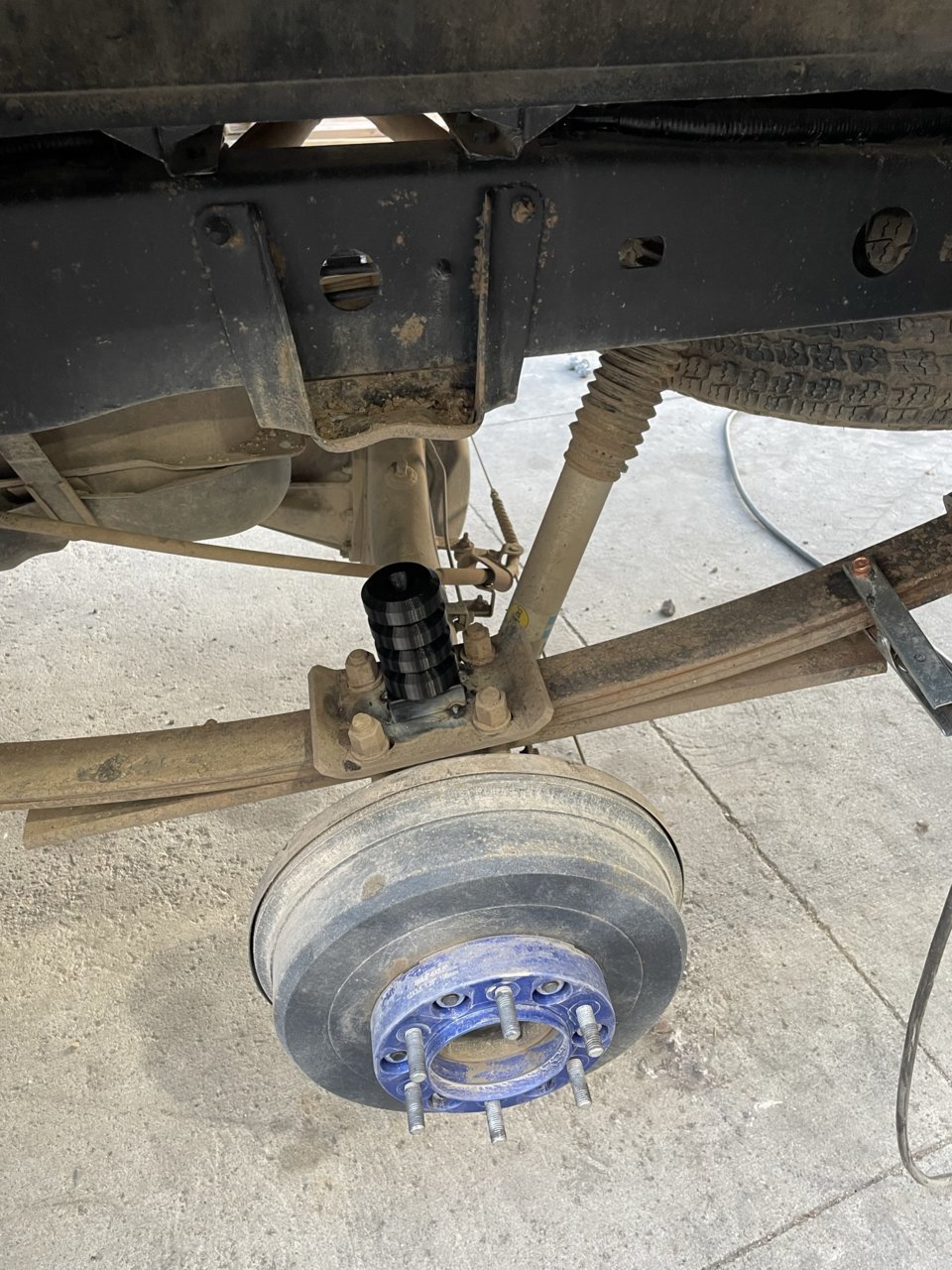

    Next I welded up these rear bumpstop mounts, it will become more clear how they work in a minute. they are a m10-1.25 thread to match the front bumps.
    easiest way to jack up a truck:)
    Here are my bumpstops. they are 3d printed out of tpu. it is my design.
    all of the aftermarket options are at least in the $100-$150 range for a pair. Some are close to $250. it can be done for much cheaper than that. all of the options on the market are extremely un-engineered (aside from maybe one) Time will tell where this goes.

    Looking good, Reese!

    Which ubolt flip are you using? Consider making a whole kit with the ubolts, top plate and progressive bump stops. I like your design, similar to the Timbrens.

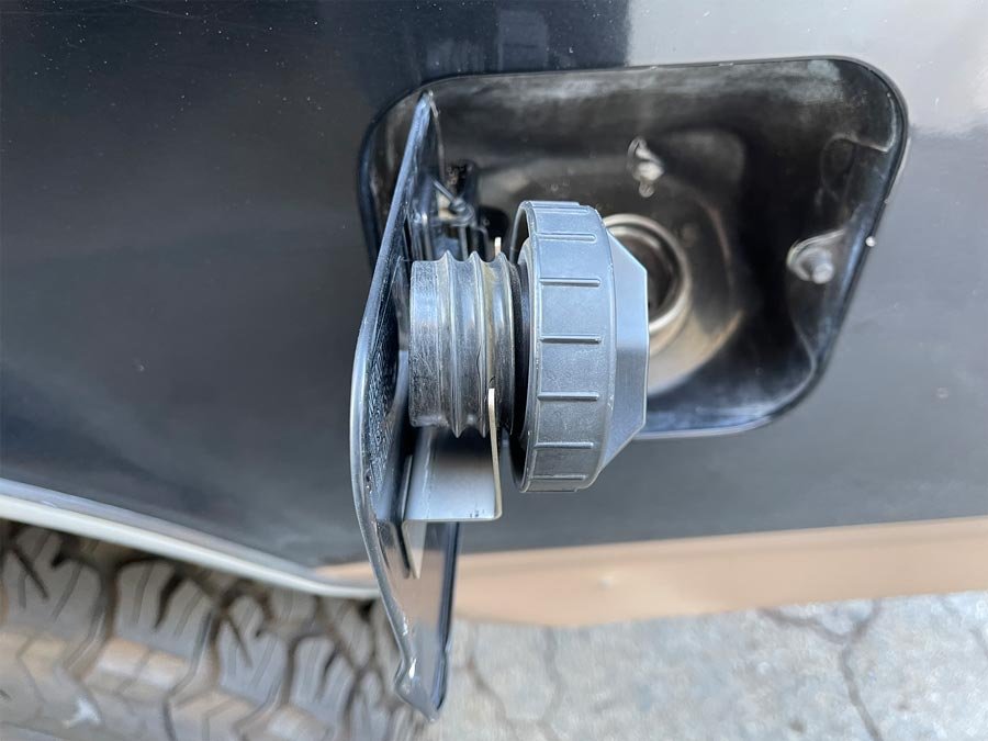

    Huh. That's something I was thinking about doing also. At the moment, I just sling the cap's tether over the latch on the door.

    Does the MESO gas hole work? I could try it.

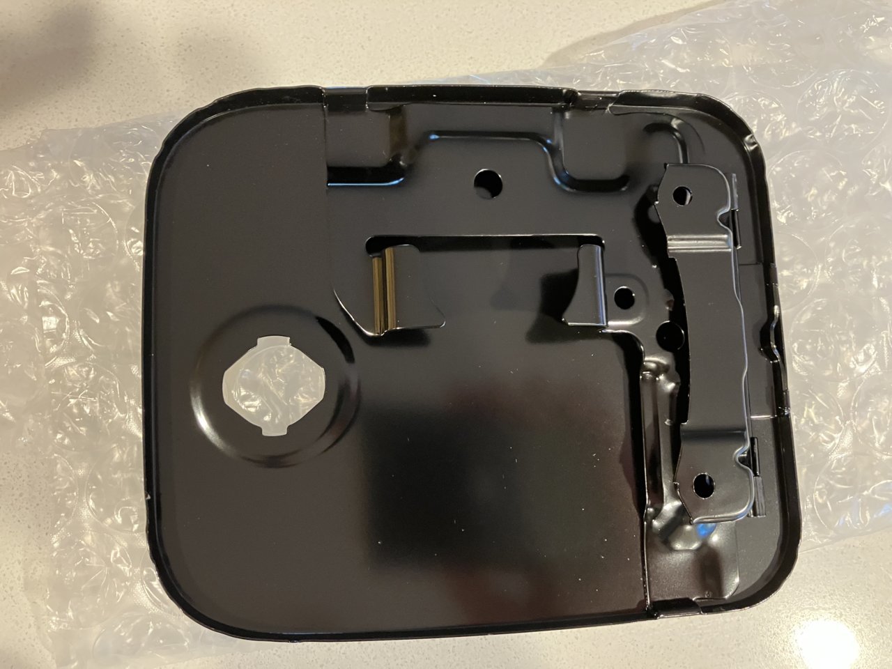

    I was thinking more along the lines of making a bracket that let you drop the cap into the back of the door like most modern cars do, and the SOLO Motorsports one:
  19. Aug 26, 2023 at 6:35 PM
    #139
    daveeasa
    Dec 2, 2020
    #55605
    4,192
    David
    So you prefer to place it on the cradle rather than stuffing it in the hole?

    And your keyless gas cap does not have an integrated holder? Like the keyed ones do?

    I'll doublecheck again tomorrow, but I'm pretty sure it doesn't.

    definitely something to consider. the ubolt flip is from ruffstuff. sweet kit, super stout and affordable. I had to clearance the spring perches slightly with a flap wheel.

    my non-locking cap does not have a cradle or a hole

    I’d be game to trade the new 2nd one I bought for a non locking. But I doubt anyone wants to have a hole in their door and pay to paint it.

    Looks like you may be able to bend the tabs out and swap the hinge assembly... which includes the holder.

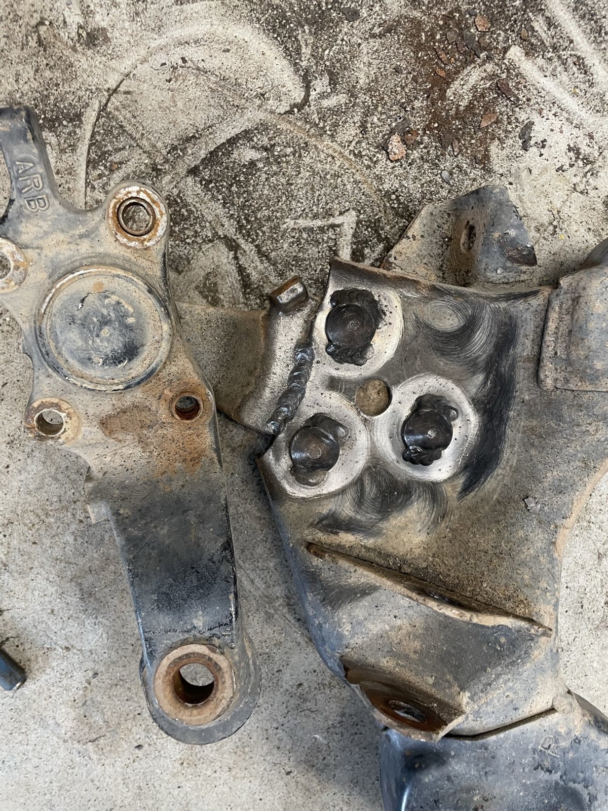

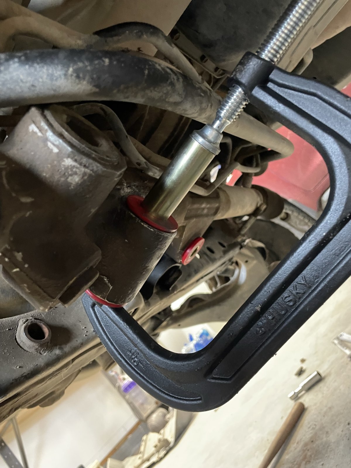

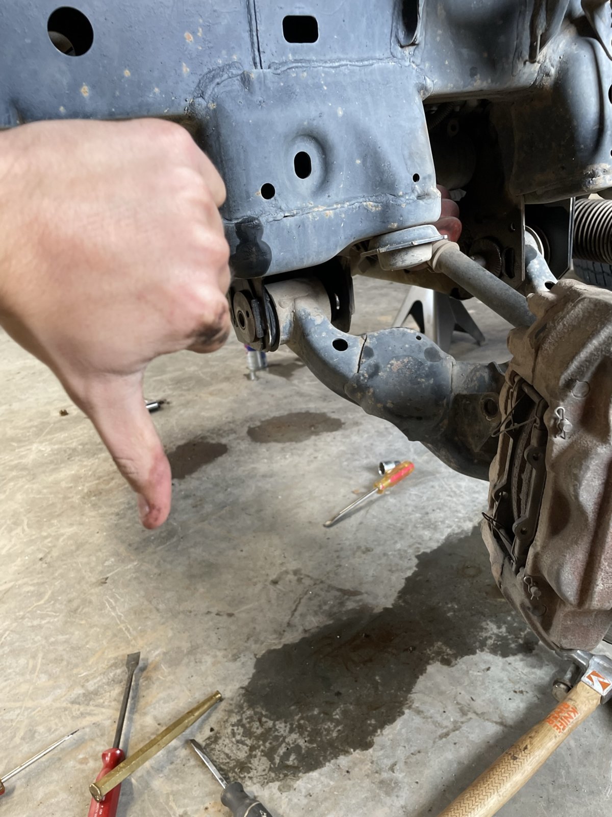

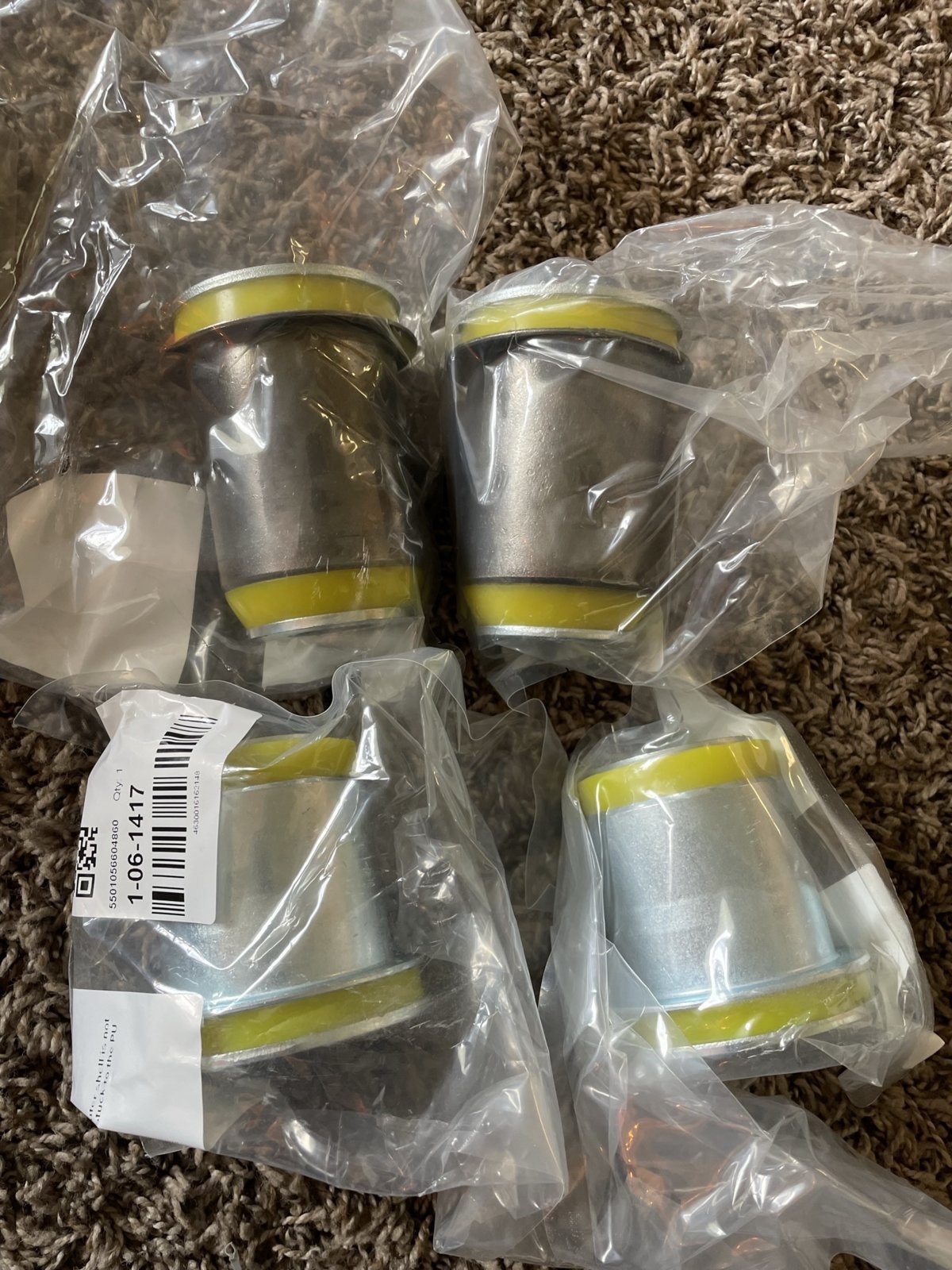

    alright guys, yet another update.
    on the docket for this round of wrenching is:
    • lower control arm bushings (I used siberian bushings)
    • coilover top hat (these are from wheelers offroad)
    • energy suspension steering rack bushings
    • no name outer tie rod ends
    • alignment cams (unplanned)
    a word of caution to guys planning on doing lower control arm bushings. BUY NEW ALIGNMENT SLEEVES. I really had faith that mine would come out, my truck really isnt that rusty and had been aligned recently, so I knew they would move. no dice. these things were FROZEN. i was in a pinch and i had to replace these with the SPC 25445 kit. i saved my old hardware so that i can buy new sleeves and replace with OEM later
    :annoyed:
    72003848836__BBF42569-BA9E-4460-83A9-9D9F7CA41529.jpg 71960725340__22D4668E-ADDA-48AC-877B-AFAC6702B179.jpg IMG_5205.jpg
    Ive seen guys say that these rivets on the lower arm can fatigue and loosen, I threw some welds on there. helpful? maybe.
    a 6" c clamp helps a lot with the steering rack bushings.
    a tip for installing these things: let the bushings sit in the freezer for a couple hours, and heat the control arm with a torch. I was able to beat them in with a heavy mallet, no press needed.
    the truck is a much more acceptable height now, I got rid of the big spacer above the shock and bumped the bilstein 5100 circlip up to notch #2. no more squat:thumbsup:

    How hard was it to find the Siberian bushings? I've heard mixed things.
