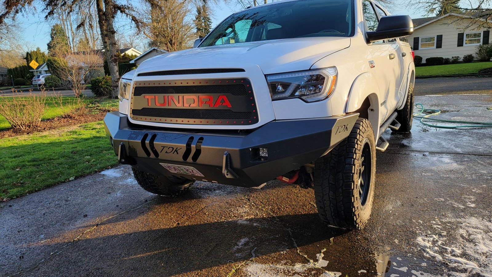

    I did the Sequoia LED conversion on my 2012. Prior to that I had replaced the OEM bulbs with Pella bulbs.

    That looks awesome man !
