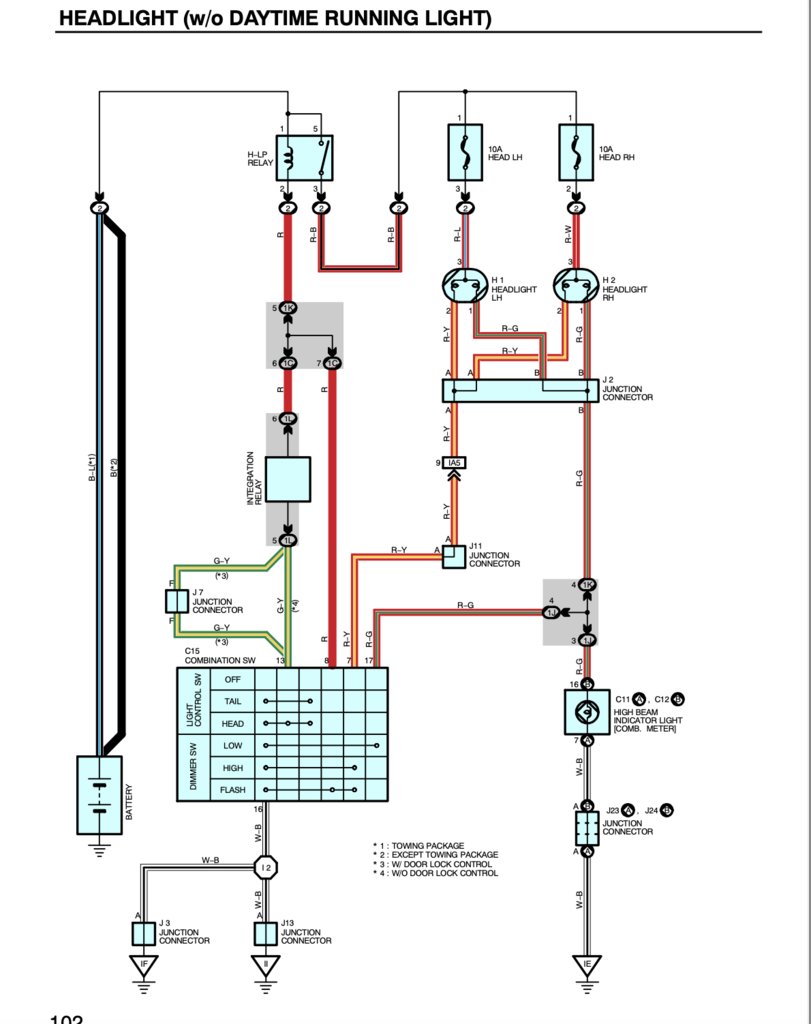

    Hi Yall! I've recently been having an issue with my low beam headlights constantly staying on even with the truck off, and I am at a bit of a loss as to what the problem is.
    Preface: I got back from a trip where my truck (2003 Tundra AC) was sitting in a parking lot for 10 days, and when I went to start it the battery was dead. After jumping, I noticed the low beams were on, even though the headlight switch was off. the lights have been staying on, regardless of what position the combination switch is in and whether the truck is on or off. (my truck does NOT have DRL's)
    I replaced the combo switch initially thinking that was the issue, but that did not solve the problem. Everything else related to the switch, including the fog lights, turn signals, high beams and dash lights work normally.
    When I unplug the switch, the low beams do turn off, but the high beam indicator on my dash turns on and stays on even with the truck off.
    when I plug the combo switch back in with the truck off, the headlight relay clicks and the low beams immediately turn on again, and the high beam indicator turns off. If I unplug the relay, the low beams will also turn off along with the high beam indicator, and plugging the relay back in immediately causes them to turn on again.
    Curiously, if I turn the high beams on with the combination switch and the truck off, the low beams turn off and the high beam indicator turns back on, but the high beams themselves don't turn on.
    I'm not very experienced with car electronics, and was hoping someone could help me out with diagnosing what might be wrong. I've done some poking around with a multimeter, and thus far have tested resistance on all the grounds for the combo switch and gauge cluster (all of which were good). I also tested the red/grn wire for the high beam indicator from both the combo switch plug and the gauge cluster plug and noticed it is getting 12v when the truck is off. That's as far as I've gotten so far. I included the wiring diagram i found online and have been referencing. Any help would be greatly appreciated, thanks!

    If you followed the link @NickB_01TRD posted above, you'll see that Toyota calls the interior fuse box and the back side the "Driver Side J/B and Integration Relay"
    Just head scratcher comment....when you had the combo switch and gauge cluster(Combination Meter) unplugged, that should eliminate anything doing with TVIP alarm system.....should.
    Good test....if you don't mind doing that again and with combo switch and Combination Meter unplugged, then unplug both LH and RH head lights. With your volt ohm meter set to ohms(continuity test), I'd like to know if any of those conductors are showing a short to ground. Semi simple test instead of the Integration Relay removal just yet....pain in the ass but doable.
    Place meter lead to a ground(GND) close to either LH or RH head light plugs.
    LH side....one lead to good GND and other lead to LH plug Red/Yel pin 2.....short to ground ?
    one lead to good GND and other lead to LH plug Red/Grn pin 1....short to ground ?
    RH side

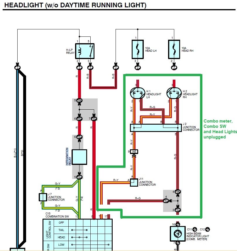

    @BubbaW Sorry for the delayed response, it's been a busy week. Here's what I have:
    With the combo switch and meter unplugged and my multimeter set to ohms on the setting where it will beep, both pin 2 (Red/Yel) and pin 1 (Red/Grn) show no short to ground on both headlight plugs. When the combo switch is plugged in however, pin 1 (Red/Grn) will cause the voltmeter to beep (short to ground?) on both headlight plugs.

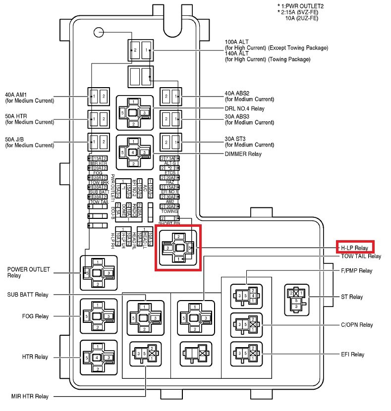

    When time permits, remove the head light relay in engine bay for bench test and note from pic below the pins 3 and 5 location(H-LP relay contacts). Would like to see if their is any continuity between 3 and 5 on the bench suggesting welded/dirty contacts or such. While relay is out, check the relay socket for voltage with key out of IGN, combo switch in normal off position....with neg lead of meter to relay socket pin 2 and pos lead to relay socket pin 1, any voltage ?
    Agree with what others have mentioned, not only is the Integration Relay/Fuse box a suspect, I personally feel there's at least another gremlin. Want to eliminate a possible bad relay with above request.
