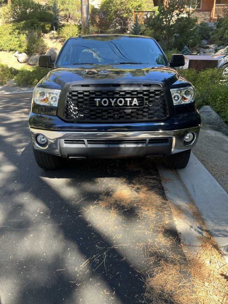

    Got after the lightly oxidized headlight buckets on my 07 SR5. Turned out pretty well, even though the Meguiar's cleaner & polish is kind of old...looks much better.

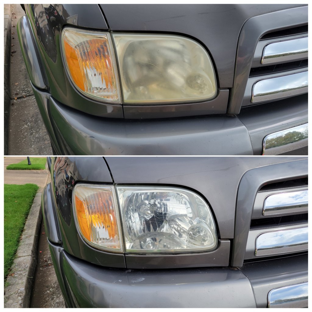

    I’ll 3rd or 4th the cerakote kit. Did mine almost a year ago and still look great
  7. Aug 27, 2024 at 5:12 PM
    KNABORES
    KNABORES Sarcasm incoming
    Jan 1, 2020
    #40572
    14,683
    Arkansas
    Before:
    After:
    One year later:

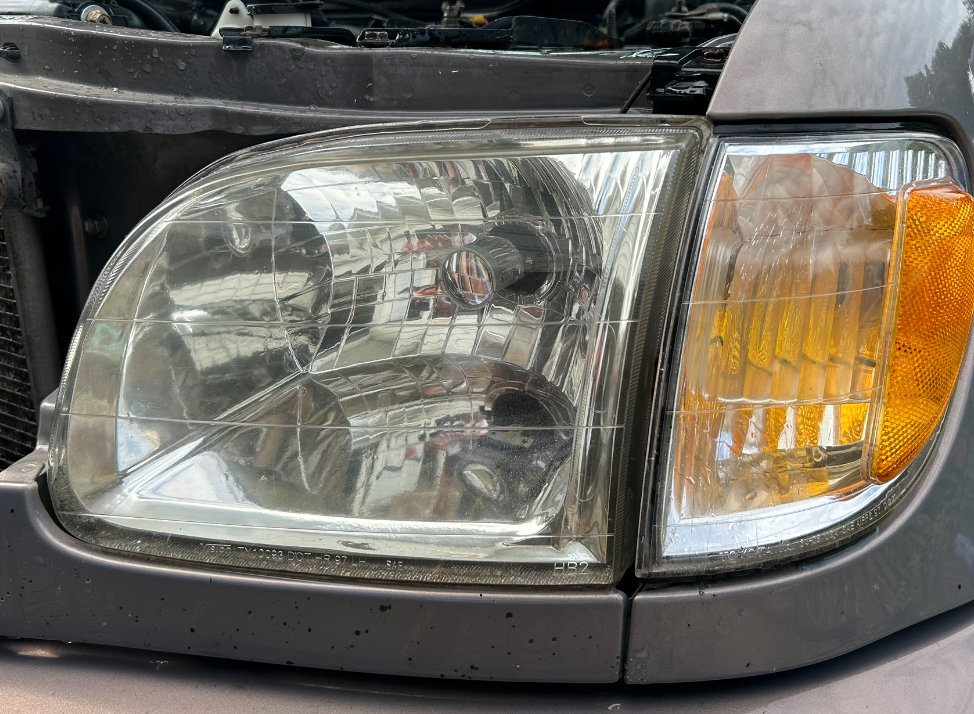

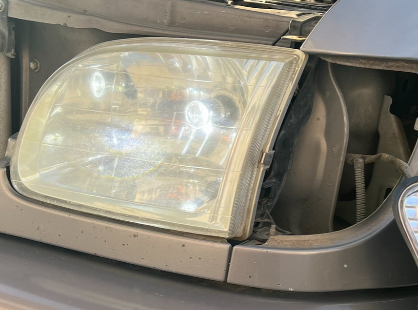

    Menzerna 400 and a wool pad on buffer , maybe 2-3 minutes per light
