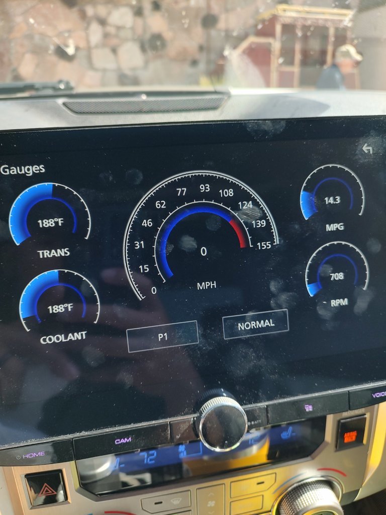

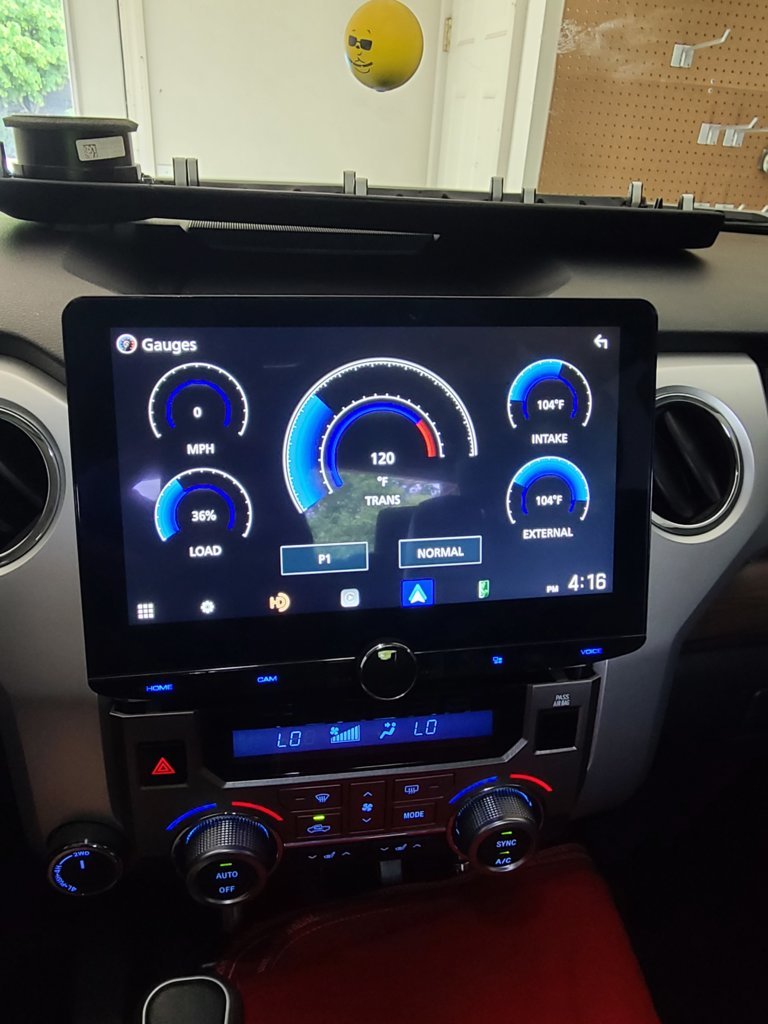

    Are the rest of the gauges working on your HU currently? If they are, you should be able to press & hold down one of the gauges. This will open a list of all the items you can display, with the transmission temp being one of them.
  5. Mar 1, 2025 at 10:39 AM
    #35
    20manny1996
    20manny1996 New Member
    Aug 9, 2023
    #101815
    65
    Manuel (Manny)
    2017 Limited Super White CrewMax
    My current set-up. Excuse the dust.

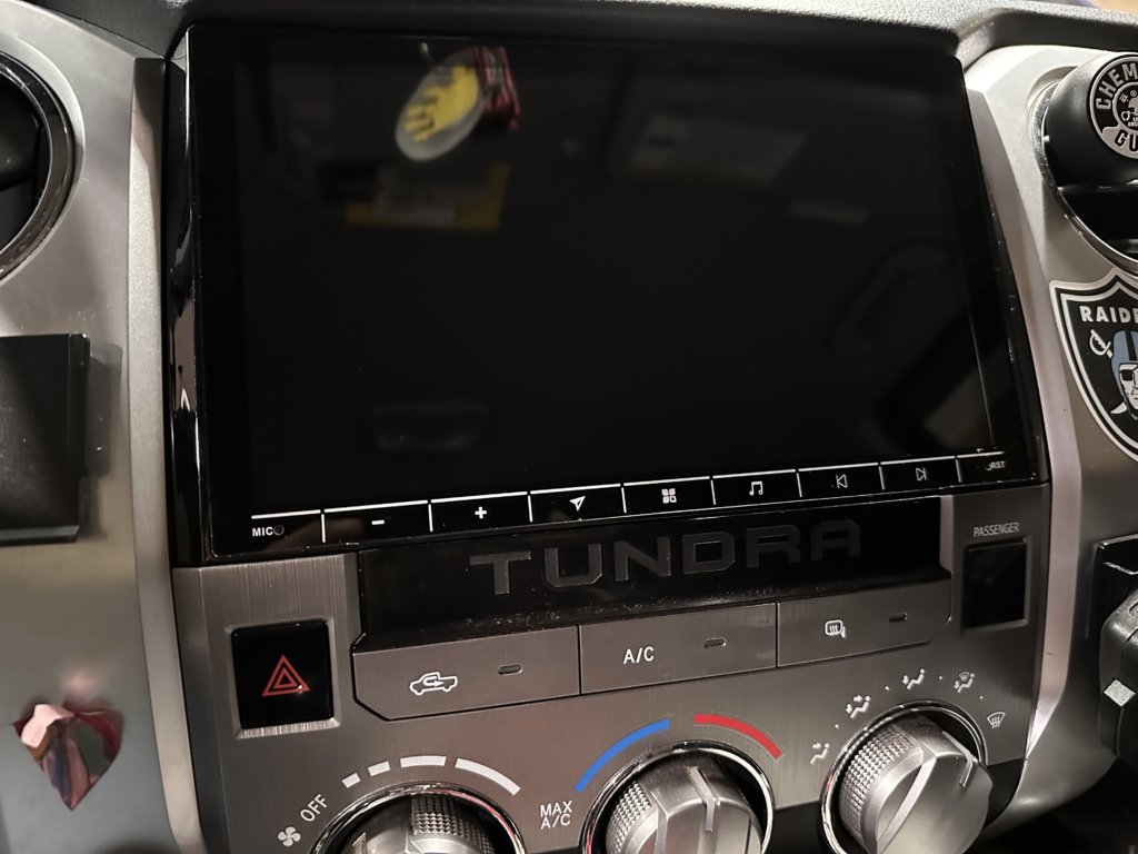

    Installed my new unit today, very pleased with the outcome. Took a little time to make sure that everything was hooked up correctly as well as running the GPS antenna through the dash to the right in the corner by the windshield. Still have to play around with the new unit to figure out all the functions. Way different than the stock radio for sure.

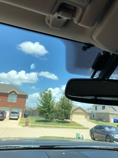

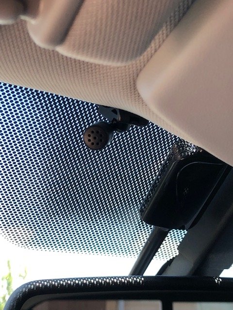

    You need to use the Kenwood mic.
    Just run it up the pillar and put it by the mirror. you won't notice it.
    It is easier if you remove the driver's side dash panel speaker cover and speaker to run the wires.
