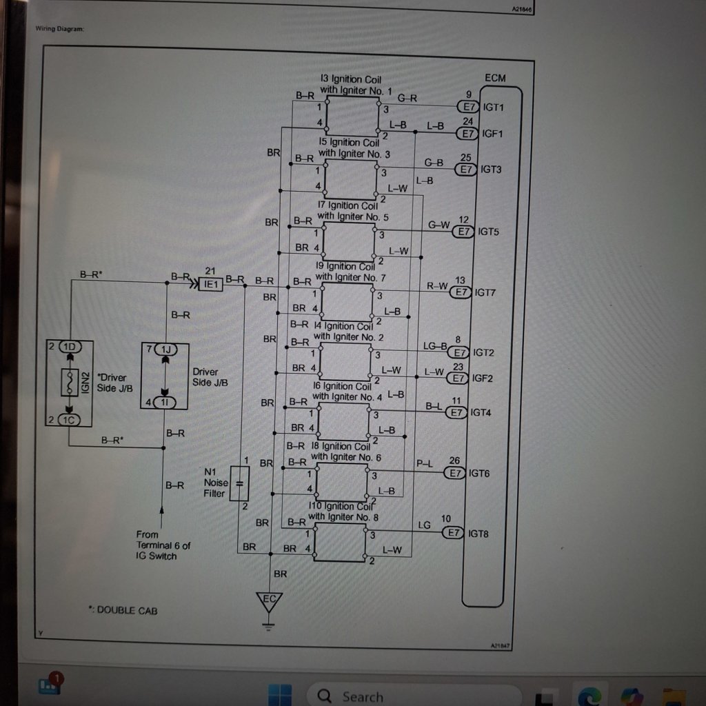

    When it comes to possible electrical issues and due to different ground locations, it helps if you add either Access Cab(AC) or Double Cab(DC) to your profile. Even tho we know it's a 2UZ(V8), it wouldn't hurt to add that also for next time you might need assistance.
    As for possible AC ground problem, all 8 coils meet at splice point E5, which is then connected to ground point EC
    As for possible DC ground problem, all 8 coils meet at splice point E2, which is then connected to ground point EC
    Possible ground problem but slim chance.
    Attached an AC and DC pdf....

    Beat me to it. Man it isn't easy searching through the FSM to find the grounding diagram.

    Yeah, it's even harder when one doesn't have a 2004 FSM. For electrical, the EWD's do a better job with possible ground issue circuit hunting.

    Correct me if I'm wrong. The brow is the ground to the coils? Could i run a ground from the coil to the ground on the firewall to if there's ground issue

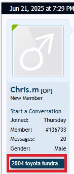

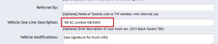

    I think what Bubba may be getting at is this.
    We want to help you. But all we see when trying to help you, on every post you make, or every new thread is this (more info below, after this pic)
    We assume if you're on a Tundras forum, your 2004 is a Tundra. We assume also if it's a Toyota, because nobody else makes a Tundra.
    If you could go HERE, and update the "Vehicle One-Line Description" field to something more descriptive - which includes your cab type (AC, RC, or DC), your engine type (V8 or V6), and the drivetrain (2WD / 4WD) it would help others here tremendously when trying to give you better, pointed advice.
    Don't forget to click the "SAVE" button at the bottom of that screen after updating.
    Here's an example of my truck's info, I'm letting people know the year, the cab type, which Trim level it is (Limited, yours may be SR5, or X-SP), and the engine/drivetrain type - this way, anyone can look at the FSM or an electrical diagram and immediately point me to the correct info for my truck. Because, understandably so, the wiring harnesses for 2WD differ from those of 4WD. Likewise, DC truck harnesses differ from what you'll find in an AC and even from an RC.

    Just realized I forgot to add my example. We could really use to see the V8/4WD if that's what you got.

    You could but what I meant to add earlier is that if you have a volt ohm meter, you could unplug all coils and measure Pin 1 brown of any of the suspect coils to ground. If you see a short to ground, then that coil has no ground problem.

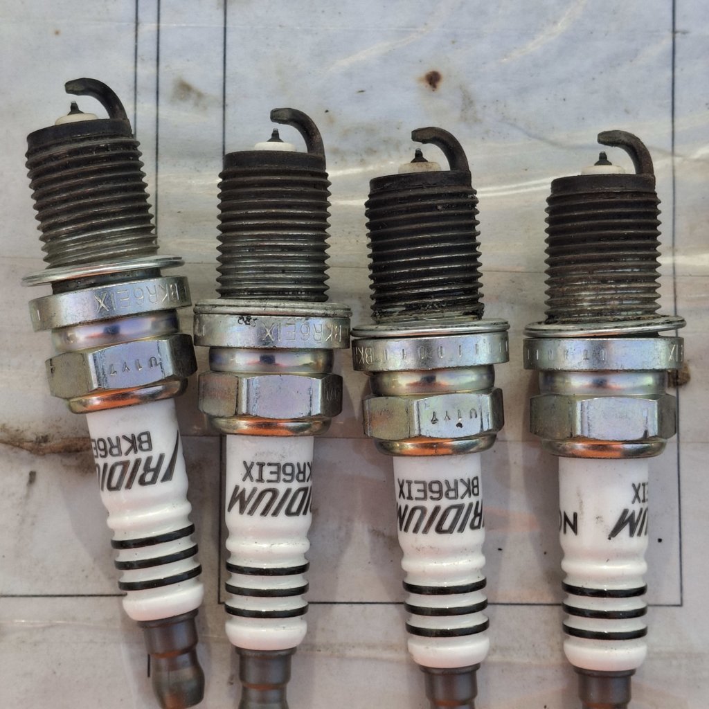

    I don't remember what either four came off of but I think there pretty clean for 200,000 miles. So your saying set it to ohms touch the brown with probe and touch a ground with the other probe.
    No I haven't checked the timing yet

    The other 4

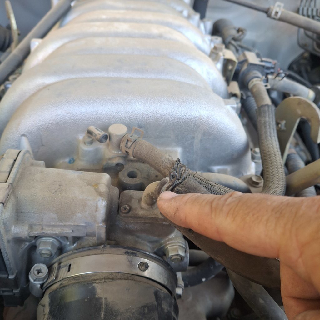

    Quick Q should I remove this and clean the inside. I noticed all the oil around it. That hose goes to the pcv valve

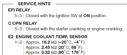

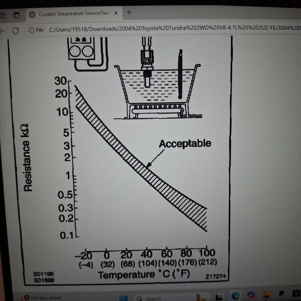

    I tested the ohms on the coolent sensor and at sitting temp still in the engine its 1.
    I left the temp connector off and let it run for about a minute to warm the coolent. I took a reading at the radiator cap and the coolant was 98 temp on the intake where the sensor is read 101. I checked the ohms and it read 1.2 to 1.3. Should the ohms reading go down not up as it gets warm?

    Also is delphi just as good as denso or should I stick with denso?

    Keep in mind on your chart, the resistance reading is in K(1000) ohm.
    From 04 FSM....
