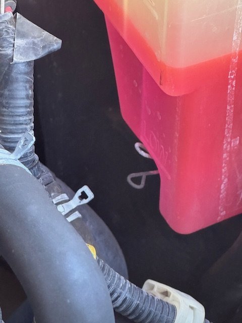

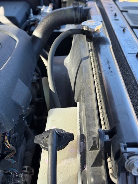

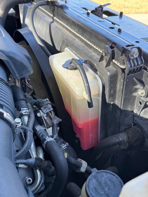

    I'm going to agree.
    Removing the contents of the coolant overflow tank would be a pretty easy job..
    The hose on the bottom connects to the radiator neck.
    Might be a little messy, but way cheaper than paying $120 an hour for a dealership to do it.
    upload_2025-2-16_14-19-5.jpg upload_2025-2-16_14-19-19.jpg upload_2025-2-16_14-19-32.jpg
    Not sure if the tank is easily removed from the fan shroud.
    It comes as one piece, kinda looks like it might be plastic riveted in place.
    Maybe remove the 2 bolts and lift the fan shroud out.
    2007-2022 Toyota Shroud Assembly 16711-0S011 | Sparks Parts
    I've seen them go for years and given new life..:eek2::cool:

    This is correct...and a different light blue.
