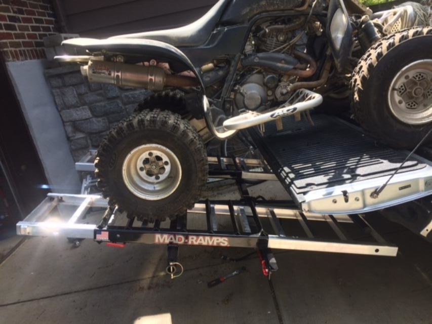

    Hey everyone. I owned a stock 2008 TRD double cab and I hauled 3 ATVs around for 2 years and never bottomed out. The 3 ATVs were loaded in this order. 90 (264lbs) 50 (210) 660 (426) total of 900lbs. I use MAD RAMPS and the heavier ATV hangs off the back (see photo). This photo was taken on my 2008, should have taken one fully loaded on the new truck, next time:frusty:.
    I loaded them in my stock 2018 TRD double cab last weekend and was bottoming out numerous times driving the same route? It seems I'm going to have to make some modifications. I'm not really interested in lifting the vehicle but not opposed to it. I was thinking of adding airbags, but open to any other solutions. I know a trailer would resolve my problems, I don't have anywhere to store it though.
    Any thoughts would be appreciated, thanks

    Put the heavier one in the front, with it hanging off the back the ramps are acting as a lever of the rear axle. Moving the heavier weight forward should help.

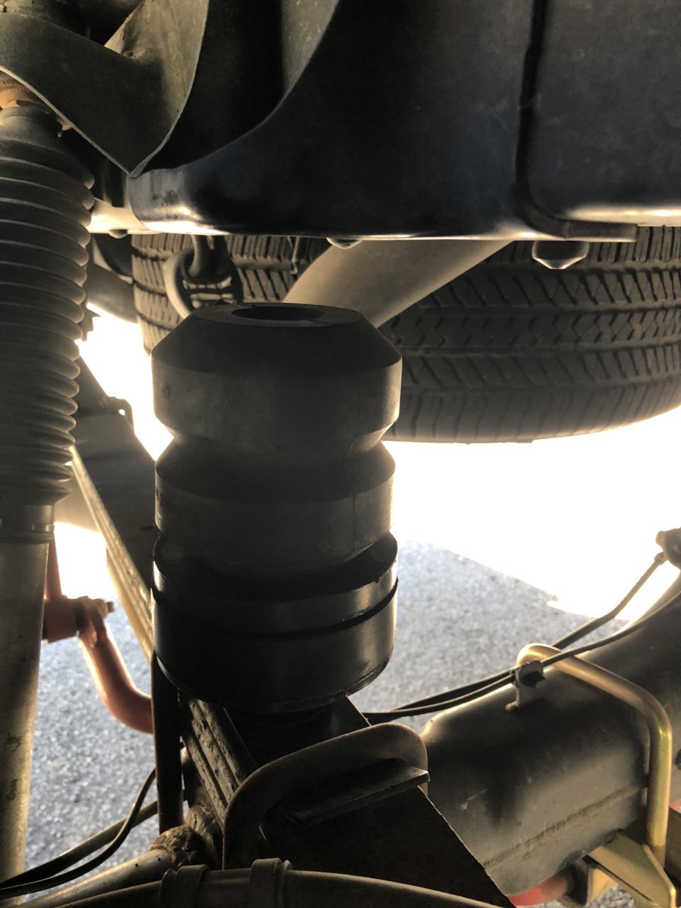

    That’s a pretty good solution I’m sort of doing for the occasional tow. No playing with air pressures and stock ride when not towing. I’d only get bags if I towed long distances several times per year, I’ve read people definitely feel those when empty. And if I was under constant load 365, I’d look into Alcans/Deavers or some type of add-a-leaf.
    What Sean means is Timbrens sit higher than Superbumps, so when not towing you don’t want to be smacking the Timbrens when hitting bumps/potholes. Switching in the SB’s allow more clearance while still offering bumpstop protection. It’s just one top bolt whereas stock bumpstops require changing out the whole foot, those 2 clamps each side.

    Not the same. The sumo springs are a micro cellular urethane, and the Timbrens are rubber. Many of my customers have complained that the Timbren was bouncy with out a load and the sumo springs soak up the bumps unloaded. Both are used in the same fashion just not the same product.

    If you get shackles, you will need spacers to make up the clearance. Then skip Superbumps altogether and remove the spacers when not towing, unless you off-road and anticipate hitting the lower Timbrens.
    I think I went Timbrens over Sumos because a spacer setup was special order from overseas at the time for Sumos. It also didn’t look as easy doing the switch out when not towing.

    Loaded makes all the difference in the world. 2 months ago I had to haul (40) 6x4x12 solid concrete blocks, used them to place a shed on in my back yard. The truck squatted maybe an inch, never bottomed once, and felt very planted. I tow a 28' toyhauler regularly, 8k loaded.
    Agree with @Mike's Custom Toys , the Timbrens are rubber with a chamber design. The SumoSprings are urethane. The SumoSprings have a controlled compression and rebound. Rubber is bouncy, one of the main complaints I read about Timbrens. Timbrens also tend to give a very firm loaded ride, where the SumoSprings still allow for a certain amount of additional controlled compression. The biggest difference in the 2 materials is the rebound, throw a rubber ball on the ground, now through a foam ball on the ground.

    Are they easily removed if I wanted flex for off-roading. Is there something smaller that can be put in their place like a normal bump stop?
  17. Oct 23, 2018 at 11:01 AM
    OBXTundra
    OBXTundra Member
    Aug 30, 2017
    #9337
    946
    Southeast USA
    2018 Nissan Armada, 4x4
    They thread onto their mounting base. Looks like an 8mm bolt on the plate. You can unthread the SumoSprings while leaving the bracket on the truck. I'm not sure what you would thread back in their place though.
