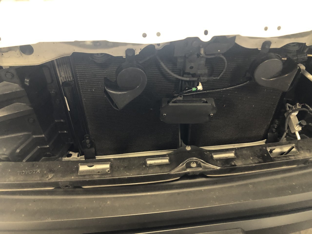

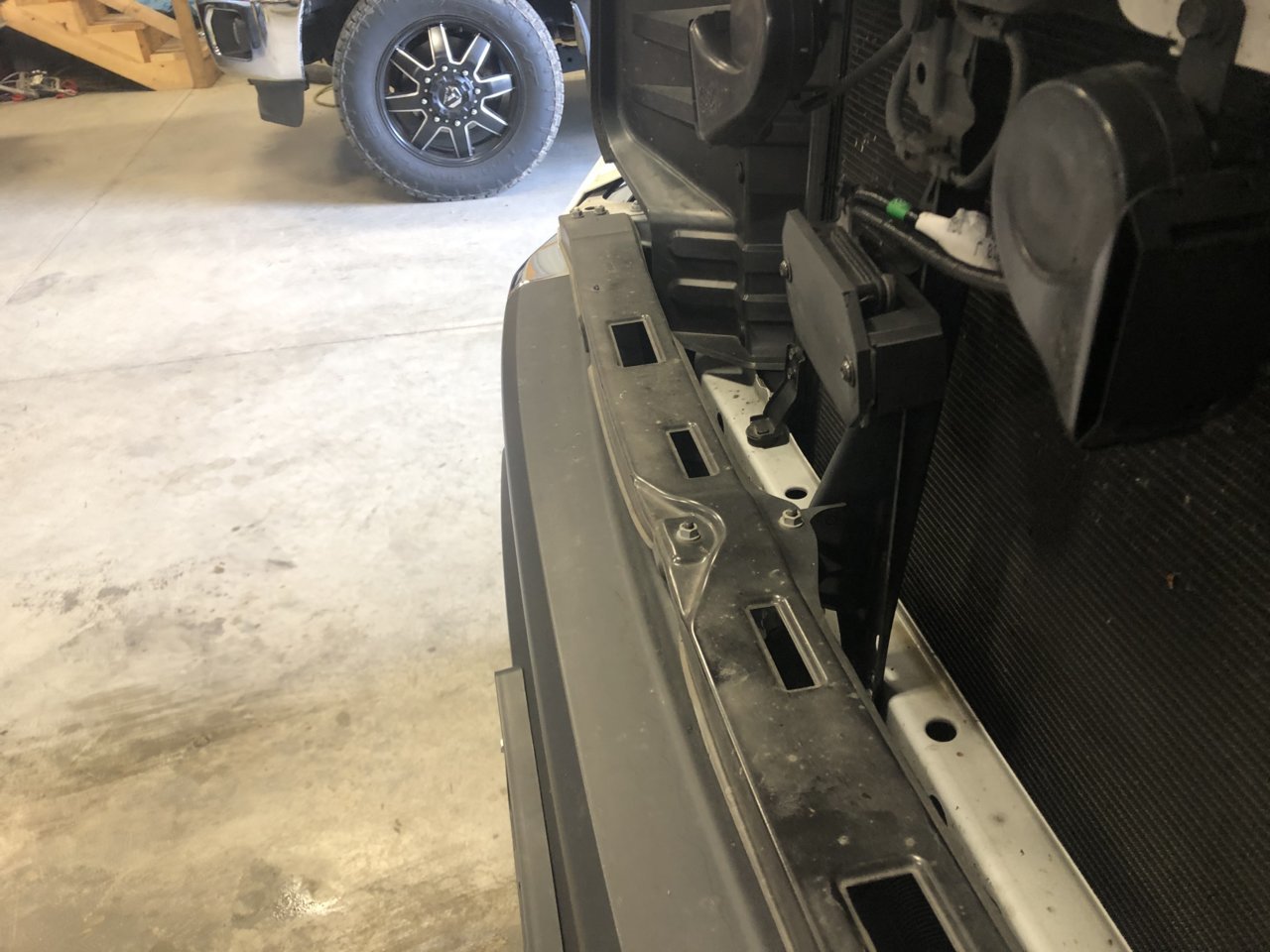

  6. Apr 30, 2020 at 3:57 PM
    #36
    Yota52
    Yota52 New Member
    Apr 30, 2020
    #45738
    2
    2019 White Tundra TRD
    Rough country leveling kit
    So I purchased this and it everything worked fine for about a mile down the road and then my pre-collision light came on and said to clean sensor. A little while later it turned off. This happens every time I go anywhere and I looked and saw that the bracket from AJT isn’t an exact fit when bolting it on the truck. Has anyone else had this happen? Trying to figure out what I could do differently to get it to line up where it should be. Any help would be appreciated.
  7. Apr 30, 2020 at 4:46 PM
    #37
    soobahru
    soobahru New Member
    Feb 21, 2015
    #987
    174
    2015 tundra 5.7L double cab 6.5ft 2019 tundra 5.7L limited crewmax
    Same happened to me and was thinking of using rubber washers sandwiched on the inside to see if it'll solve the issue.
    Happens one or twice a 30 minute drive. Also thinking of cleaning the sensor well before putting back together.

  10. May 1, 2020 at 5:05 AM
    #40
    Yota52
    Yota52 New Member
    Apr 30, 2020
    #45738
    2
    When I took it apart I cleaned the hell out of everything. My only concern with adding washers is the sensor itself getting loose. My bigger concern is the bracket itself. The more I tighten the nut the more it pulls the bracket towards the passenger side. I’m going to call AJT and see what they say but I’m not holding my breath since their instructions say not to call them if you have issues
    If they’re not helpful I’ll have to put a wedge in there or look into a different bracket.
