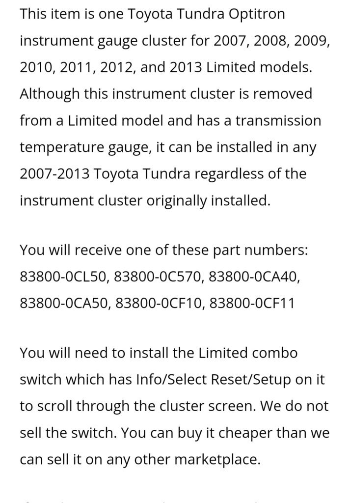

    I notice that the Sequoia clusters, although all being 2nd gen, have a wide array of pn#s. Can you get one from any 2nd gen?

    Did you happen to look at the part number on the one you got? Should start with 83800-0Cxxx
    From what I can tell Toyota does differentiate between flex and nonflex, flex ones will have K or Q designator in the second half depending on year. Seems they have different pn#s for Limited and Platinum as well which is surprising.
    I found an 83800-0CK30 I might take a stab at for $65.

    Just an FYI, I think it was some of the Limiteds with a rear air suspension had an additional indicator in the cluster to the left of the transmission temperature gauge. This may or may not matter to you. Back when I did my search, I was able to see pictures of the actual item being sold, so I was able to filter those out, so I have no idea what part number they were.

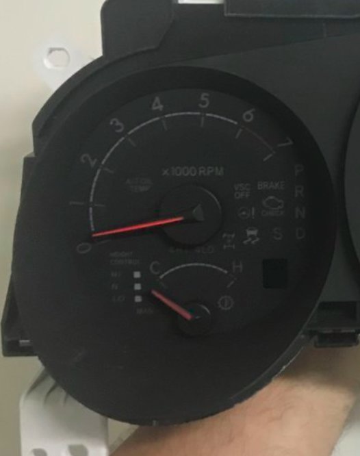

    I think the one I got has that, but none of it is visible through the tinted lens, and does not illuminate.

    Well, that's good to know. I would've bet dollars that it'd do something silly like illuminate all the lights because it wasn't getting some sort of signal from whatever system manages the air ride.

    Alright, it's in and working a treat. For reference I have a 2013 flex fuel, the cluster I got was from a 2013 Sequoia supposedly with flex fuel pn#83800-0CK30. I say that because I got it from an auto dismantler and I never saw the vehicle myself.
    For the EPS light I did not end up removing the LED. Once I had taken the needles off that side of the gauge I removed the overlay to find that each LED underneath has its own tiny cubby hole. So I just found a plug of rubber I had laying around, shaped it to the right size and stuffed it in the hole. No light getting out of there.
    The cluster I got does have the indicators for the air suspension but they seem to be inoperable which is fine.
