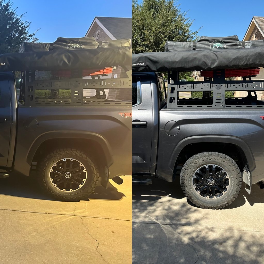

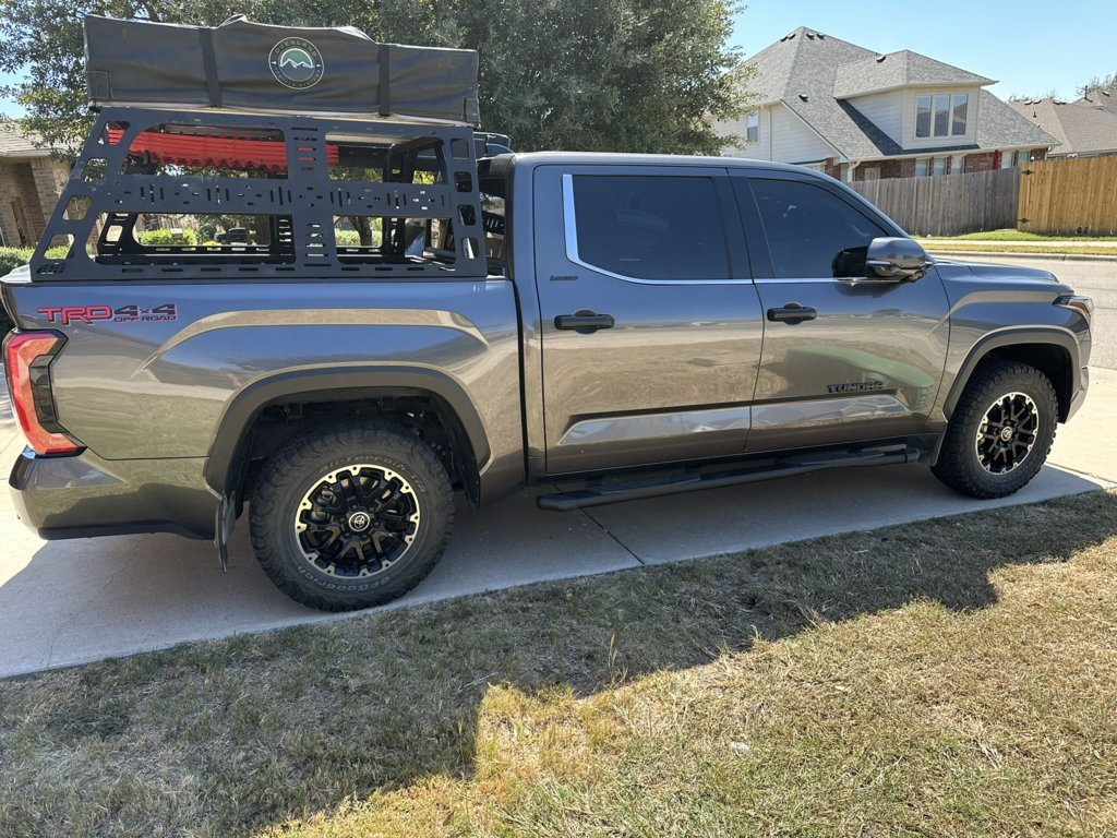

    I put a set of black on my 23 limited TRDOR. I have a Decked box with some tools and camping gear, a steel CBI bed rack, a folding soft cover roof top tent, and a 270 awning. At rest the SumoSprings are barely touching the axle. I haven't been off road with it yet, but can tell an improvement when hitting speedbumps, dips in road, etc. at speed. Less bounce and better support for the weight. I don't have a great before pic from the same angle but these are close. I did trade my 20s for the 18s as soon as I got back from Big Bend and got the SS about a week later.
    Before:
    After:
    Side by side, left is before right is after:

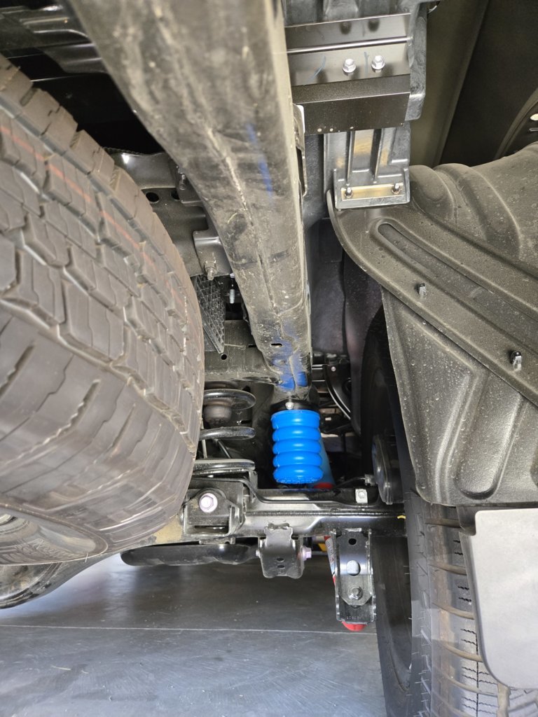

    @Raven67 you were right. Easy as pie. Printed instructions were wrong though, they say 14mm, it's actually 12mm ratchet/wrench needed. I didn't jack the truck up and didn't pull the wheels. No need!

    UPDATE: Blue Sumos did make a difference! No squat anymore. Ride loaded/unloaded essentially the same. I think the Sumos were a good call and I'm happy!

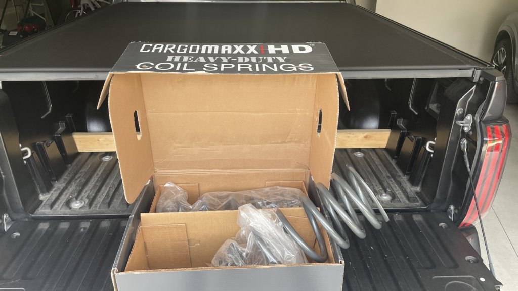

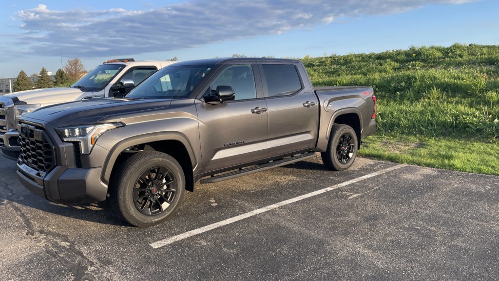

    Installing these this Friday… Dayton CargoMaxx HD Coil springs.
    Update:
    Installed and I don’t notice any unladen ride quality difference… picking up my camper this week so I’ll get to evaluate towing with the HD springs then.
    It did raise the RR end by 1” exactly. The extra rake isn’t crazy looking.

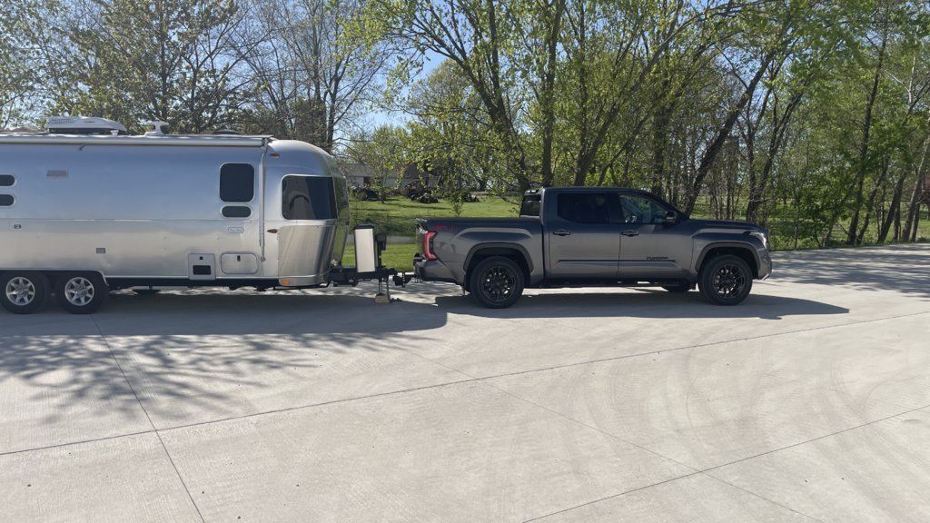

    My trailer tongue weight (dry) is 800 lbs on the dot. It used to severely sag the back and would level out with weight distribution. I added the CargoMaxx springs… and it now sets level by all accounts… before the WD is set. I will need lighter weight bars for the BlueOx WD to provide proper sway control… but what a difference in stance!
