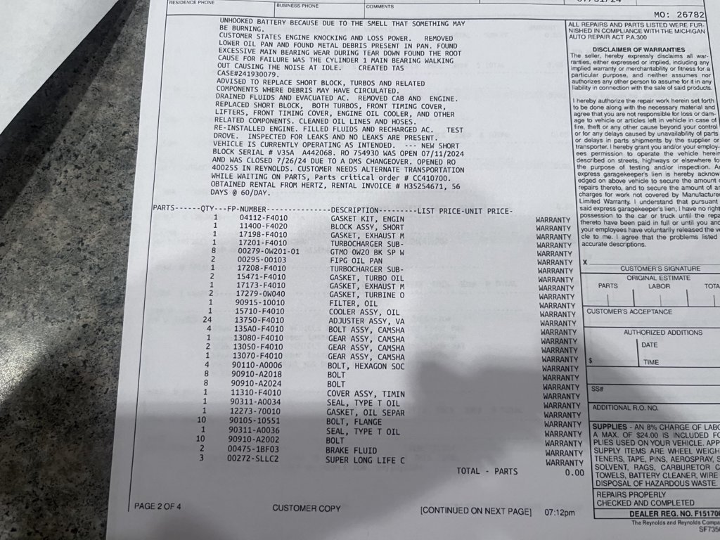

    Short block replacement update. 2022 with 26k miles that failed on the highway but was lucky enough to pull over before I was rear ended. Failure date 7.31.24. Short block replacement completed 9.20.24. Contacted Toyota care, service advisor, and service manager to stop the short block replacement before the full block option without success. My notice of the vehicle repairs being complete was a text from the service advisor that my rental would terminate end of day 9.20.24..

    I saw in another post that supposedly they're supposed to replace your short block again with the long block when it's available. Not sure if this is true or not, doesn't make much sense
