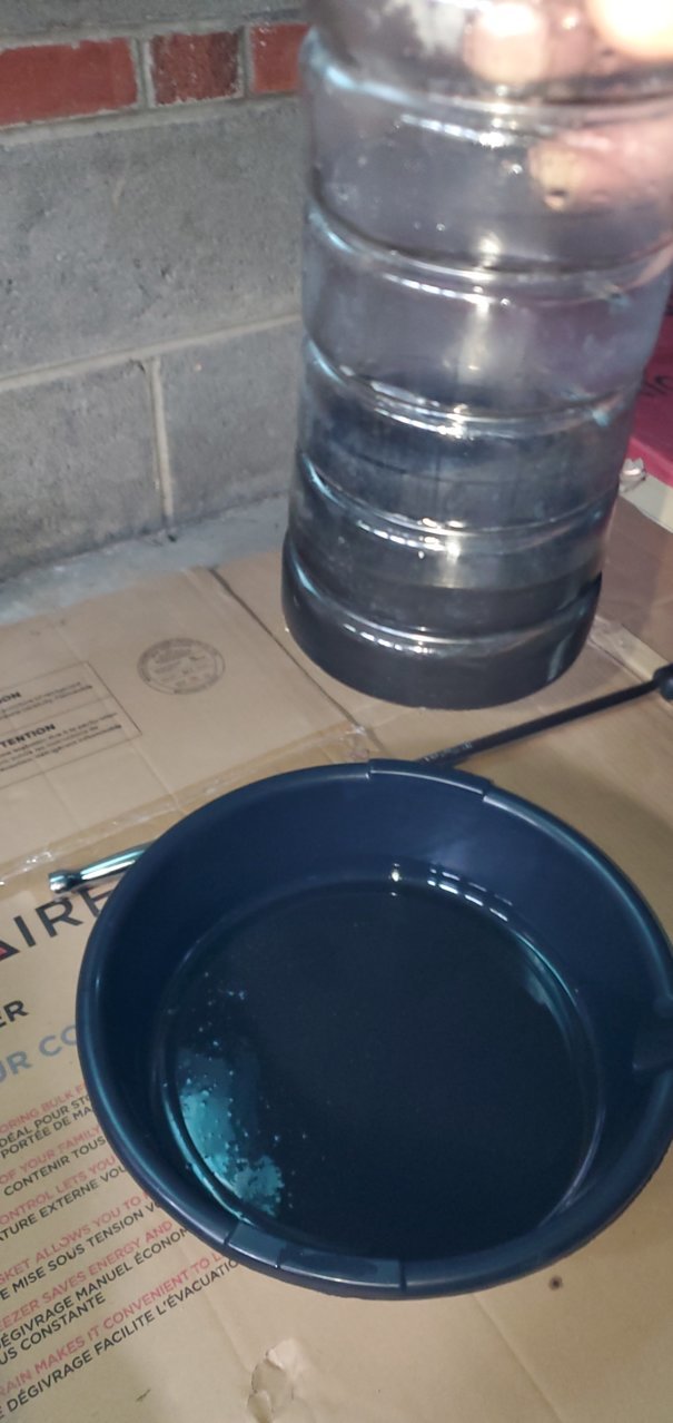

    Because everyone likes pictures, this is how much fluid I got out of the rear diff.

    She might've been a little thirsty.
    was the axle level when drained? Got a hole in the housing? Cause should be more like 3.5 qts.

    3.5 qts is about how much I put in afterwards. Housing is good, I suspect a bad axle seal. I need to check but will need the appropriate locking lug socket to pull off the wheels. Dealer was pretty indignant when I asked about him buying it back, guess I lost the game of hot potato. Now I need to find a shop that can inspect and possibly rebuild the rear end.
