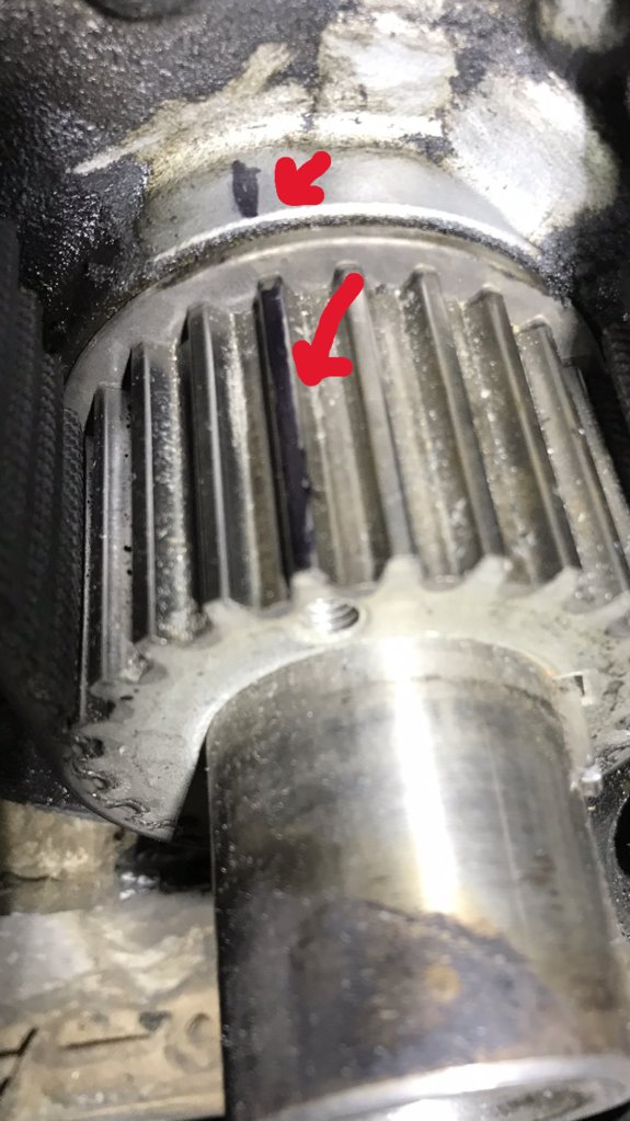

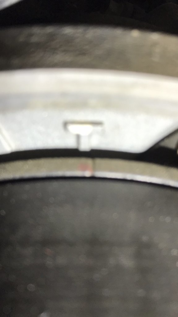

    here is pic of the cam timing mark thats barely off..

    You're on the wrong cam timing marks. Supposed to be on the vertical lines, not the "T."
    See here, here, and here.

    When doing the timing belt replacement, you can rotate the engine to 15° past top dead center to the T mark, which puts the cams in a spot where they won't want to rotate. I've done this on all three of the UZ timing belt jobs I've done, and it works great. However, the crankshaft must also be at 15° past TDC. If you timed the engine so the cams were at the T mark, but the engine was still at true TDC (0°), then your engine is out of time.

    THanks for reply. Yes thats what I did. I read where the T is for Timing..and yes mine kept jumping when using the line marks. I read the line marks are for just wanting to know TDC and for using after the belt is on to check for cams and crank lineups. So, I did what this mechanic did....line up two cams on T-mark, wiht a sharpie mark the a a gear on the crank cog and then make another mark on the housing.. heres my pic and he starts this process at around 26:00 min here
    So, i was going to replace the crank and cam seals.. So, line up the cams to T....then mark the crank cog with sharpie..remove crank cog and cam sprockets...replace respective seals...put cam sprockets back at T like they were and torque...and then torque crank cog back so that it lines up wiht sharpie marks.
    It all worked good, and THEN...after rotating belt using the crank...all three lined up on their respective marks...with just that one came being just barely off perfect. this is why I think its something else. Everything lined up good and I dont see how timing could force the revs to stop at 3000 rpms exactly..every time. If you google somethiong like "tundra wont rev past..." it will autofill with 3000. tundras and sequoias stopping dead at 3000 is a thing. its just that the two things mentioned were not a fix for me...the efi fuse 1 or 2. so im struggling with the timing being the issue...it may be in the end..but i reaaallly got to to exhaust all possibilites first...and if I did redo the timing iI dont know what I would do different..i followed the vid and it all looked good to me. some ppl said fuel filter...and it prob needs one, but that wouldn't make it stop at Precisely 3000 rpms..it would be less sometimes and more sometimes..since the flow thru a clogged filter would fluctuate and not be so precise..Im really sleepy so I hope im making sense...been at this all day and night....

    thanks for reply...so I lined up the cams at the T mark..then marked the position of the crank cog with a sharpie like this mechanic did. I then took the cam sprockets off, and the crank cog...installed the three seals....put the sprockets back at T mark like they were and the crank cog back at the sharpie mark...I then cranked the engine around a cpl times and t they all lined up. just the cam above was slightly off of perfect but no more than any other timing pics I have seen..just barely. And whent the belt was on and cams line up and the cog lined up with the dimple that is off of right center top like its supposed to.
    Im not much of mechanic, but its like its being governed by something. Like a limp mode or something. Someone said FGs have a limp mode and to erase it you just take the postive lead of the batter...which did not work.
    I followed this guy exactly here: starts at 25:55
    if you google something like 2002 tundra or first gen tundra wont rev past....... it will autofill with 3000rpms. its a thing. its just the two solutions i have read so far were not a fix for me...those being a fried EFI 1 or 2 fuse. and possible limp mode.. some said fuel filter, but like timing, a clogged filter would vary with the fuel throughput ..sometimes you might go to 35 or 3100 rpms...this thing sticks at 3000 as if its being governed. that's why i want to exhaust all things first..i just cant see how the timing could be so precise at 3000 rpms and then not a fraction more.... i hope this make sense, I'm sleepy and been working on this for along time today.. thanks for any ideas.

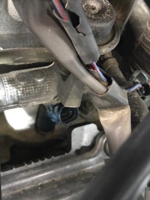

    While the correct timing is very important, I'll set that aside a lot of what you said concerning timing and ask a few other questions first.
    Bingo....that is the fail-safe mode the ECU places the engine control in, restricts the engine's RPM to around 3,000 when a problem exists that calls for it.
    Do I assume correctly that your check engine light is on ?
    If so, a trip to your local AutoZone, Advance Auto etc is in order before you run yourself ragged. Also, recheck you have all the sensors plugged back in, particularly the MAF sensor, coolant sensor etc.
    You may know this but when it's all ready to go, codes cleared, timing in order and given all the component cleaning and replacing you have done, you'll need to unhook battery for 10 min or more to place ECU in relearn mode.

    Thanks for reply Bubba, got some good rest and back at it. Yes, CEL is on. I live in the sticks and about 45 minutes from parts store and the way its acting I'm concerned about taking it anywhere that far..so last night I ordered a much higher caliber ODB reader than my 29$ one..will be here tuesday.
    I am going to verify the sensors you mentioned are connected and go back look for anything else. Thanks for direction and confirming its in limp mode.

    **************RESOLVED******************
    Thanks for replies. Thanks Bubba for focusing with me on connectors, like u suggested. It was a fuel injector connecter on driver's side closest to firewall. Idles dead on 1,000 and goes past 3k. Huge difference between working on it after work by flashlight and even shop light as opposed to pulling it outside and looking it over with sunlight. now it has a big coolant leak. its dripping off the bottom of the belt on the generator pulley..cant find it yet..about to pull intake box a cpl other things so I can see down in there. Im guessing it might have something to do with water pump area...its dripping a drop a second. i used FIPG..well see. one thing at a time thanks again for replies and tips.
