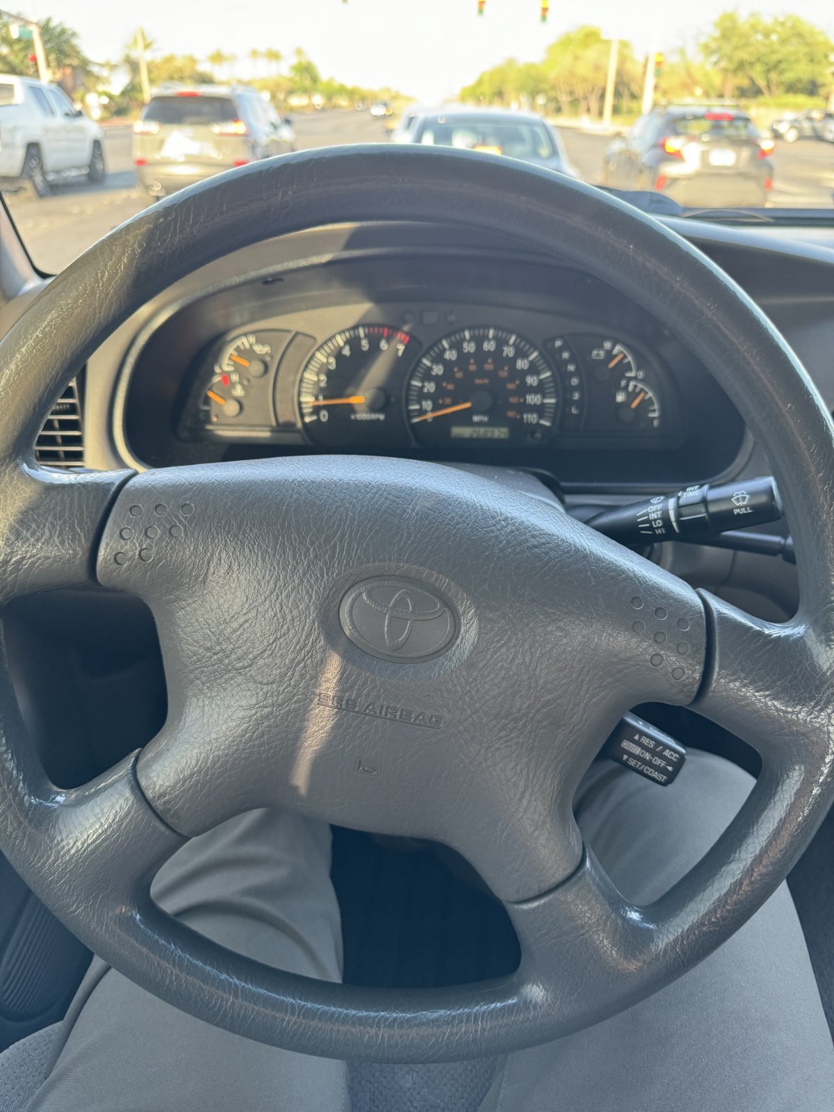

    Ok, one more question:
    So the first step is to secure the steering wheel to keep it straight. Well my wheel is currently a little off (see photo) so, my question is, should I straighten the steering wheel (meaning the wheels and tires may be a little turned) then do the rack replacement with the hope that when I put it back on it will be closer to center…
    or,
    should I secure it with the wheels and tires straight (meaning the steering wheel will be a little off center) and then do the swap and hope it can be fixed with alignment…
    curious your guys’ thoughts.
    thanks!!

    What caused your steering wheel to be off?
    I would probably have wheels straight and then change rack. Wait for some others who are more knowledgeable than me to chime in.

    You can set the wheel straight and use your TREs to get the tires straight. That's what we did to mine.

    ^^This^^
    What bmf said.
    Center your steering wheel and secure it before disassembly. When installing your rack, turn the shaft (the pinion, of your rack) your coupler goes on both ways lock to lock. Count how many revolutions it is. Mark it if you have to. Now rotate the shaft back 1/2 of those rev's. For instance if you got 3 1/2 turns out of it, turn it back 1 3/4 turns. That should be centered for your new rack. Install it like that. It wont be perfect. When it is aligned they'll get it right on. This way both of your outer tie rod ends will be threaded on roughly the same amount. Also when taking your old TRE's off the old rack measure how many threads from the end of the threads to the jamb nut on the threads of your inner tie rod end shaft. Your want that to be approx equal on each side. The two sides may not come off and measure equally but they should be close. Alignments, etc could make them slightly unequal. Just add the two measurement and divide by 2. That is the measured distance the jamb nut needs to be screwed down on to the inner rod end shaft. Easy stuff. Makes the alignment easier and more equal.
