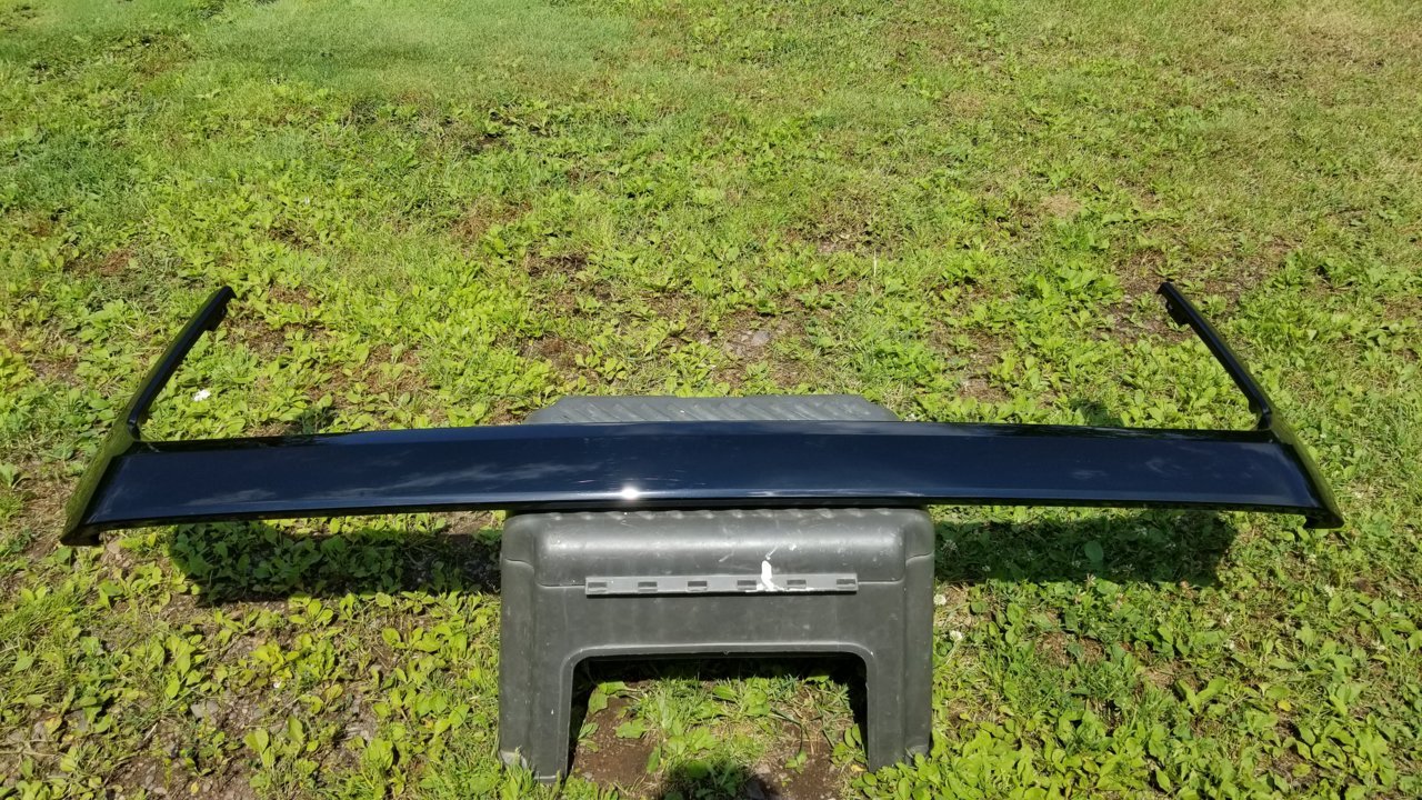

    Not sure if thats the exact one but i got mine off e-bay for $150 , fit great.

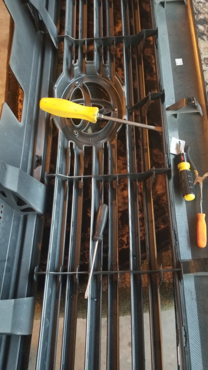

    Had to remove this from the new Pro grill, the black is not the same as the platinum wich i knew, it is kida a PITA to get separated , but can be done with patience.

    A super hot day or a heat gun on low will assist with removing bud

    I did try a heat gun with no success, the stock grill was pretty dam snug, the e-bay Pro grill was easier to separate Found that a screwdriver wedged in like this 20180804_204119.jpg then work the clip a little with a screwdriver worked good..if you over heat the clips they will fold up on you with the slightest pressure. Heating entire grill would help.
