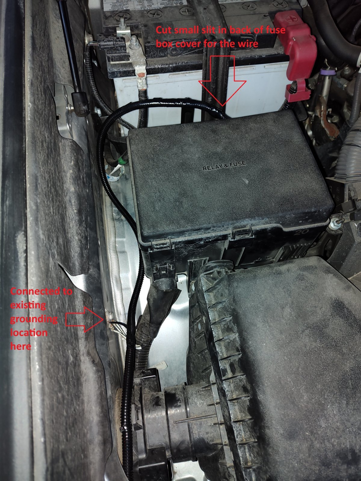

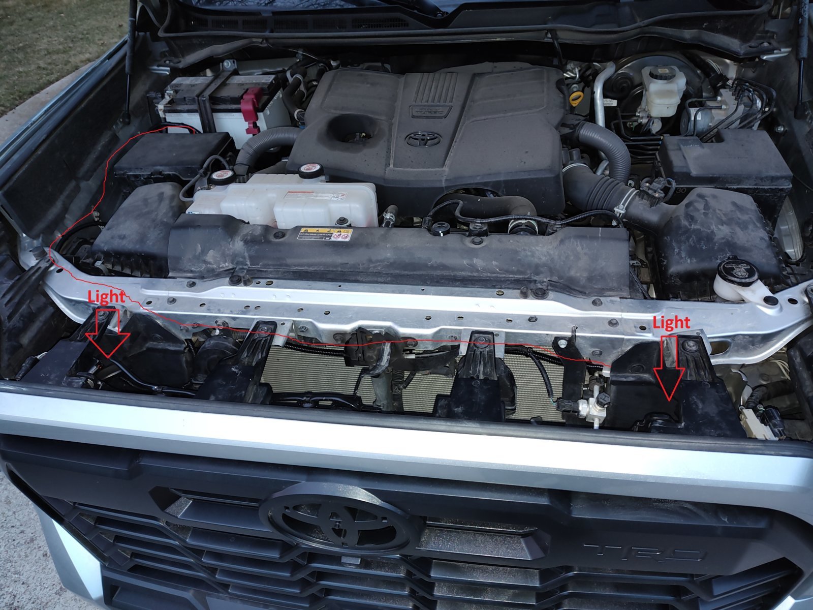

  28. Feb 6, 2024 at 6:26 AM
    #418
    angrygiraffe
    angrygiraffe New Member
    Jun 16, 2022
    #79638
    18
    '22 SR5 CrewCab 5.5'
    Thanks to everyone who shared details on swapping out grilles on this thread. It was all super helpful!
    I went from the SR5 grille (with camera) to the TRD off-road (not heritage) grille. I can't really use the extra light bar where I live and didn't want a big hole in my grille where one should go.
    Original:
    After bumper/grille removal:
    Complete:
    I was originally planning on adding some raptor lights with some simple Amazon LEDs but after having read a bunch of reviews for all of those I didn't have a lot of confidence any of them would last long, so I didn't want to install lights anywhere I couldn't easily access them (don't want to have to take the front end off my truck every few months to replace a failed one). I decided to put two lights between the shutters and the radiator, attached to some of the black plastic surround above the intercooler. I was concerned you wouldn't be able to see the light at all but it actually gives off (what I think is) a pretty cool grille back/side lighting effect. The beautiful thing about where I placed these is that I can easily access them from the top, without needing to remove any other parts. I soldered in a bunch of disconnect points as well with waterproof connectors so everything is easily disconnected when something fails or if I decide to add more lights.
