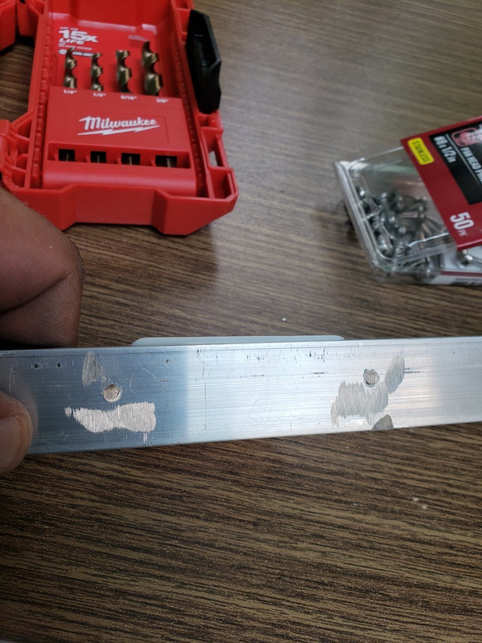

    might as well post in this thread as well,
    So, i got my grille finally, working on the camera bracket, had to stop was going cross-eyed staring at the computer,
    i found some mini marker lights that i thought might fit the grille, and it turns out they do!
    now they may not be as fancy as the OEM ones, but they work and was cheap to do.
    oem ones fill the entire little area and have a slope to em on the front, and has that +75 HP sticker on the back of them
    what i installed,
    Soooooooooo,
    Tools Needed: *if you do the same as me,
    Drill
    Drill Bit Set, mainly 9/16, and a 5/32 for a few of them
    Some way to cut the bar stock, hacksaw, jigsaw, circular saw, porta band, cutoff wheel, die grinder with cutoff wheel, or i used an angle grinder with cutoff wheel
    some form of grinder, bench grinder, angle grinder with flap disc, etc..
    Bench vise is handy to have to bend the aluminum all purty like
    Hammer!
    Marker
    Tape Measure
    Miscellaneous hand tools, pliers vice grips etc..
    electrical terminal connector assortment
    optional:
    soldering iron, solder, heat shrink tubing
    plastic wire loom
    electrical tape
    Remember your PPE! Don't lose an eye!
    i went and saw my good buddy Homer at the Depot, (home depot for those who don't care for my bad jokes)
    Picked up a piece of 1/8 in x 1in x 3 ft aluminum flat bar stock, cost $8.00
    got the marker lights, 3 holes, 3 total... , yes i know they aren't led, i don't particularly care, $4.00 ea so $12.00
    also picked up some screws, this is what i used, use whatever you want, went with stainless as i live in the rust belt, this pack was $6.00
    now on to the fun part,
    i cut my flat bar at 24 inches as i wanted to have it overhang past the letters a bit on the sides so i know there would be support
    after i cut it, i took and laid the bar in above the letters and put the lights into place where i thought that they looked good,
    i then used a marker to mark out the base where the lights sit as you can't mark from top down, once the bases were marked i pulled it back off and used the marker light as a guide to mark the screw holes, then drilled them all with the 9/16ths drill bit.
    i then put the marker lights on the bar and used the screws to attach them,
    CAUTION - you go Hee Hawin on the screw your going to strip the aluminum where the screw is cutting the threads
    once the lights were screwed on, i then went and used a grinder to grind the screws flush on the bottom side of the bar or else it would not fit back in the spot at all
    after the lights were mounted i test fit again and all was kosher,
    took the leftover 1ft piece of bar stock and made 2 brackets by bending and cutting it, no real measurements here, i just made some that worked, they don't look the best, but they will hold it to the grille
    used 2 screws from the top of the bar down into the brackets i made, i used the 5/32nds drill bit for those holes for the screw to go through, and then used the 9/16ths on the bracket holes for them to cut threads into, these don't have to be ground down.
    after the mounting brackets were done only thing left was wiring,
    these particular marker lights use a "body" ground
    so wire all the black wires from the lights to power,+12v, "hot" whatever you want to call it
    i wired all mine together in a chain instead of 3 individual wires, you can use whatever you want to attach them together(except scotch locks - don't use those for anything they are terrible)
    me, i soldered my wires together and used some heat shrink tubing
    then i attached a ring terminal to a black wire for ground and used one of the bracket screws to hold it to the aluminum
    used a couple pieces of electrical tape to secure wires to the bar itself before i stuck it back in, could use plastic loom if you want.
    used 2 of the screws to screw the brackets to the grille!
    and finish!
