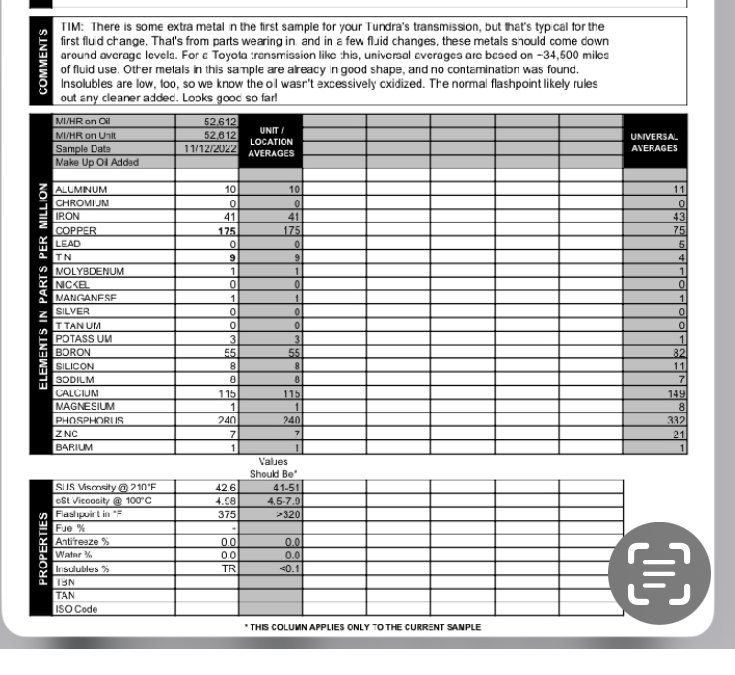

    Thought I’d add my tranny report. My use case is nearly identical to Green Thunder’s in post 18. I note nearly identical temps under similar conditions and I monitor it regularly. I had the dealer do the complete flush/exchange they offer. I was concerned the cleaner was put in before the sample was taken, which is why they mentioned it. This is the first change at 52k. I’ll probably do another in 30k and if the metals drop into the normal range as expected, conclude I don’t need the dedicated tranny cooler added on.

    Wow, our tests are pretty close. Thanks for attaching your results. More data is always good.

    I thought it added some good info. Especially considering our uses and temps are nearly identical. I’d really like to see 3-4 more reports from folks with similar usage. Would help validate the no cooler needed decision. I’m not going to decide for sure until my next report, but I don’t think I’ll need the cooler.
