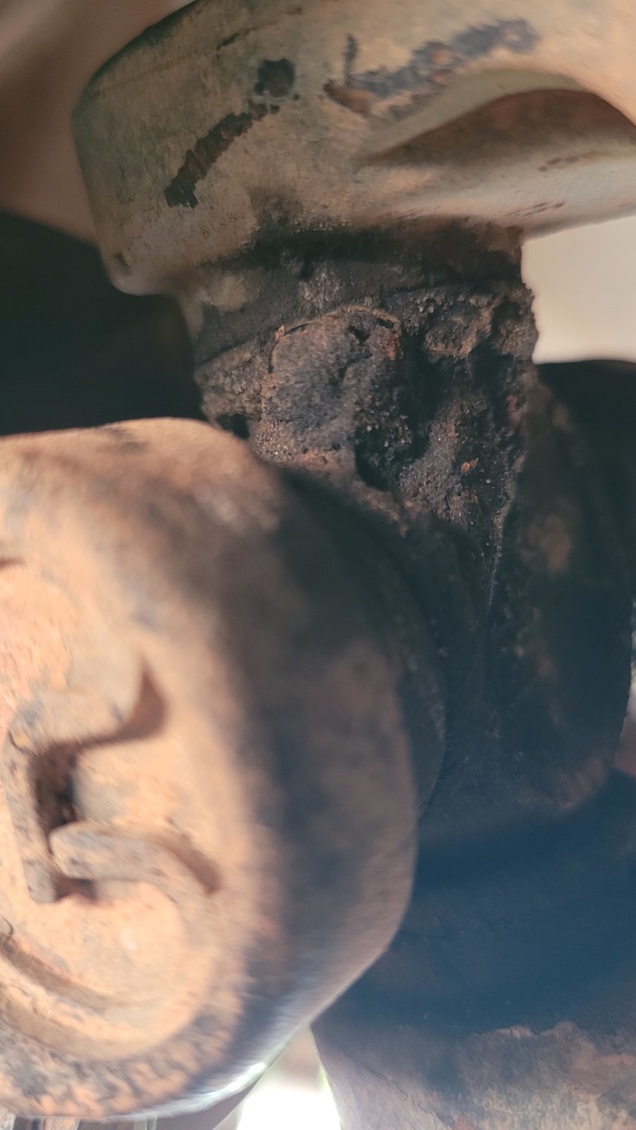

    02' Tundra 4WD. Purchased the truck relatively recently. Had the tell tale after deceleration clunk on occasion. Also the shift from park to any gear was rough after the shaft engaged. I cannot suggest this service more strongly! It drives about 3 times better. The shifting is much smoother and doesn't jerk after shifting. Feels incredible. The work wasn't too bad to complete on my own. I couldn't find a nipple though in the 2 pictured locations. Am I doing something wrong or is it possible this was an after market product put in the truck that doesn't have grease access? Also the 4 low won't engage or blink. 4 HI does just fine. Wondering if you guys were able to find the nipples this manual says there are. Thanks in advance!

    I found them boys. Jesus they are dirty! Gonna have to clean em up before getting grease in there!
