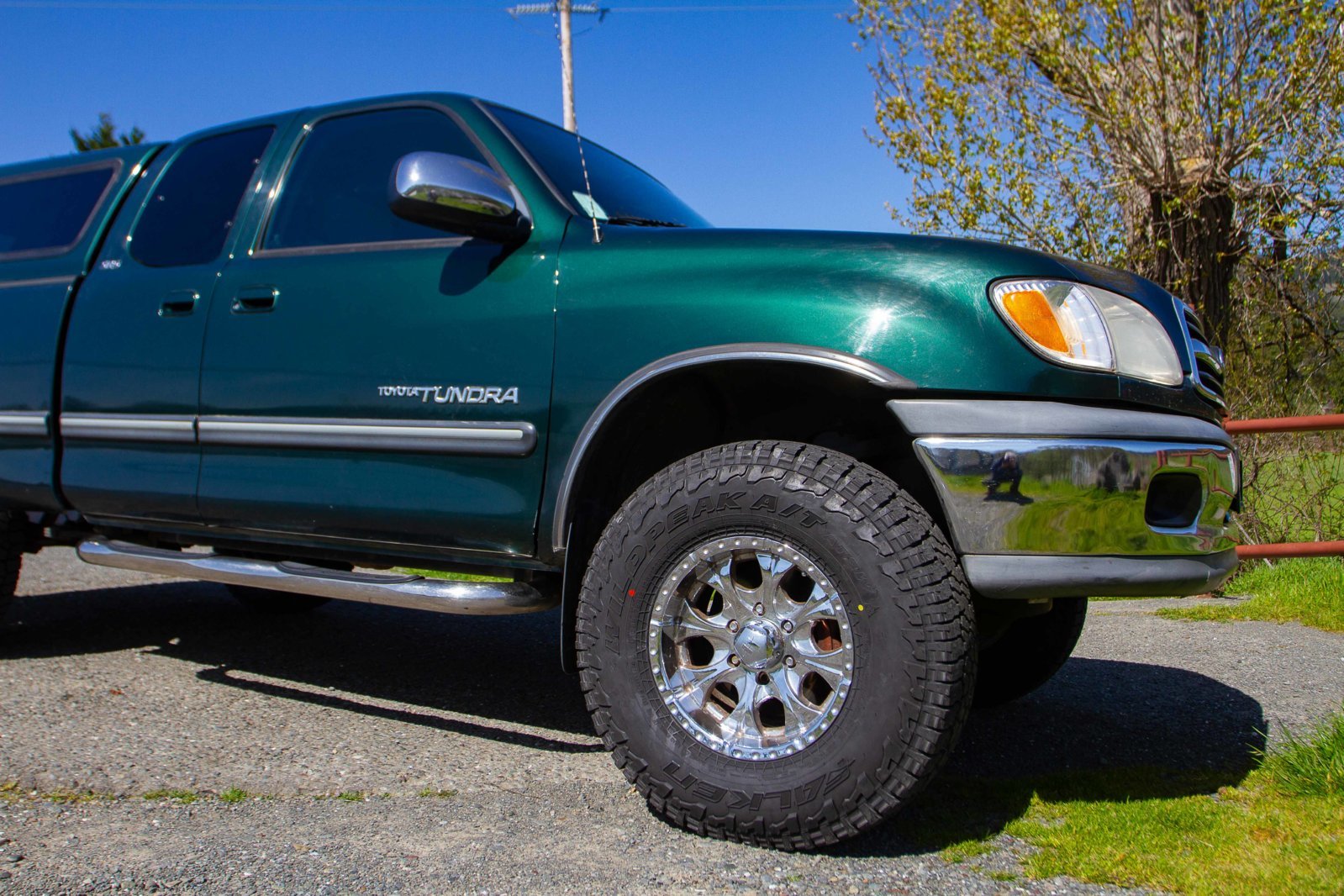

    285/75/16 Falken Wildpeaks. I think the truck has a leveling kit. I get a little rub on the drinker's side, mostly because the bumper has a bit of a whiskey dent on that side and is pushed back. No spacers, I don't know the wheel specs, but maybe this is helpful? 2000, 4wd, AC, V8. I did a little redneck fabrication adjustment to the lower bumper liner and bumper.New Tires on the Tundra-1.jpg

    Is it as tight as it looks by the front bumper?

    It was, this is just after I had them mounted. I've clearanced that bumper about 3/4". I get a slight rub on the tread when someone is sitting on the drinker's side and turn left. I can live with it! Love the tires.
