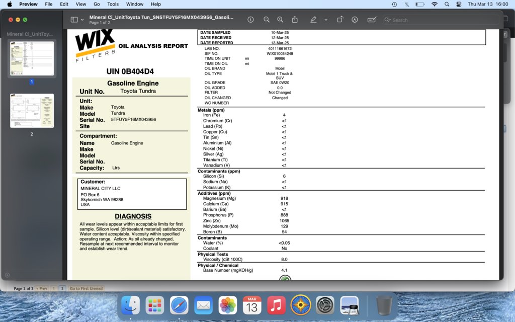

    Got my 1st oil sample back.
    Been running Mobil 1 0W-20 Truck and SUV
