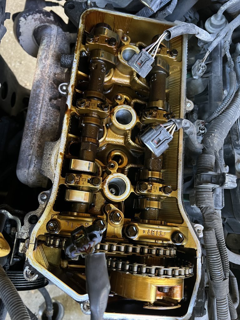

    Anyway back to oil. Run what ya want but by my experience Mobile 1 and amsoil are awesome. Inside the FJ at 292,000 miles Mobile one only then Amsoil switch at 275k IMG_6280.jpg

    Wow. Looks likes the amsoil has almost completely removed the sludge from the mobil 1.

    That might of been the snake oil I poured in before the switch

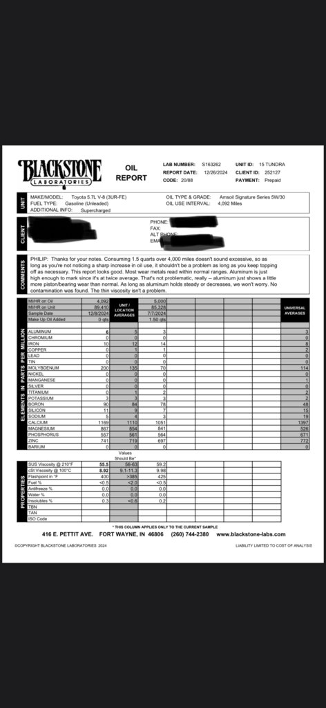

    Here’s 2 samples from my supercharged truck.
    The 5000 mile sample was Pennzoil Ultra Plat 5w30.
    The 4000 miles was Amsoil Signature 5w30.
    Besides some extra moly, I don’t see much difference. Does anyone else think the Amsoil is worth twice the price based on these results?

    Well, almost twice.. by my calculations it’s about $40-$50 different..
    I just paid $127. ($16 member renewal, $88 2 gal sig series 5w30, and $15 for filter, plus 7% tax). Free shipping.
    Amazon had the pennzoil ultra platinum at $29/gal jug. So roughly $81.32 with the $15 filter and tax..
    Amsoil: $127
    Pennzoil: $81
    But you also get 2 extra quart with pennzoil.
    The amsoil jug is actually only 4qt each jug. Whereas pennzoil is a 5qt jug.
    amsoil: $11/qt
    Pennzoil: $6/qt
    It would be around $115 for the amsoil with filter if you get 10qt total. Then depends if shipping is free or not.
    so, if i were to stick with amsoil. I would pay $127 each year vs $81 for my annually oil change. I put in about 5k a year. Not much driving.
