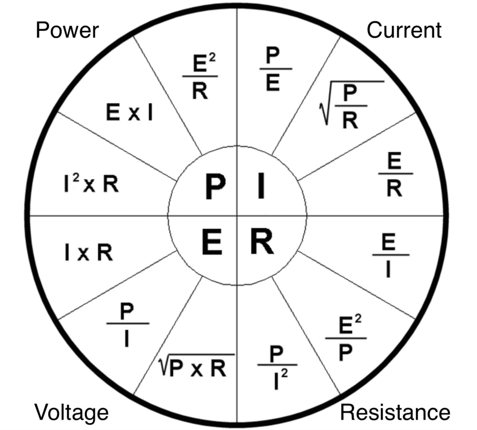

    I will add to these fellas, be sure set your gain on the amp properly. Use this chart.
    I'll use mine for an example with E= sqrt(PxR)
    I need to find what E(voltage) I need my amp to put out. So, I know my subs handle 500w RMS a piece for a total of 1000w RMS. Do not use peak handling for this! I know the resistance is 4 ohms for a total of 2 ohms.
    Therefore, E=sqrt(1000x2)
    E=sqrt(2000)
    E=44.72
    So, I zeroed out every setting in my deck. Bass boost, loudness, EQ, etc. Then, I ran a 30hz test tone with the subs unhooked and checked the voltage at the output of the amp with a multi-meter. Set your volume to 3/4 maximum. Start with the gain at the lowest at turn it up till you get to the voltage you need.
    I did the same thing with the fronts, set at 1khz, but I have a separate amp for them. With those settings, I don't need to adjust any settings that we zeroed out before.

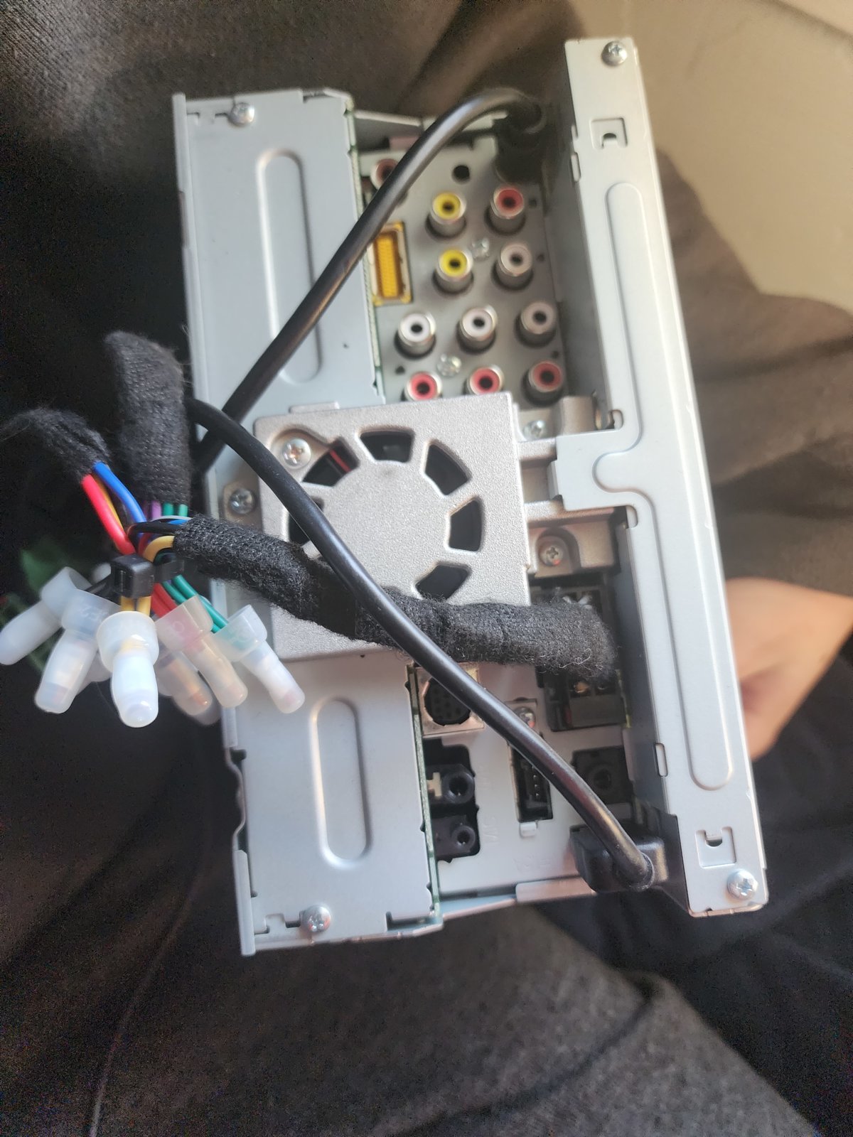

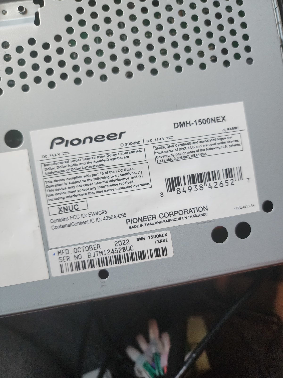

    I'm confuse, earlier you posted pics of a Pioneer 1500NEX unit and then you posted a link to a shitty Boss headunit so what the dealio? You replacing the Pioneer with the crappy Boss or is that Pioneer not something you have? Give us a better rundown of what going on here boss.
    Sh1tb0x m4nu4l[OP] likes this.

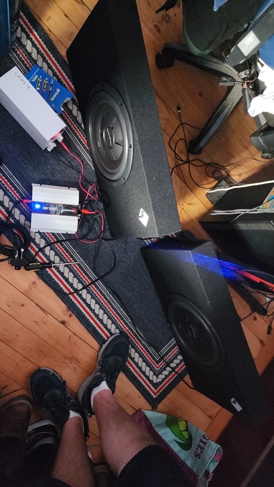

    Okay so I tried to put the pioneer one in the truck and the wiring harness didn't fit and the head unit was small as hell, one of my friends had a boss that I liked so I bought one and now my current plan is to use the boss one because Crutchfield said it's compatible with my truck.
    This might sound stupid but I have a power supply next to me and I'm going to run the subs in my room first before I put them in the truck because I'm kinda stupid and wanna make sure they work before I spend hours putting them in a truck without testing them first.

  27. Jun 22, 2024 at 9:01 AM
    #87
    KNABORES
    KNABORES Sarcasm incoming
    Jan 1, 2020
    #40572
    15,201
    Arkansas
    Based on the picture, that setup will make sound, but not sure you're getting the true output. That's some small gauge wire coming from that 110 to 12v converter. Also not an overly large converter. Need a 12V battery in between the two, otherwise the converter may not be able to match the peak demands of the amp.
  28. Jun 22, 2024 at 9:14 AM
    #88
    Sh1tb0x m4nu4l
    Sh1tb0x m4nu4l [OP] New Member
    Jun 4, 2024
    #117952
    46
    2004 base model manual tundra longbed
    Yes it was only running very low and was underpowered, I had to order the amp on Amazon and not the taramps website bc the 2 ohm version was sold out so I was paranoid it wouldn't work.
    The subs hit even at low power it could be heard all the way across my house.
    KNABORES[QUOTED] likes this.
