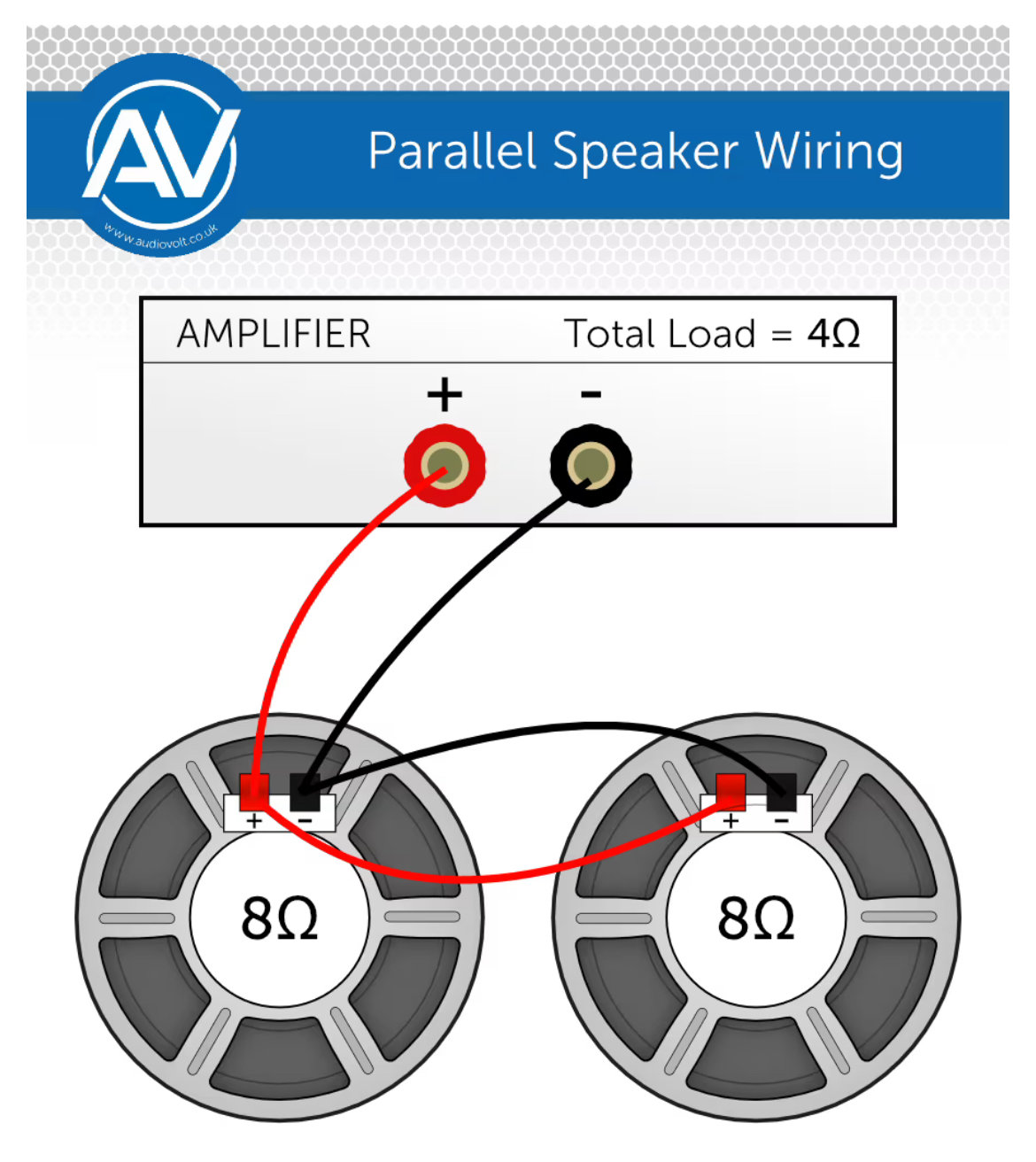

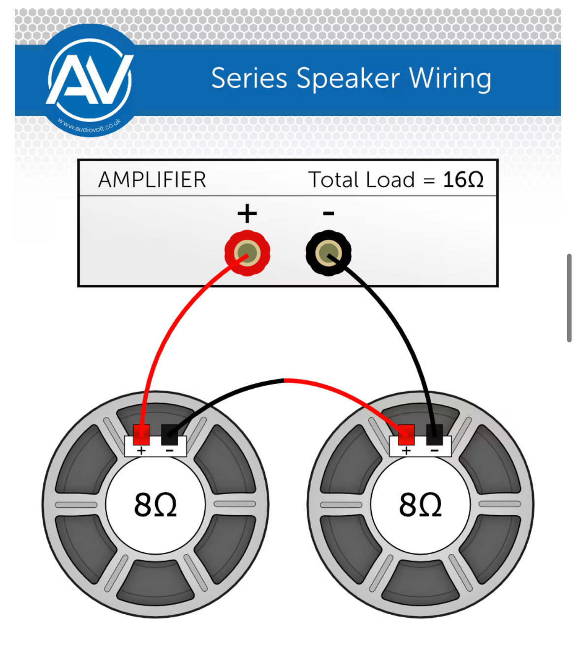

    It's also important to understand the difference between wiring in parallel and series, and how to calculate total load in ohms.

    Would I wire these in parallel or series, and do both ways of wiring support stereo audio?

    Those boxes are 2ohm. If you hook one to an amp it presents a 2ohm load and the amp will output whatever it’s rated at that load. If you wire two of them together in series, it will increase the impedance (4ohm) that the amp sees. The amp will deliver less power overall, and it’s split between two speakers.
    If you wire them parallel, it will reduce the impedance (1 ohm) and deliver more power overall.
    Two 2 ohm speakers wired in series hooked up to an amp that delivers 500w @ 4ohms would be the target.
