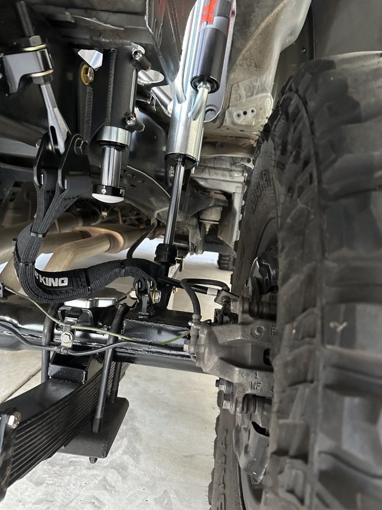

  1. Aug 3, 2024 at 12:29 PM
    #121
    heckler66
    heckler66 [OP] New Member
    May 18, 2021
    #63225
    77
    2012 Tundra CM 4x4
    Icon Billet Upper CA King 2.5 Fr / Rr Deaver U748 Victory 4x4 bumper RCI Skid plates Baja Designs lights

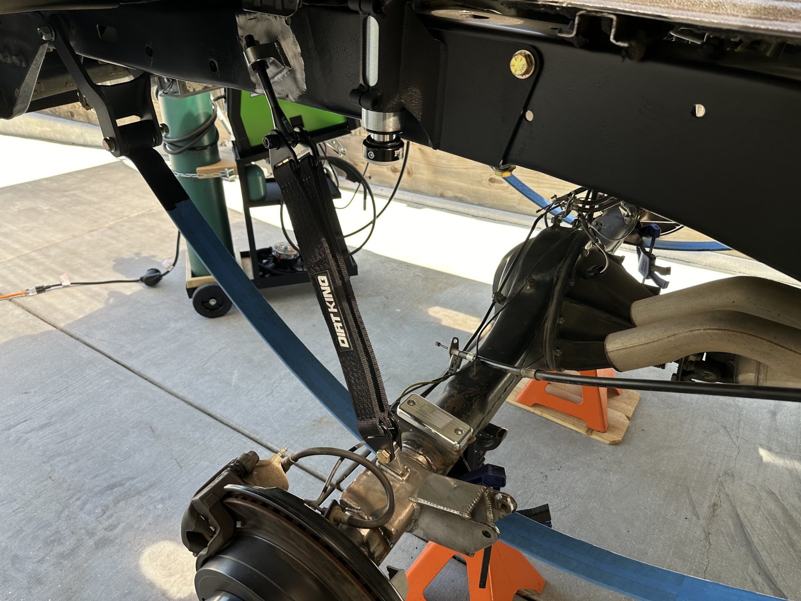

    Limit straps are in

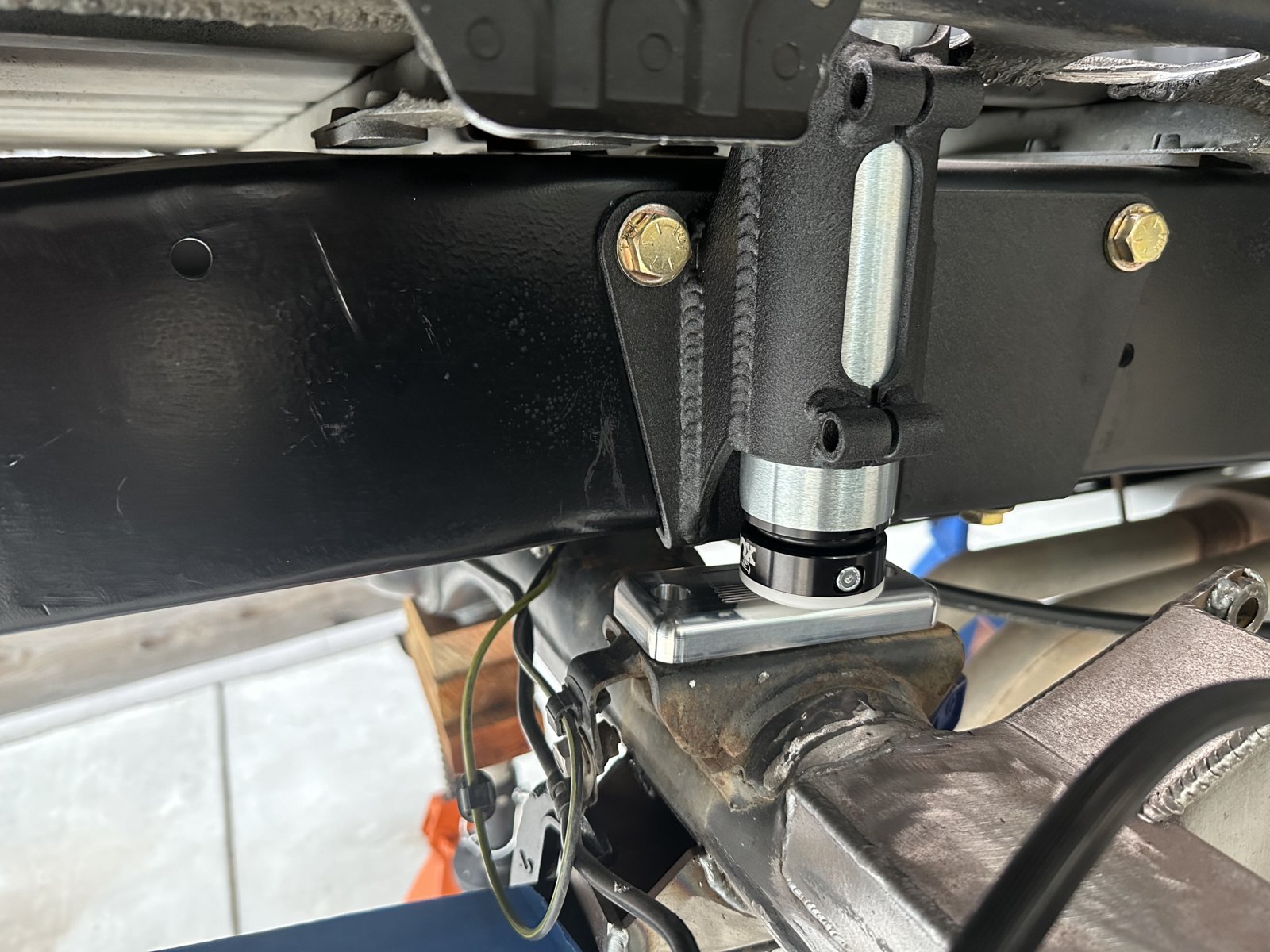

    2001 Prerunner, 2014 DC 4wd

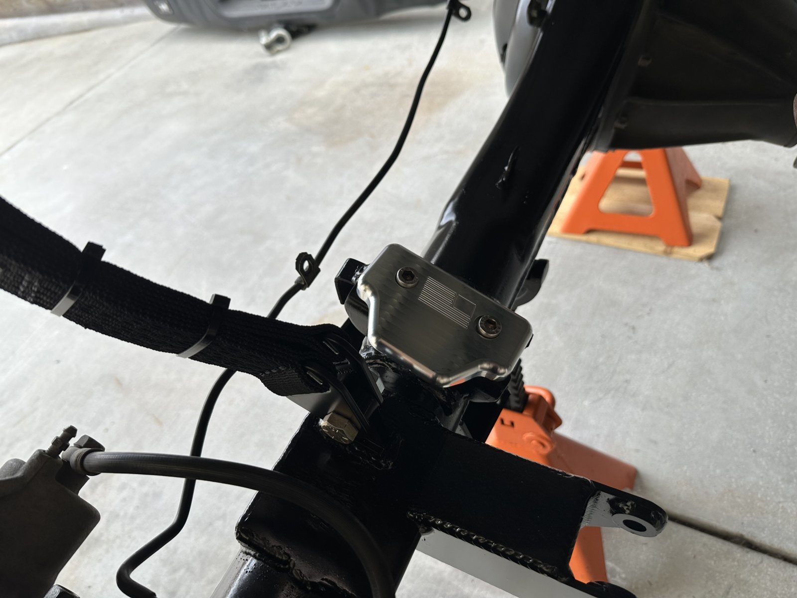

    Where do the bumps hit on the rear end relative to the lower limit strap mounts? Looks like they would end up close at bump.
    heckler66[OP] likes this.
  5. Aug 3, 2024 at 2:10 PM
    #125
    heckler66
    May 18, 2021
    #63225
    77
    2012 Tundra CM 4x4
    Bumps hit the pad with the American flag. Camburg bump kits hit the stock leaf perch area.
    Mullen[QUOTED] likes this.

  7. Aug 3, 2024 at 4:14 PM
    #127
    heckler66
    May 18, 2021
    #63225
    77
    2012 Tundra CM 4x4
    Going to have to redesign the bump pads because where the bump stop hits (on the edge) and where I place the M8 holes. Might try to thread-rivet the existing 1/2” holes and use those.
    Peeeheeuuu and reywcms like this.
  8. Aug 3, 2024 at 4:25 PM
    #128
    snivilous
    snivilous snivspeedshop.com
    Apr 16, 2019
    #29192
    5,101
    SW UT
    300k+ Supercharged 2008
    Flex the suspension out too so you know the bump stop hits where you want when the axle is pivoted around too
  9. Aug 3, 2024 at 4:30 PM
    #129
    reywcms
    reywcms New Member
    Dec 20, 2021
    #72040
    7,637
    Rey
    North Plains,Oregon
    2017 Tundra Platnium
    Too many mods to come
    This

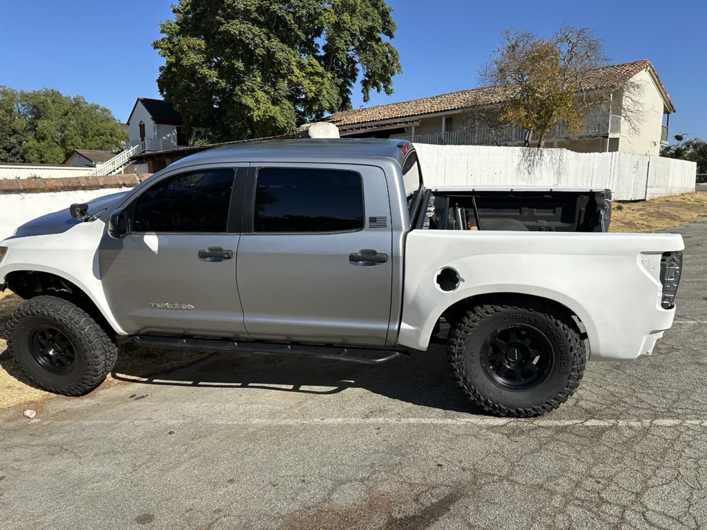

  10. Aug 7, 2024 at 5:24 PM
    #130
    Mullen
    Mullen Desert Dude
    Jul 26, 2024
    #120420
    76
    Corona, CA
    While I love the American flag on the bump pads, keep them smooth for bump scrub. Also, remove the nylon cap on the bump when cycling to simulate worst-case scenario where the bump cap is destroyed.
  11. Aug 11, 2024 at 9:31 AM
    #131
    heckler66
    May 18, 2021
    #63225
    77
    2012 Tundra CM 4x4
    Updated the bump pad. The bump doesn’t rub on the flag engraving but I haven’t had a chance to articulate one side fully up. Also the cap screws are being replaced with shallow head cap screw so they will sit sub flush of the pad.
    Peeeheeuuu and Mullen like this.

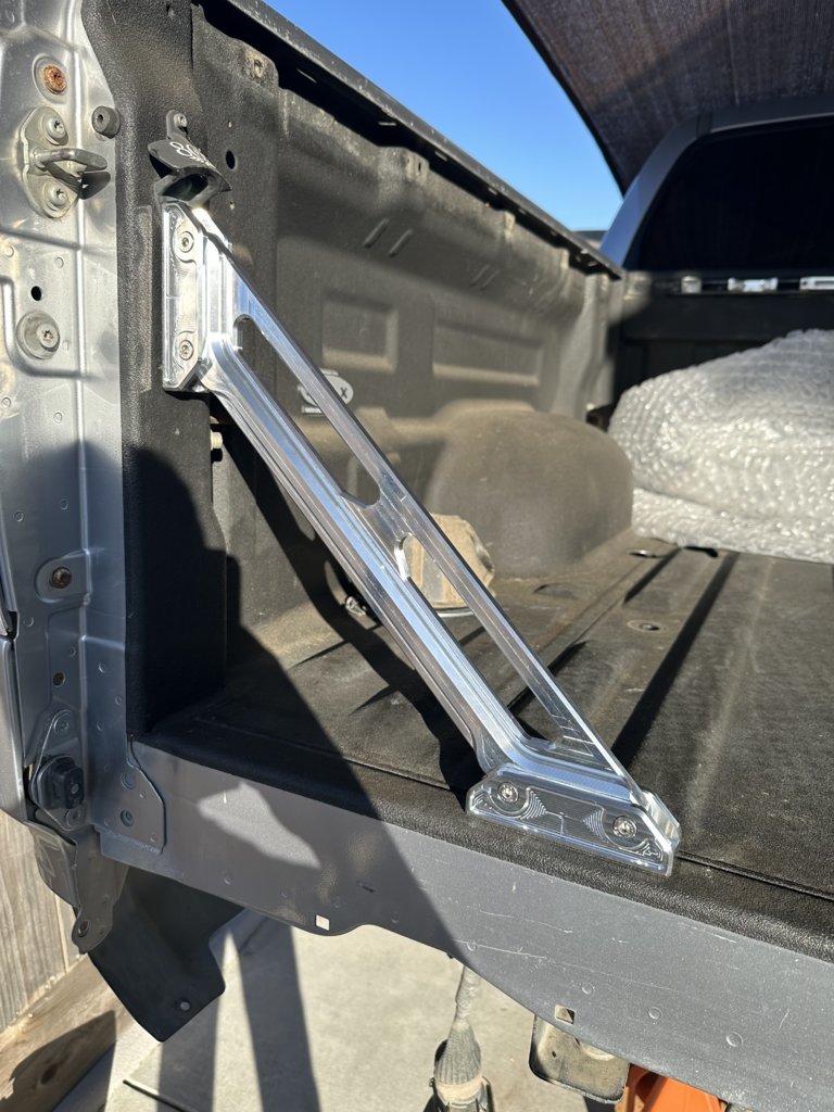

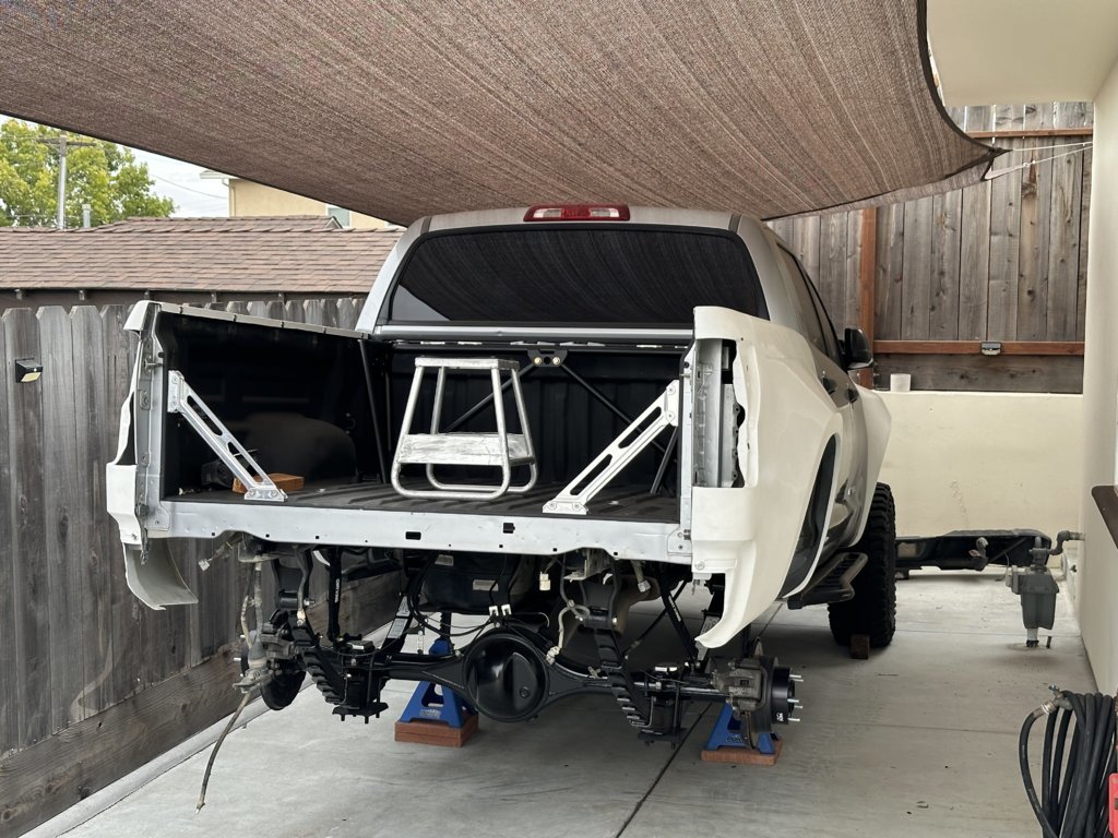

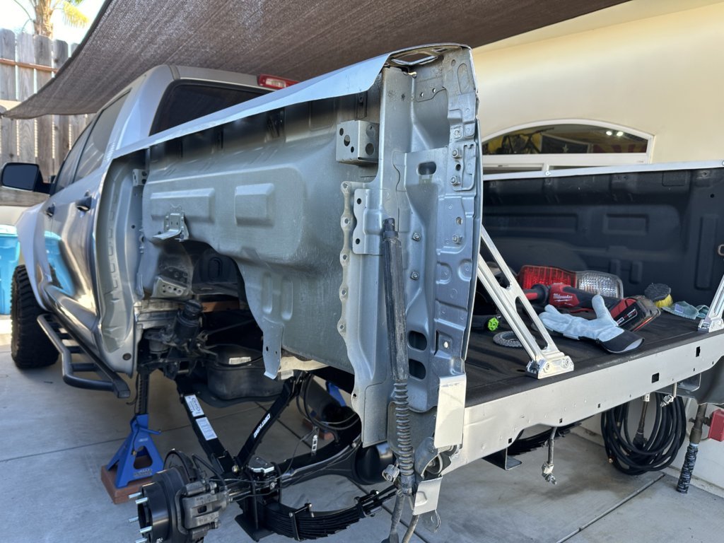

    Also started in the fiberglass bedsides. This was my initial cut. I had to cut more on the rear top portion which was giving me the most trouble. The fiberglass was built up so thick back there which made for a lot of interference. I’ll get more pics of what I had to cut later. Ordered some 1” tubing to make some bedside supports from the frame to the fenders near bottom of well.
  13. Aug 22, 2024 at 6:20 PM
    #133
    heckler66
    May 18, 2021
    #63225
    77
    2012 Tundra CM 4x4
    Some bed supports mocked up, not installed yet. I may have mimicked an existing design.

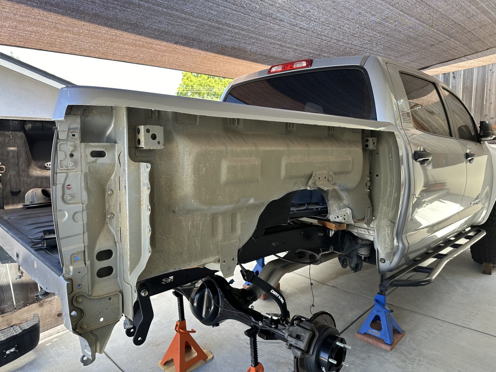

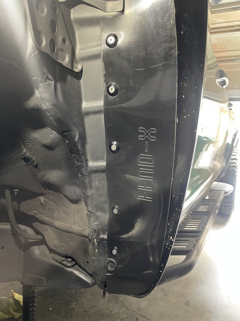

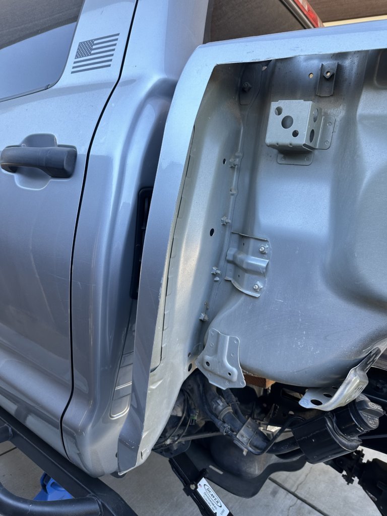

    @heckler66 in the front wheel area back side fender, did you cut the body/frame on the back side to make clearance for the wheels? Camburg provides a small plate for this area. Did you make the cut? Do you think it is needed? If so, can you take a picture of your cut and wheel clearance, please?

    This is called the body mount chop mount mod. Very common. Bottom triangle portion

    @reywcms Thanks for the pics, that plate weld for the body mount chop is really clean. Also, is that FEND-X from a Tacoma you shaped in that spot?

    This liner was custom made but showed up and I cut it all up and made it work for me much better. I'd disregard the brand but you can duplicate this with abs again

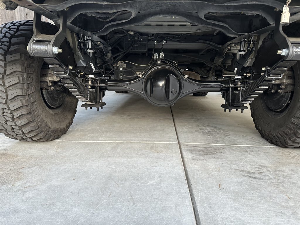

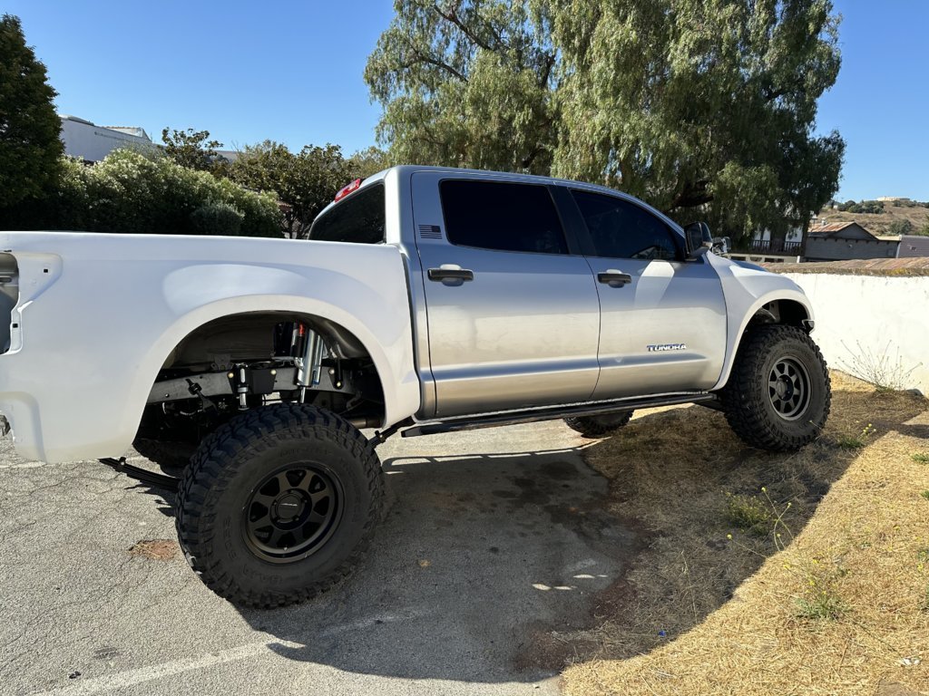

    Bedsides mounted but still need to get the taillights in which are not lining up to the 2 factory bolt holes. I had to remove a lot of the factory bedside at the back top so the fiberglass would sit properly. Need to fabricate a couple brackets from the frame to the lower wheel well sections of the bedside.

    just a couple pictures. Got taillights in, but had to customize how they mount. I basically cut the 2 threaded tabs off and installed 1 M6 threaded rivet-nut into the housing which worked out really good. Currently working on fabricating bedside supports that bolt to the frame and lower bedside by wheel well.

    Im having a problem getting the gas filler anywhere close to where the new fuel door is. I can get a pump into it with no fuel door on it but if I added the door I just don't think it would have room. The bracket and 3 metal tubes make it difficult to bend much.

    I left mine short and bent the bracket. You can also remove the filler neck and extend the hoses by adding more hose there.
