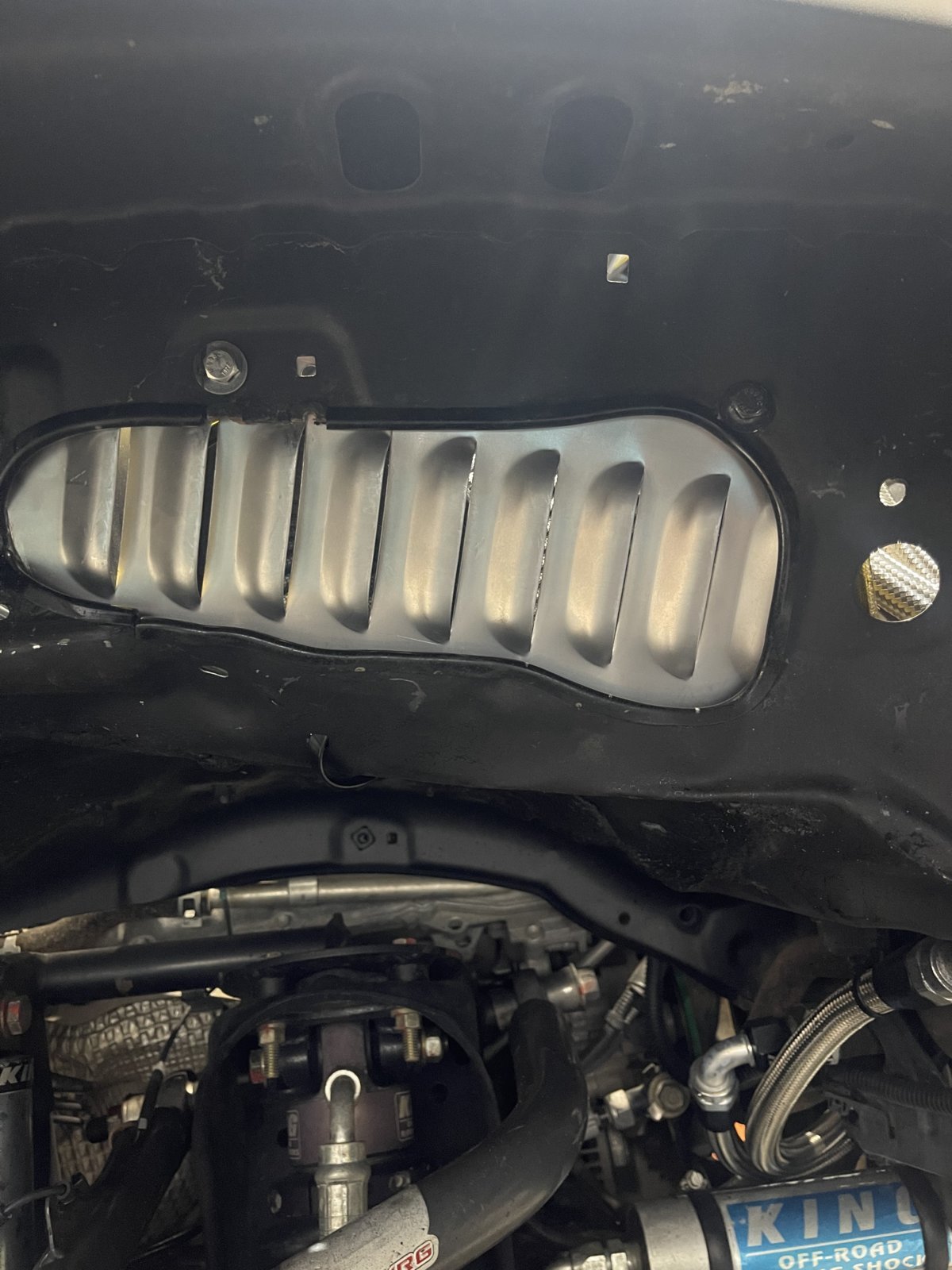

  19. Sep 22, 2023 at 6:32 AM
    #49
    heckler66
    heckler66 [OP] New Member
    May 18, 2021
    #63225
    77
    2012 Tundra CM 4x4
    Icon Billet Upper CA King 2.5 Fr / Rr Deaver U748 Victory 4x4 bumper RCI Skid plates Baja Designs lights
    Mocked up a reservoir mount. Made the tolerance on the snug side so ill have to trim the stickers on the tube. Uses factory M10 screw locations and tucks along the frame rail.61DE3E76-3238-486C-A201-9BAFA4D9F258.jpg

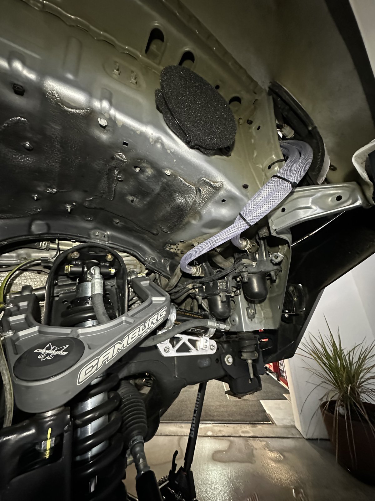

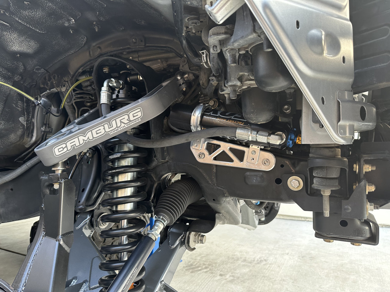

    Regarding sag, anyone have any numbers for what kind of front sag they are running on LT setups? I’m running about 5” sag on 16” travel so just over 30%. This is with a single 800lb spring with no tender spring. I have limit straps set to about 1/8” shock shaft travel below full extension.

    LT front kit you have is a camburg?
    heckler66[OP] likes this.

    Yes Camburg. Running 2.5 Fox with no Bypasses yet.

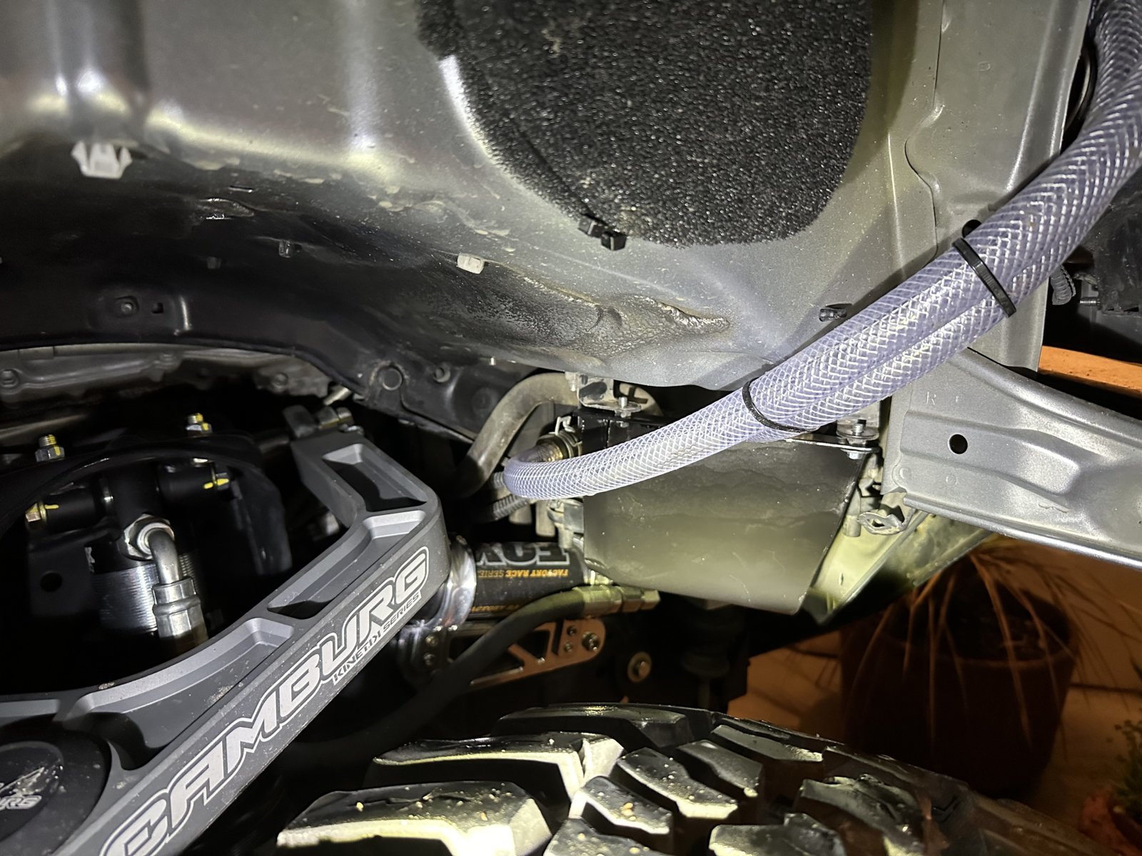

  24. Feb 4, 2024 at 7:06 PM
    #54
    heckler66
    May 18, 2021
    #63225
    77
    2012 Tundra CM 4x4
    Mocked up a ghetto pump guard since I don’t have fender liners anymore. We’ve been getting a ton of rain lately and didn’t want them to be pounded with water no stop. Plan to make a nicer looking one out of aluminum soon but had steel on hand. Also made a pump filter relocation with some cheap parts from Ace and 2 Uni breather filters (~$55).

    I still haven’t relocated mine. I just keep slamming my tire into it lol. I need to fix that

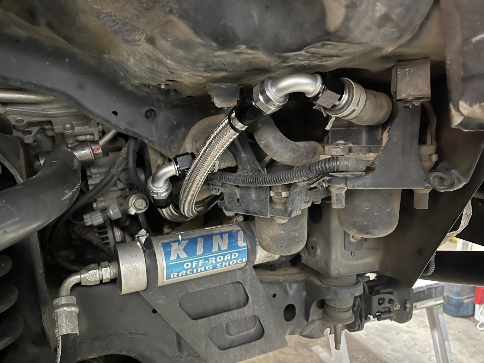

  26. Feb 4, 2024 at 7:16 PM
    #56
    reywcms
    reywcms New Member
    Dec 20, 2021
    #72040
    7,637
    Rey
    North Plains,Oregon
    2017 Tundra Platnium
    Too many mods to come

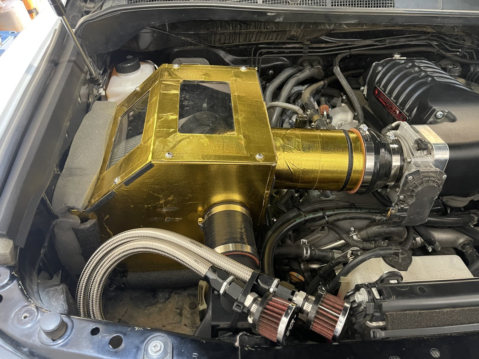

    Careful with that pre filter- I did that before and still water logged the intake filter. I’ve got a parts list for the relocation also if needed.

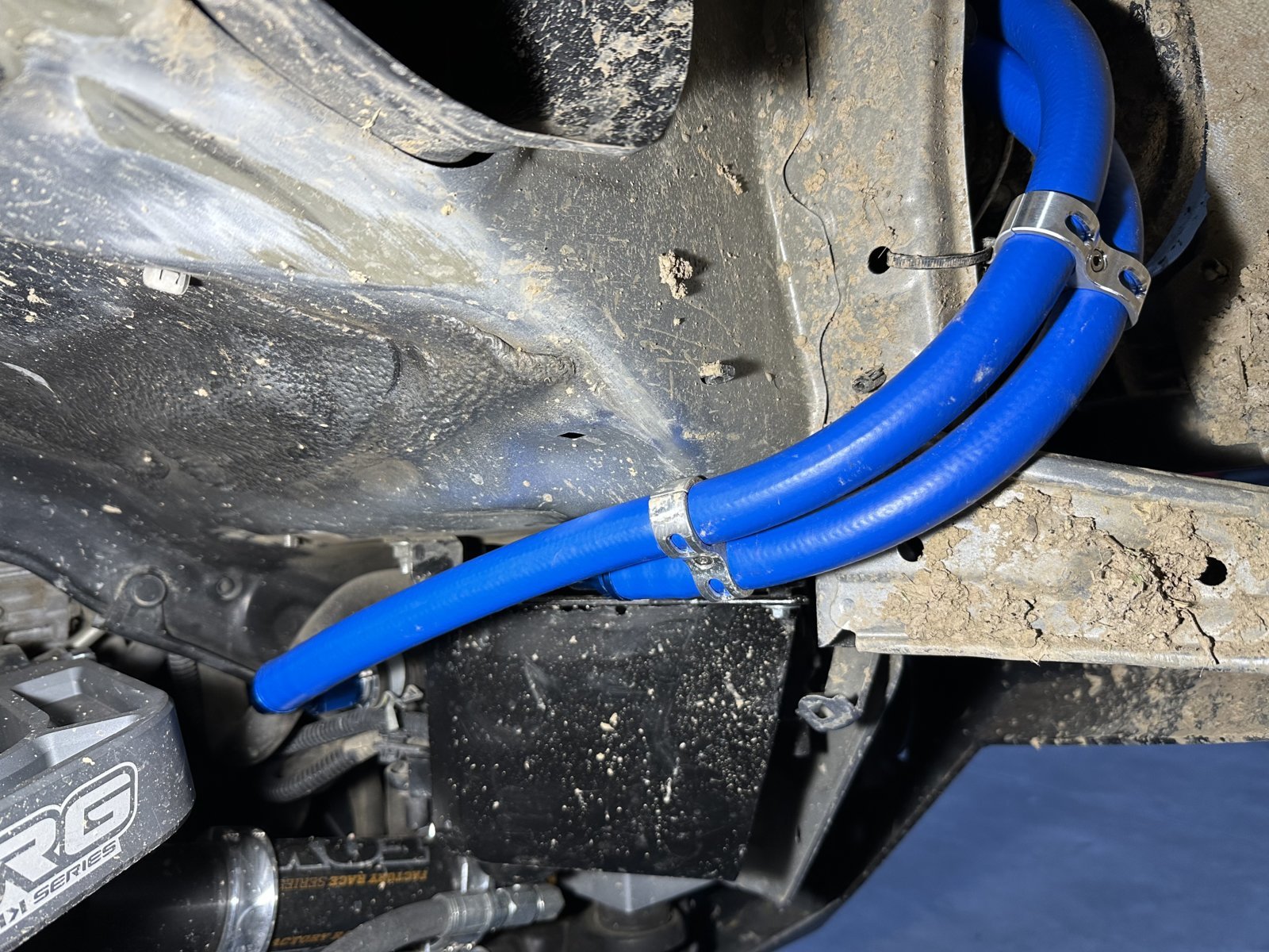

    Planning on redoing the SAI plumbing like yours but with the cheap hose I used I didn’t want to get close to anything hot. Also curious how you’re dealing with air intake rerouting! I had some prefilter material and figured it was better than nothing at the moment.

    I’ve got a different airbox with a large cone style filter and plate in wheel well. Currently working a much better airbox system the moves the box up further. Since I’ll be cutting all the wheel well out. More to come on that

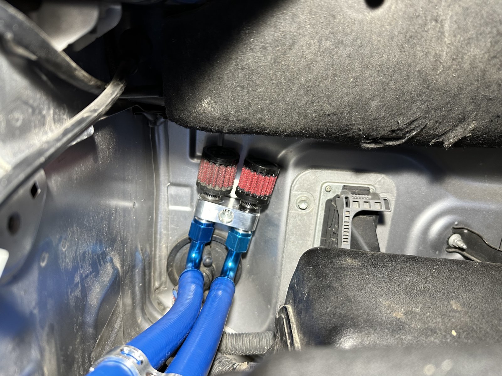

  29. Feb 19, 2024 at 9:57 AM
    #59
    heckler66
    May 18, 2021
    #63225
    77
    2012 Tundra CM 4x4

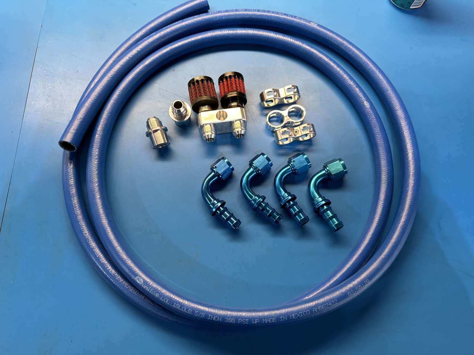

    Here is my attempt at the pump intake relocation. Didn’t consider the large grommet in firewall but it still works as intended. Machined the hose adapter for -AN10 fittings and made a manifold with -AN10 to 5/8” for a clamp on filter.
