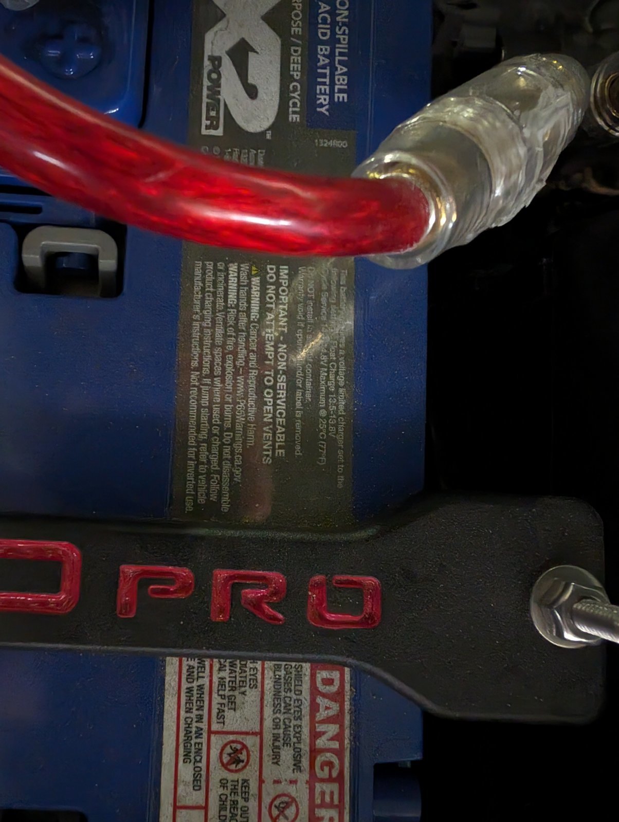

    Sorry, somehow the 2nd pictures wouldn't turn around...
    It states "float charge 13.5-13.8V"

    If you're non-AGM

    I have an AGM battery

    I went to wipe off the grime from the label to read it - I had baby wipes in the truck. Just a PSA for everyone - apparently when you wipe the label on the optima yellow top battery it literally erases the information off of the label.....

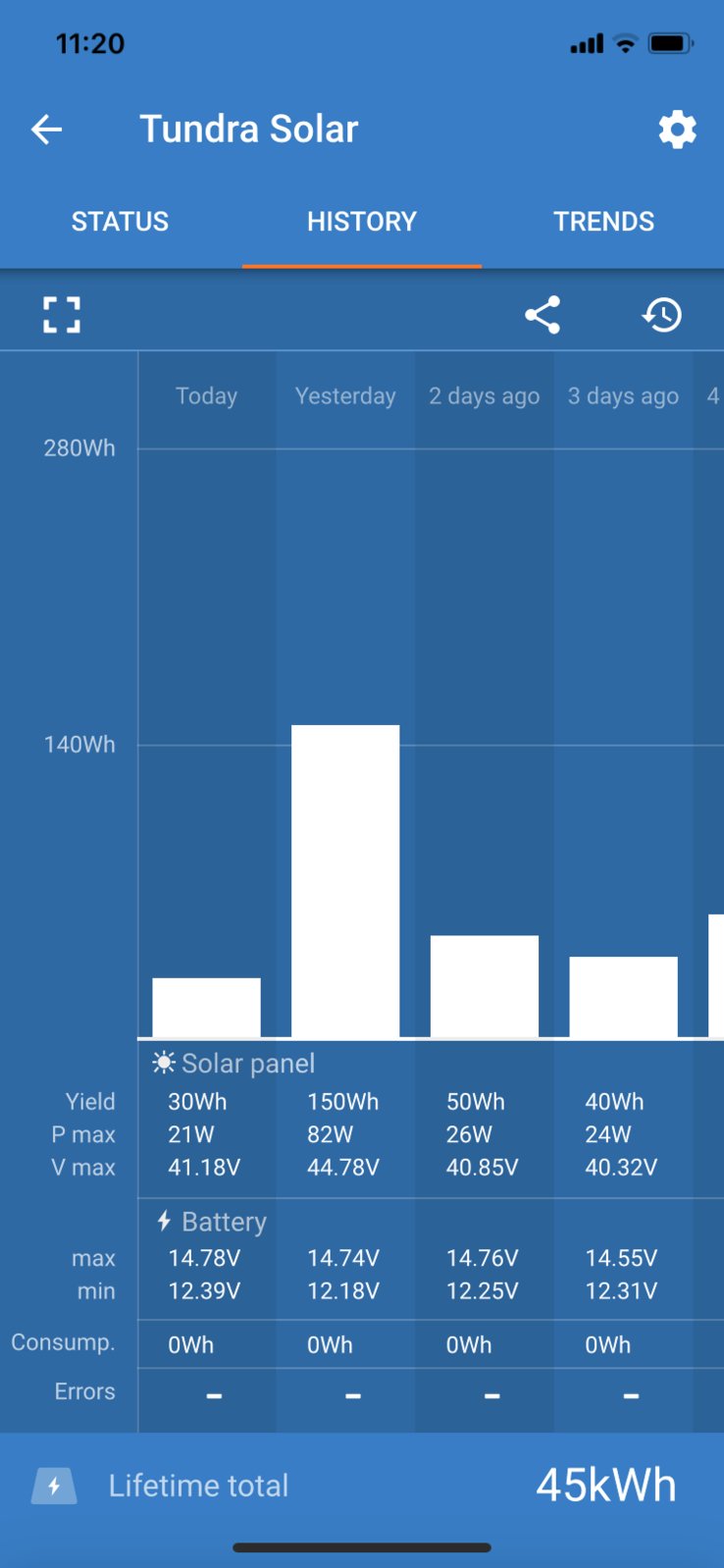

  12. Dec 9, 2023 at 11:21 AM
    #42
    Chad D.
    Chad D. New Member
    Feb 12, 2019
    #26010
    1,430
    Western Oregon
    2018 CrewMax Platinum
    I use a GM diode with my pair of Odyssey batteries, but also added Solar to my canopy roof to keep my batteries happy with the beer fridge running 24/7/365.
    Odyssey batts like a specific charge, which I programmed my solar charger to deliver. So far, so good!
    Pretty overcast today and crap weather for a week, but still makes plenty of power to maintain my system with good voltage that my batteries love.
