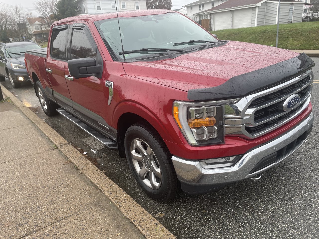

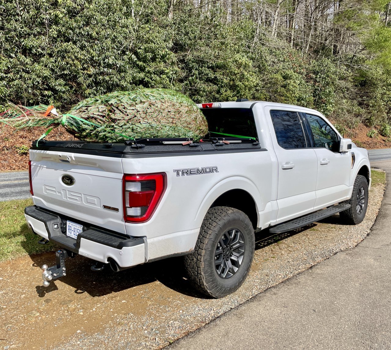

    you sure like posting pics of your ford, lol, I can tell your super proud of it, which is cool.
    I was damn close to buying one but then I had that fiasco we talked about so off the list it went.

    Well was really just trying to show the tires, but that's the picture I had handy. Merry Christmas.

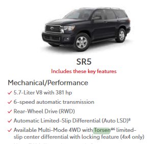

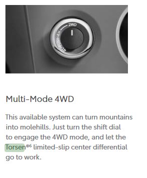

    mass-hole is correct. Too much misinformation in this thread which is typical though for Yotas fulltime 4HI Torsen system. The 2019 Sequoia has:
    * 2HI, so RWD with ABS based traction control.
    * Fulltime 4HI with Torsen center diff, same as LC's, some 4Runners, Lexus GX and LX. Can stay in 4HI 24/7/365 on any surface, can swap back and forth from 2HI-4HI-2HI on the fly on any surface.
    * 4LO, same as LC's, etc.
    * CDL button that locks the Torsen tcase for permanent 50/50 split. CDL can be engaged on the fly, same as LC's, etc.
    It's a robust system, literally millions upon millions of miles in the various Yota vehicles. LC's, etc are always in fulltime 4HI, no 2HI, so loaded, towing, all surfaces the Torsen tcase is doing its thing. We have two fulltime 4HI V8 4Runners and the Sequoia, combined 500k miles. No problems, slap 75W90 synthetic gear oil in and they do fine loaded, towing, offroading.
    As for why it isn't offered in the 3G Tundra/Sequoia, t300 said Sweers was concerned the hybrid's torque could be a problem. I can see that somewhat, but the LC300 has a diesel with 516 torque. I saw a video with another Yota engineer, he said their marketing surveys showed most of their prospective customers don't want it or need it.
    I think this is where confusion sets in. Fulltime AWD like a Subaru is not the same as a Sequoia with 2HI, fulltime 4HI with CDL, and 4LO.

    I didnt say it was identical. It is not, since it has 2 Hi, which is exactly what is said. But it does have full-time 4wd, and that full time 4wd utilized a locking torsen differential starting in 2005, just like the Land Cruiser. Prior to 2005 it still had a differential, it was just a locking open diff.
    So what we have here is the full-time case I want, as well as a 2wd case that you want for your MPG's and apparently for increased towing capacity. It's been there in a Toyota for 22 years now.
    Straight from the 2022 Sequoia Brochure:
    And the best part is people have swapped these t-cases into Tundras.
    It is simple to understand.

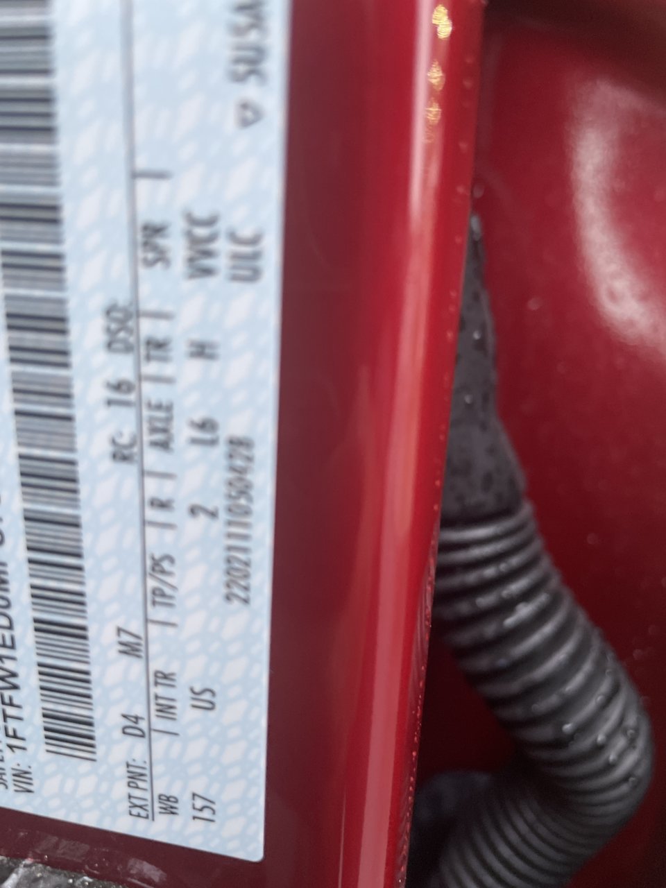

    Umm…I drive a Powerboost with 570 pounds of torque, 3.73 rear and that first gear ratio exclusively in 2wd when it is raining. I in fact just drove it in rain in 2wd to the local track and am typing this in the driver’s seat before i get out to warm up for my sprints. It has rained here all week and I have not even remotely thought about my 4wd switch. This thing has enough power that it is rated about the same as the Challenger RT I just got rid of 0-60 and I’ve been puttering around in the rain in 2wd problem free since March.

    I didn't know you could get 3.73 gears with the PB, sure you don't have 3.55's?

    All PB's have 3.73's. Probably to give the electric motor a little more twist at the tire.

    I just tried to build one on Ford's website. When you select 3.73s it automatically deselected the PB. I don't think you can even get 3.73s with the regular 3.5 EB except for the Tremor.

    axle L6

    Hmm. Wonder why the website is not letting that be selected. Possible it changed for '23 though I guess.

    I want to say I read somewhere 3.73 was actually the only powerboost option in 2021 but I can’t find it now, I’d have to dig out that year’s order guide.
