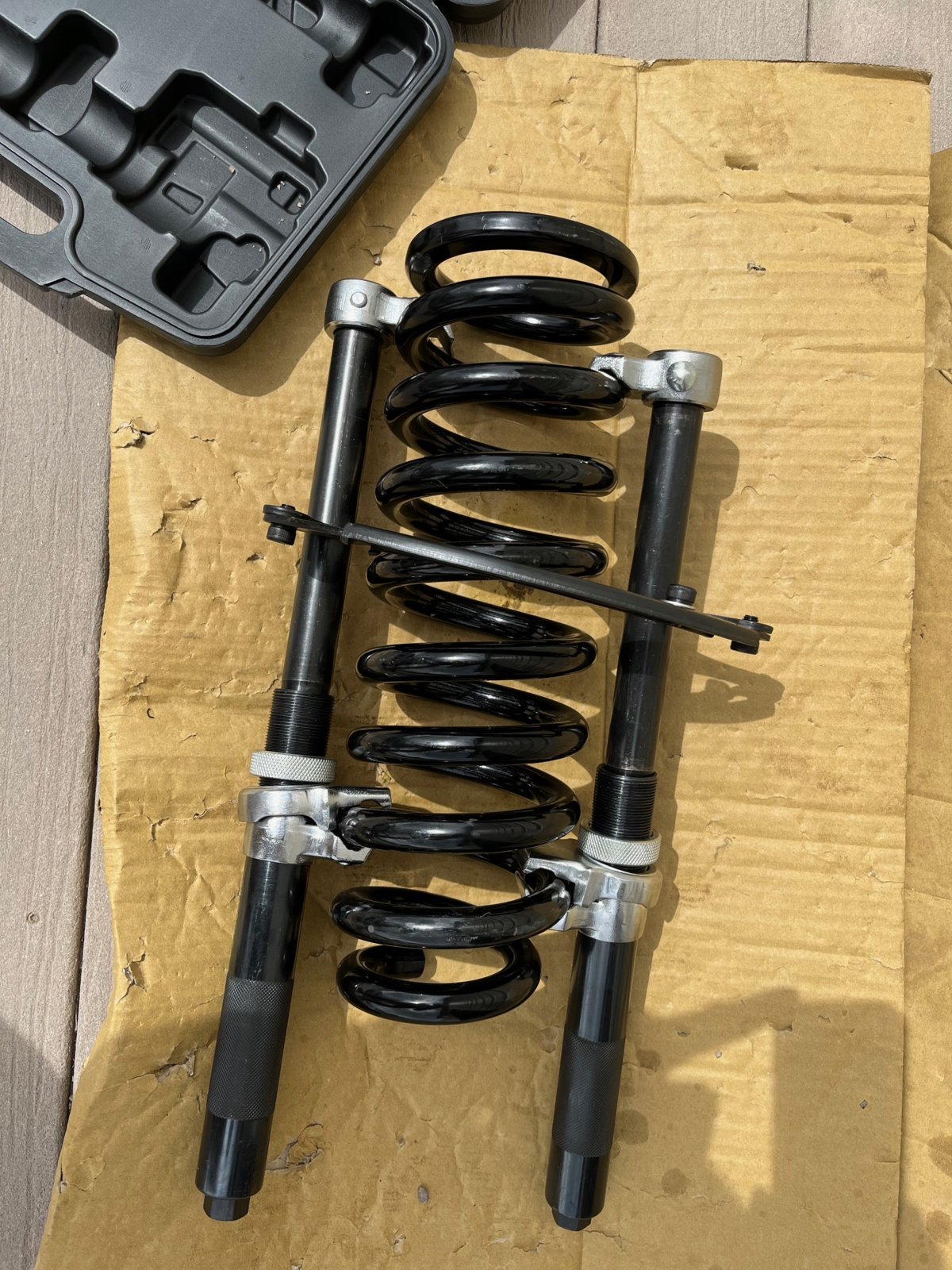

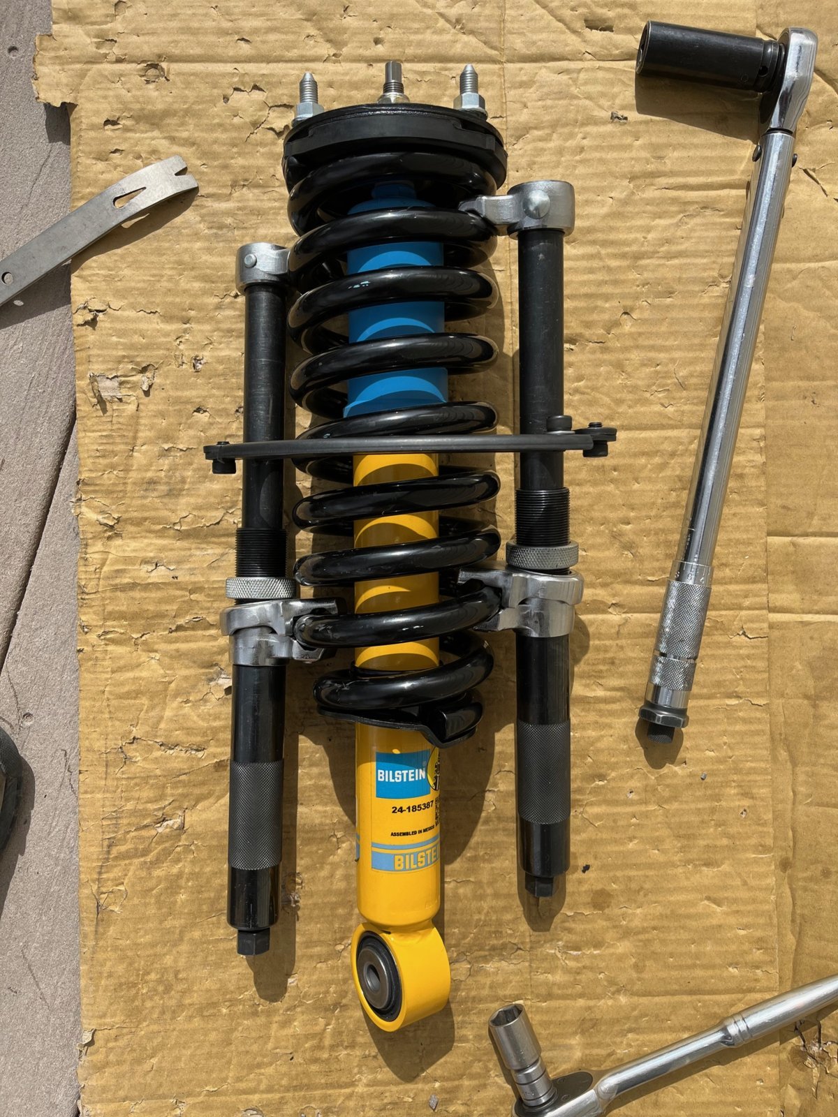

    Yeah, thanks. I was careful there since I didn't want to have to add any. I lost probably 1/4 cup. Refilled and bled the coolant system at lunch. Haven't taken it for a drive so we'll see if I got all the air out. This is one time it helps to have an uneven parking area. Easy to get the front end elevated.
    Assuming I got the orientation right, I'm ready for the front suspension install. But worst case, it's a lot easier (and safer) to just compress the coils a little and rotate the shock now that they're in there with the top bolt secure. I realized after reading a few tutorials that there's no point struggling with the fronts right now...why not just wait till this weekend when I do the UBJs?? Then I'll have all the room I need between the control arms. So I'll wait till then to swap these in, even though I've got some momentum.

    I just want to applaud you here for using a proper spring compressor. Your teeth and skull are silently thankful.

    I've used the other kind! Didn't like it. Figured even if I only do this job once or twice more, the cost was worth it. I did a little searching around and while this is still far less safe than the real spring compressors, it did seem better than the rentals.

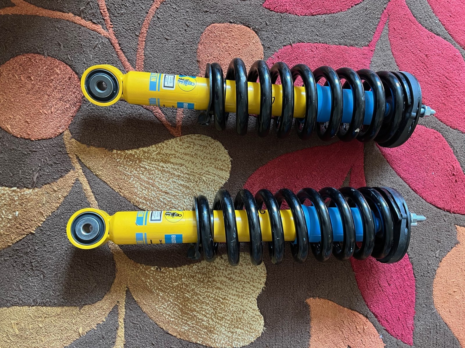

    I'm usually pretty skeptical when things say "custom fit" for a 22 year old truck. But in this case, custom fit!
