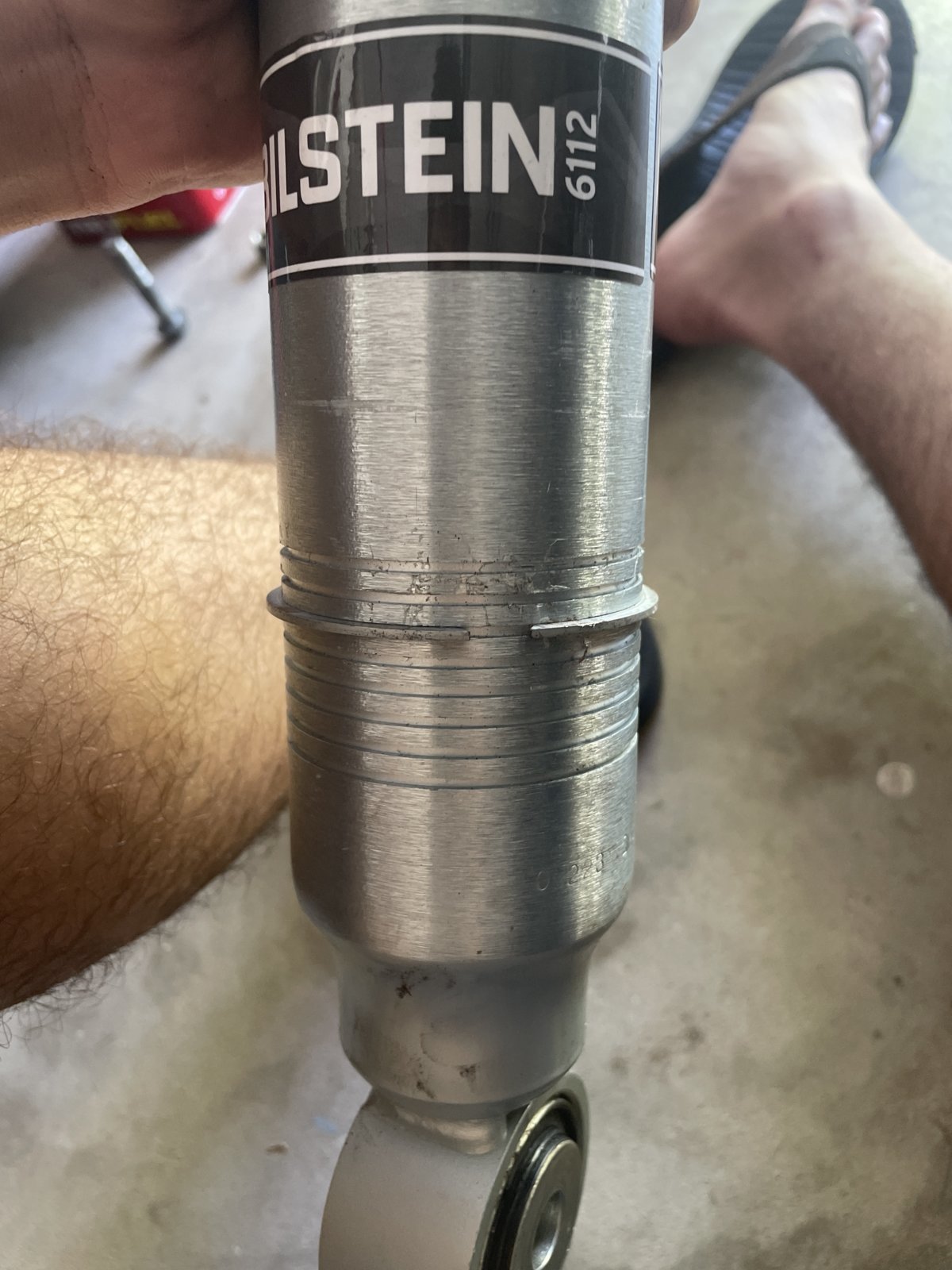

    It sounds like, with the 5100s and 6112s, the most difficult part is popping off the circlips to drop them to another setting, without deforming the circlip.

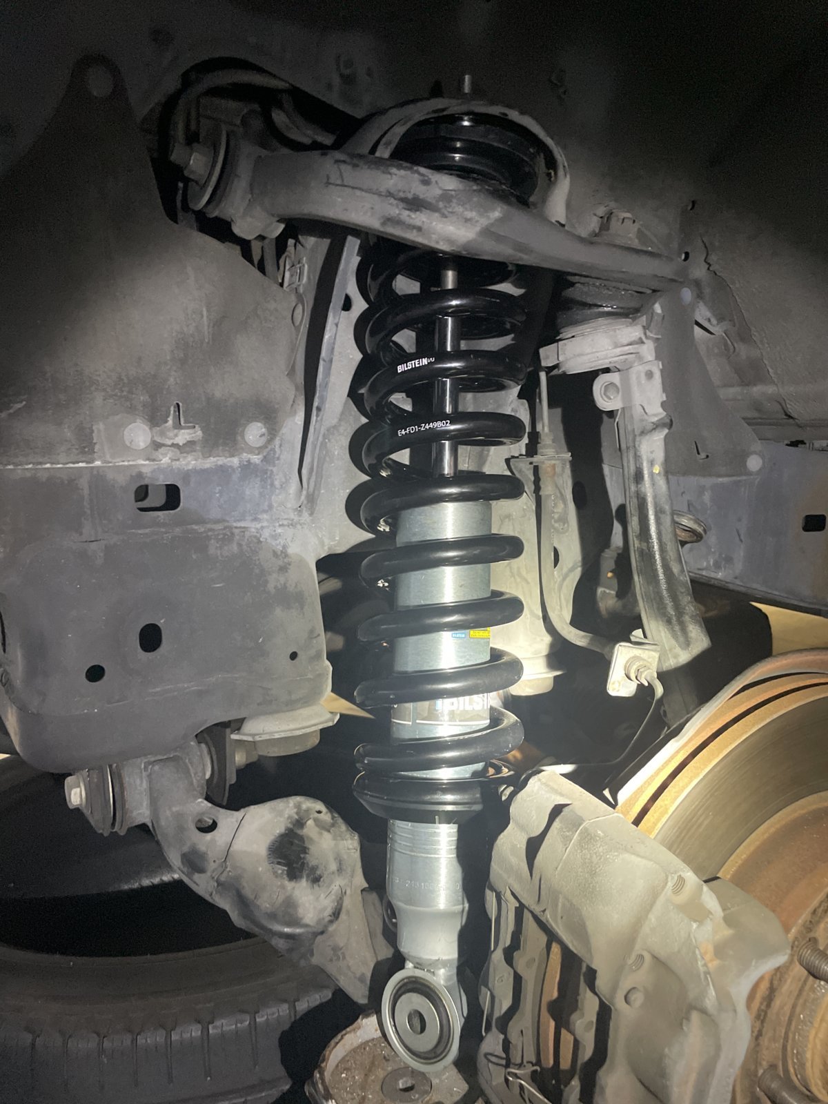

    Moving the both cutout points to their desired grove and the rest of the ring with a pair of pliers made it easy :)
    And an unfortunate casualty:
    Im going to go for 6/4 and see how things look. Job so far has been pretty easy so worst case scenario I just move up. Time for the passenger side!

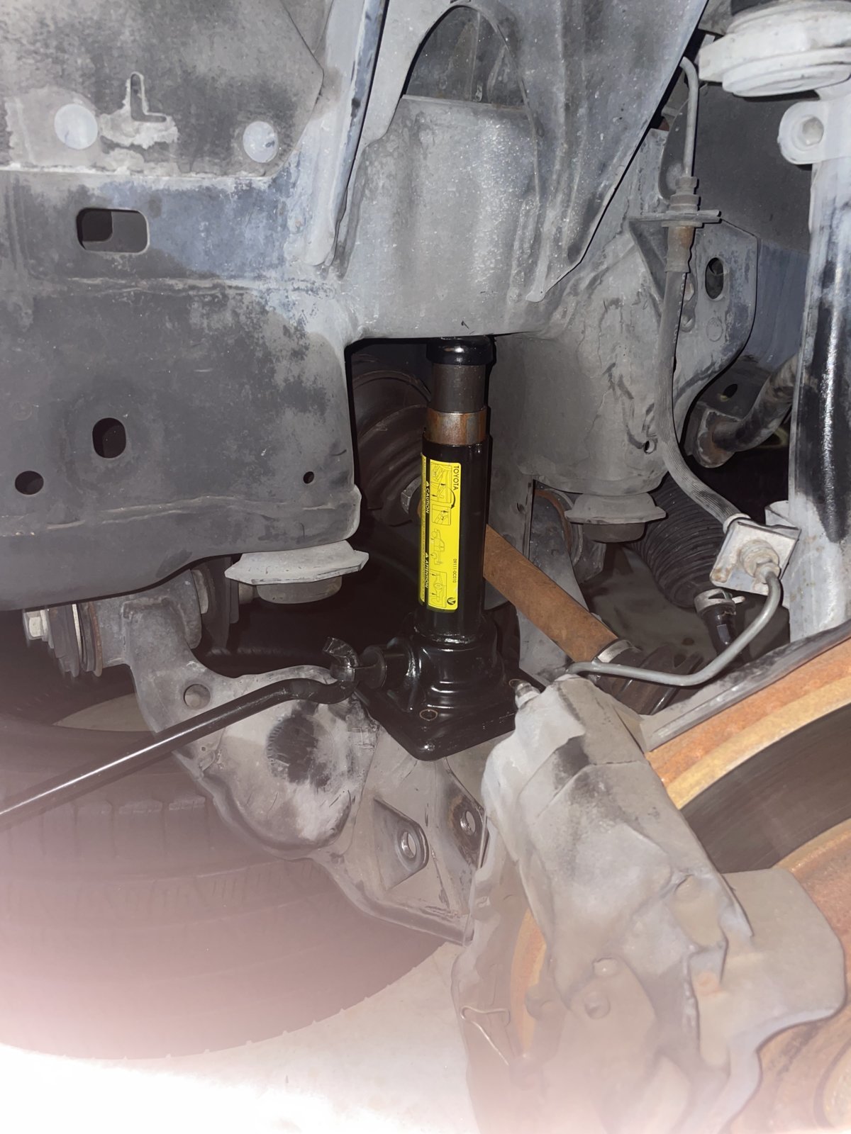

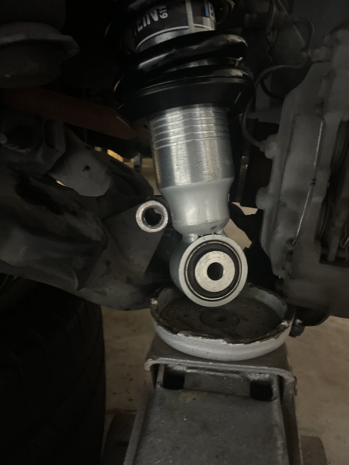

    So decompression was super easy, both are ready to be compressed again, but the guy in the video picked shorter springs and his struts had enough clearance to slide back into place, bolt into the lower control arm, and jack back up to compress the spring. I don’t have enough clearance.
    Anyone got bright ideas for moving the lower control arm down more to gain some clearance to get the bottom strut bolt into place?

    Have seen some use a bottle jack to push UCA arm down but haven't done that myself. Could get some loaner spring compressors. I got 2 pairs and used 3 / shock instead of 2 to compressor the stock coils off the truck (less load on each but tricky to get placement). Even with struts fully assembled it took a bit of maneuvering the LCA to get the lower shock mount aligned to insert the bolt with sway bar detached but alignment cams not loosened.

    Ok, I see the swaybar links are out, so that's a plus.
    I was able to muscle down the LCA with a leg while I slid the shock into place. I do not, cannot, will not ever recommend putting a jack under a shock. Assuming the top bolt of the shock is spun down to where it was when you pulled it off, there should be ample room to slide in the shock if you force the LCA downward. It may take some muscle but it should be do-able. It may be wise to pre-spin your shock end (eye end) to line up proper ahead of time. Or phone a friend.

    Came across the same guy who did it again on a Tundra, BOTTLE JACK W

    Yup, effectively the same thing, but without using your massive quads. :rofl:
    All those years of skateboarding early in life paid off when I was doing my suspension. I'd probably throw a 1x4 or plate of steel between the end of botle jack and frame to spread the force being applied.
  21. Aug 11, 2024 at 2:42 PM

    PS - just make sure you don't do anything that would prevent you from getting the jack back out again!!! :rofl:

    I feel high so happy I got this shit to work :rofl: Bottle Jack is out and it’s time to clean up and go to the auto store to grab a new strut bolt

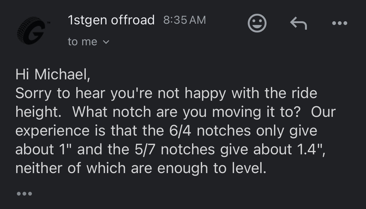

    Got a message back from Josh this morning and I’ll update everything accordingly as I get more info
    I told him that the measuring conventions don’t make a lot of sense, because if stock height is at a 1 inch rake in the front, then I’m getting a 3.25 inch lift at clips 8/6. That’s according to measurements from rear to front, but my rear could be sagging some due to old leaf springs and the camper shell, though I don’t see it being a significant load.

    Agan, this is what I warn everyone about: Online vendors often know DC better than our AC or even RC, unless the info is widely established online for AC/RC, they'll rely on what the vendor says or they just assume they're the same as DC in lift, which just isnt the case.
    Think about this realistically:
    • With 5100s, look at the matrix: AC is consistently higher at the same setting
    • With 6112, it makes zero sense, why would the AC be consistently lower, to the tune of 0.3" or more, knowing it's a lighter truck, and completely contrarian to what we've established as true with the 5100? (a strut is a strut is a strut)
    • What Josh is echoing is basically what is in the documentation from Bilstein
    • I argue Bilstein has a fuckup in their documentation and they're actually posting values 1" lower than what they should be
    • Yes, I realize that's a huge mistake to make on their part, but I'm suspecting you're going to be at 2" riding on 6/4 settings, which is the value in their chart for 4WD/AC/V8 plus 1"
    I'm thinking the AC/V8/4WD values should be more like...
    #6/#4 = 2"
    #5/#3 = 1.7"
    #4/#2 = 1.3"
    #3 #1 = 0.8"
    Again, it makes zero sense how the AC trucks would get LESS lift than a DC. This flies in the face of all logic we've seen with any lift kit for these trucks. It HAS TO BE a typo.

    And actually, now I look at it ... The DC and Sequoia are supposed to have more-similar front suspension than the DC has to the AC/RC. Maybe I'm crazy, but look at the disparity, settings of #6/#4 on 6112 gives Sequoia almost double the lift of a DC? And more than double what an AC gets?
    Looking at the 5100 chart, that seems more realistic of a layout to me. All-in-all, I suspect Bilstein's documentation is not correct. It'll be interesting to see where you're at once you drop to #6/#4.

    @ shifty totally agree, thats why I want to eventuslly get my truck on 4 wheel scale, that way we will have better idea how much weight the front suspension supports on different 1st gen configurations. Only other thing I would like to research is dimension of front end suspension componets to verify email from bilstein. But , i agree
    ..most likely ovetsight on their part.

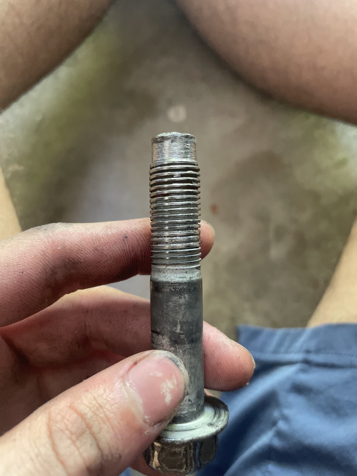

    Does anybody know the specs of the lower shock mount bolt? I found the part number (90105-A0013) but it’s going to arrive after my estimated alignment date (Thursday) so I need to find a suitable replacement in the meantime I can pick up today.
    Should I take it to the Ace Hardware monkeys so they can help me figure it out?

    I would take old one to a Fastenal and get highest grade for temp use only. Do you mean pitch, thread count and dimensions? Let me try to find it for ya.

    Doesn’t really matter as long as it provides a decent enough fit in the meantime, I’ll order a replacement part and swap it out when all is said and done.
    Take a look at the part number (90105-A0013)
