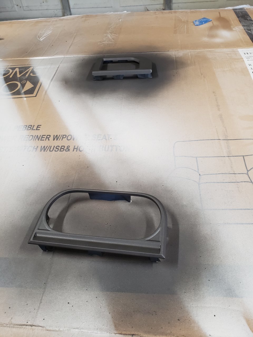

    I have used the SEM on chrome and the light silver trim pieces and its been great. I used their Charcoal Metallic because I didn't want black.

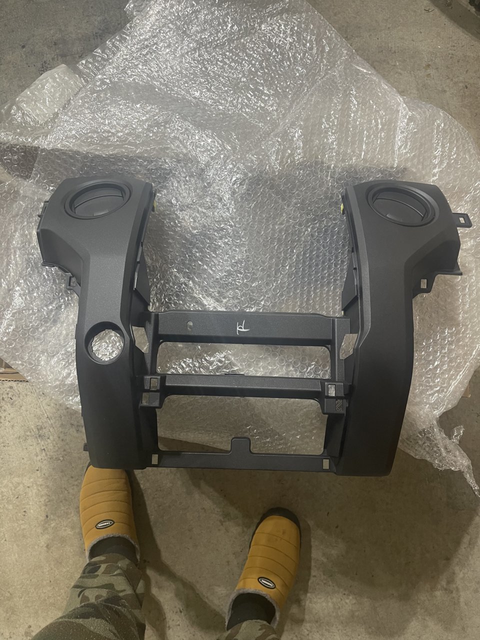

    Those 2 panels beside the radio is one part.:thumbsup:
    55405-0C010-C1 - Center Panel - 2014-2020 Toyota Tundra | Sparks Parts
    You pretty much have to take the entire dash apart to get it out.
    Don't ask me how I know, found in another thread...
    There are some threads on some guys painting it, and other guys replacing it with the black SR part.
    Be warned there are 4 different parts.
    2 black, 1 2WD and 1 4WD.
    2 silver, 1 2WD and 1 4WD.
    Part #4
    Instrument Panel Components for 2016 Toyota Tundra | Sparks Parts

    holy smokes... it looks beautiful. I might see if painting is an option before I commit to taking the dash apart. Thanks for sharing those pics

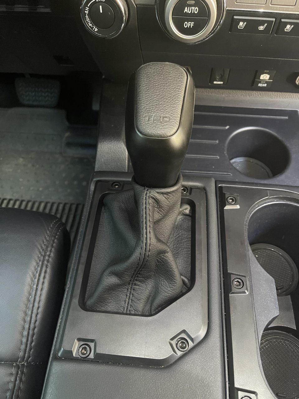

    AJT trim, replaced the radio surround with black oem piece and added black TRD knob with black leather boot.

    @reywcms where did you source the leather boot?

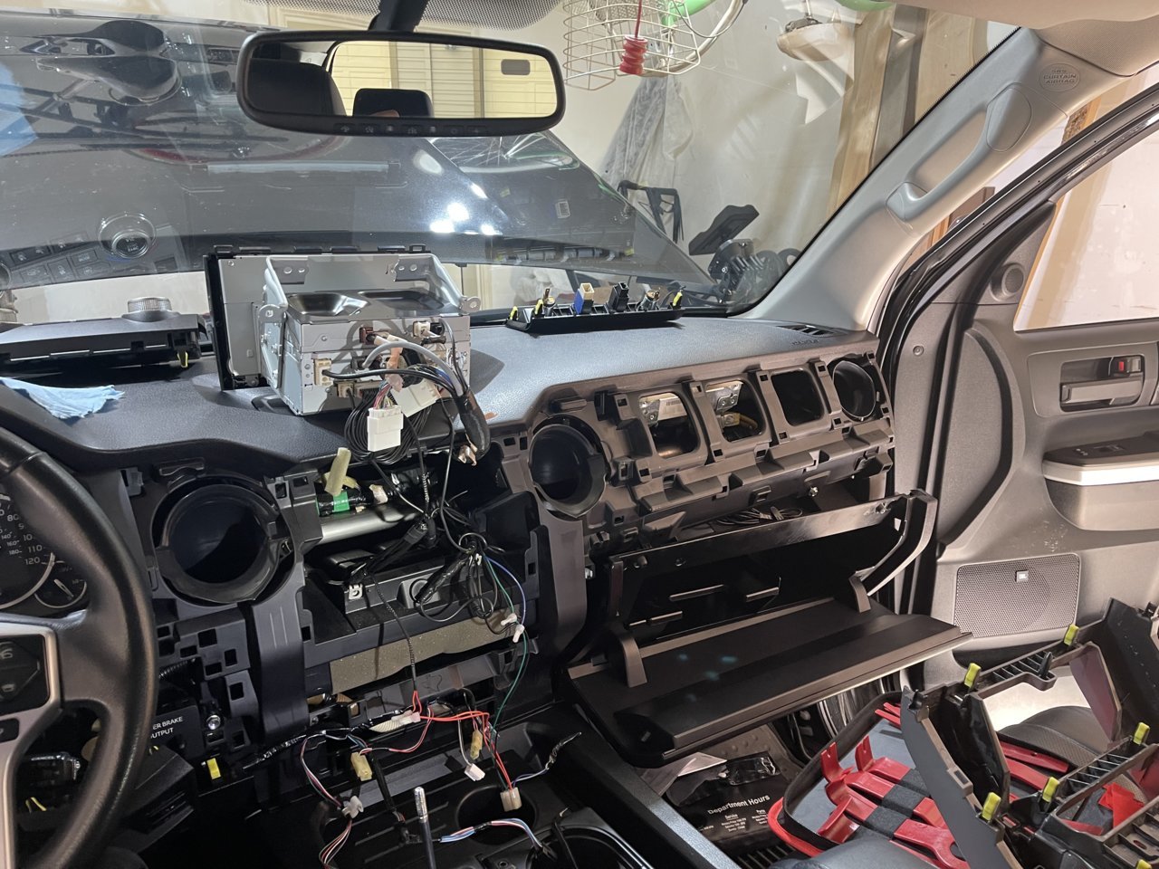

    Hey, I am going to do the radio surround instal this week, had the piece for a bit. Are there any link or photos on how to do it, removing only the needed areas? I did a search and it's led me here.
    Edit: Oh wow, saw the video, looks like the entire thing needs to come off to do this center piece. While I am doing this, what other trim pieces should be bought to just nail it all at once? I don't want to do it twice.

    Which video did you see? The one that @2020Platinum made is the one that I would use.

    Yes that was the one. He did a great job on that, but it also let me know I've got to take the whole thing apart ha. Ordering vent rings and 4x4 replacement from meso. I already did the shifter area.
