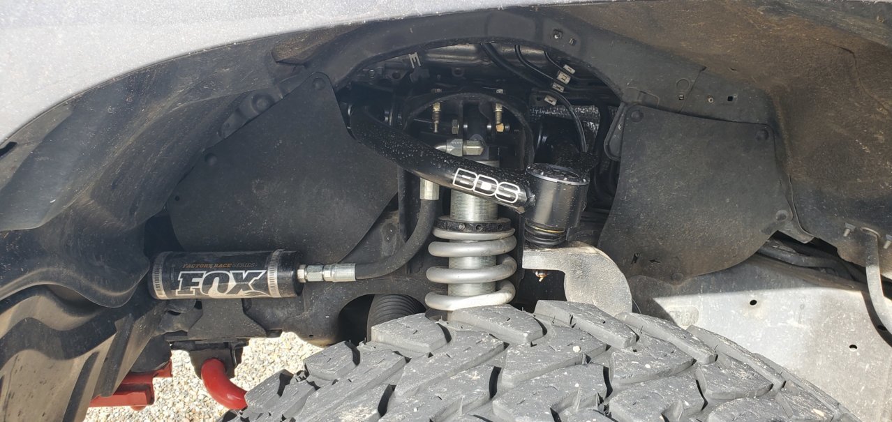

    Had to much lift on the front had some reverse rake going on so took out the Coachbuilder shims. Put the bds ucas back on since those aligned fine at this height and sold the icons

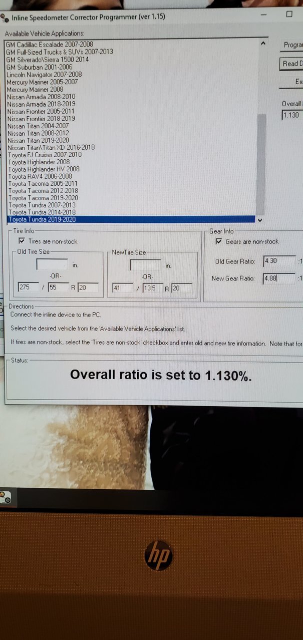

    Installed hypertech speedometer calibrator.
    Few issues.
    I was told when they released the 2019 programmer I would be contacted. They never did. No big deal checked regularly..
    And to get my speedometer correct I had to punch in 41 inch tires and I have 38s.. took me a day of trial and error to get it dialed but now I'm spot on.

    AFE cold air intake, Outlaw Catback Dual Exhaust, ProRunner Fender Flares, DAPTISED 37x12.5x20’s, (soon to be 38x13.5x17) Zone 5 bracket lift kit /with pro comp spindles and outer tie rods grip pro lsd rear, Revolution 5.29 gears Deaver U748 springs Camburg shackles Fox 2.5 Coilovers 7” BDS Icon Billet adj/UCA’s
    So I have basically same set up at you and wanting new UCA’s dit the bds finally work out for you the best for alignment issues?

    Yea the bds ended up working in the long run shoulda gone with them first
