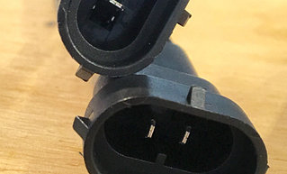

    I picked up a new bumper that came pre assembled with 18w led cubes on each side and a little 20" led light bar in the middle. All three lights did not come with any connectors or plugs, just pigtails basically. As far as the cubes go I want to connect them to the old stock fog light harness and I found these connectors. Any input on weather these will work with my stock foglights?

    Thanks for the link they have some great products but I didnt see anything to wire up to the cubes I have. Everything on his site is for cubes that already have a socket to plug into. I see the harness he offers also but I want to work around that harness by soldering the plugs I found on Amazon. Just checking for fitment if anyone could tell me if those look right to be able to plug directly into my stock foglight wiring. I removed the bumper with foglights and replaced with the new bumper, its just that all the lights came with bare wire and no plugs.

    Ah I see what you're doing now. Yes, those adapters from Amazon would work for that.

    The H11s you have posted in the Amazon link are what I used in my 2014.
    I also used them back when I made and sold Rigid adapters..

    I think when I used to make those adapters, black was hot and red was ground when plugged into the truck.
    I do know on both plugs from the truck, the ground was a white w/black stripe wire.
    Left light hot was light blue, right was pink.
    That was on my 2014.
    Hopefully you just blew the fuse.
