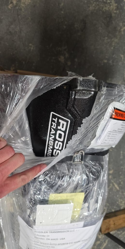

    Holy cow! Nice write up to start this off, great job! Only thing I can think of off the top of my head is your cooling place holder.. is that a specific cooling or any and all cooling recommendations? I have bought the older version of the @Genuine Cooling Systems trans cooler that PS said they'll make work with the 4l80e trans. I know he's already been a vendor in here I do believe. I'm on a true flex fuel sensor that's working with the Motec just like the 900 turbo build truck that PS built, so ya e85 or 93 or any combination. I'll also be upgrading from the M130 to the M150 as well for more control of everything.
    Details for the Terminator 5 or T-5 from Rossler as you asked, http://www.rosslertrans.com/4l80e.html believe it or not it was south of 10k. This does not including labor to install or the custom work like the PS adapters and flex plate, trans mount and differential mount, modifying the driveshaft. Also went with an early 2000's transfer case from a Cadillac Escalade as other forums guys are using those for decent power from 1k-1200 no issues. I'd be planning to save 20k roughly in the savings jar to go this route including cost of the trans.
    Specs from the trans:
    • 4L80E T5 HIGH PERFORMANCE:
      • Reprogram valve body (Ross/Lock™).
      • Modify pump TCC apply system to increase load capacity on the converter clutch apply.
      • Overhaul complete transmission, set to HD specs.
      • Add extra clutch/direct clutch drum.
      • Install special extra-wide bushing/pump stator.
      • Install HD (no walk bushing) rear case.
      • Install rear case retainer and bearing kit to prevent rear case thrust washer failure.
      • HD rear band.
      • HD intermediate band.
      • 2 shift solenoids.
      • New PSI force motor.
      • Turbine in, turbine out switches.
      • New internal wiring harness.
    • M300 BILLET INPUT SHAFT.
    • Billet forward clutch hub.
    • Billet aluminum high gear drum.
    • Special oversized 36-element sprag Pro Mod sprag kit.
    • XHD billet M300 intermediate shaft for 4x4.
    • Cast Aluminum Pan
    • Dyno tested.
    • Made in the USA.
    This will have a CIRCLE D PROSPEED SPEC PRO SERIES MULTI DISK LOCK UP 4L80 TORQUE CONVERTER (ALLOWS LOCK UP UNDER POWER FOR INCREASED MPH/ET) I'd think a 2,800 to 3,400 stall would be good since it's stock cams and gears, but I'll double check on that.
    For the turbo, I had my eyes on a FORCED PERFORMANCE HD8082 TURBOCHARGER - T4. Comparable to a Precision 7675/7875.
    Flow: 80mm compressor, 82mm turbine supports ~1,200+ hp depending on fueling/boost.
    Turbine housing: T4, 1.00 A/R
    Reminder the blocks fully built and now sleeved up with Darton MID sleeves to handle all the jam.
